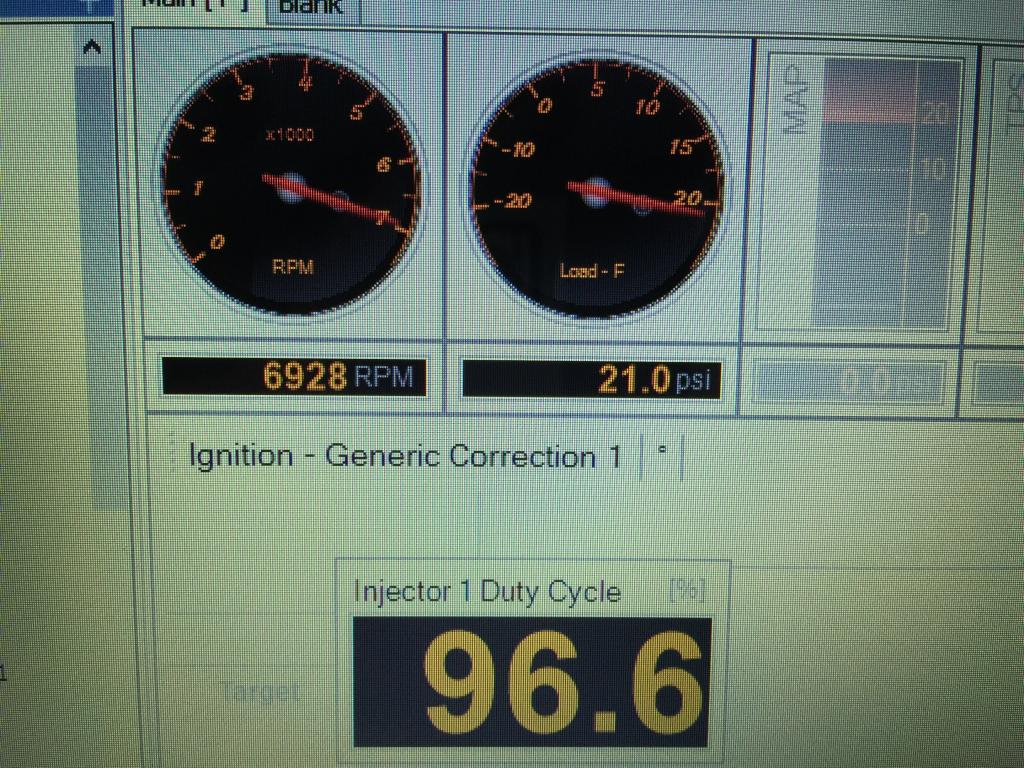

Getting closer to tune time. Still haven't received my bigger cog yet. I called them Friday and they promised I would have it by Wednesday. Tune is on Thursday. Did a little logging and I seen that I hit 96% injector duty cycle.. So now I'm in the market for some bigger injectors. I'm looking at injector Dynamics 1300cc And DW 1500s.. Calling dynosty tomorrow to see what they wanna do and if they had anything in stock.

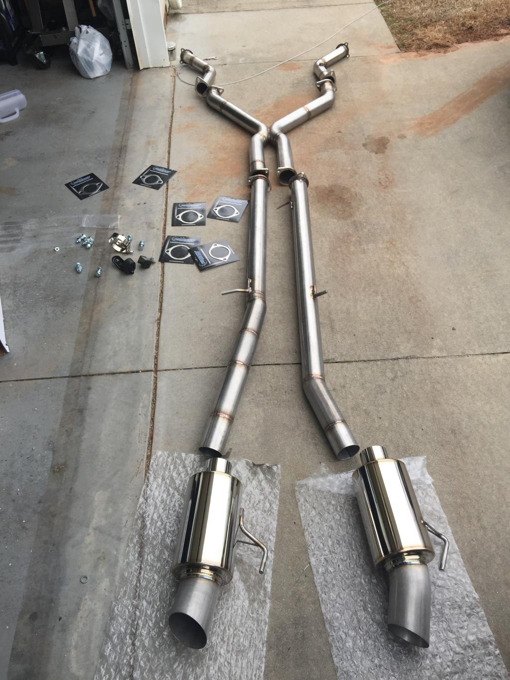

In other news, I picked up my new exhaust today! Soho motorsports dual 3" with x, and test pipes.

Damn looks good, ill bet that thing is going to sound like a meanz!

Alotta exhaust, looks like it will be loud

Nice Exhaust, what did that set you back?

I have a thread In the exhaust section. I don't want to say what I paid, but I got a huge discount at being the 2nd z to have this exhaust. It is mean as hell sounding. It's loud and has a completely different sound that I like compared to my tomei set up.

I hit 21-22 psi currently. My idc hit 96%. I just don't want to get there and not have enough fuel.

Looks like you have plenty of fuel pump, ya you might need larger injectors......
What is your FP set at?
