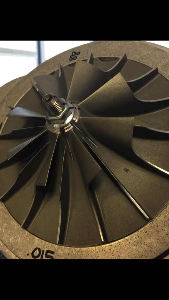

Here is a better pic

Weird but they must serve a purpose.
Maybe for balancing?
That makes sense, since they aren't all the same size.

yes, every turbine/compressor wheel must be high speed balanced. instead of adding weight like on your car wheel, they most of the time remove
