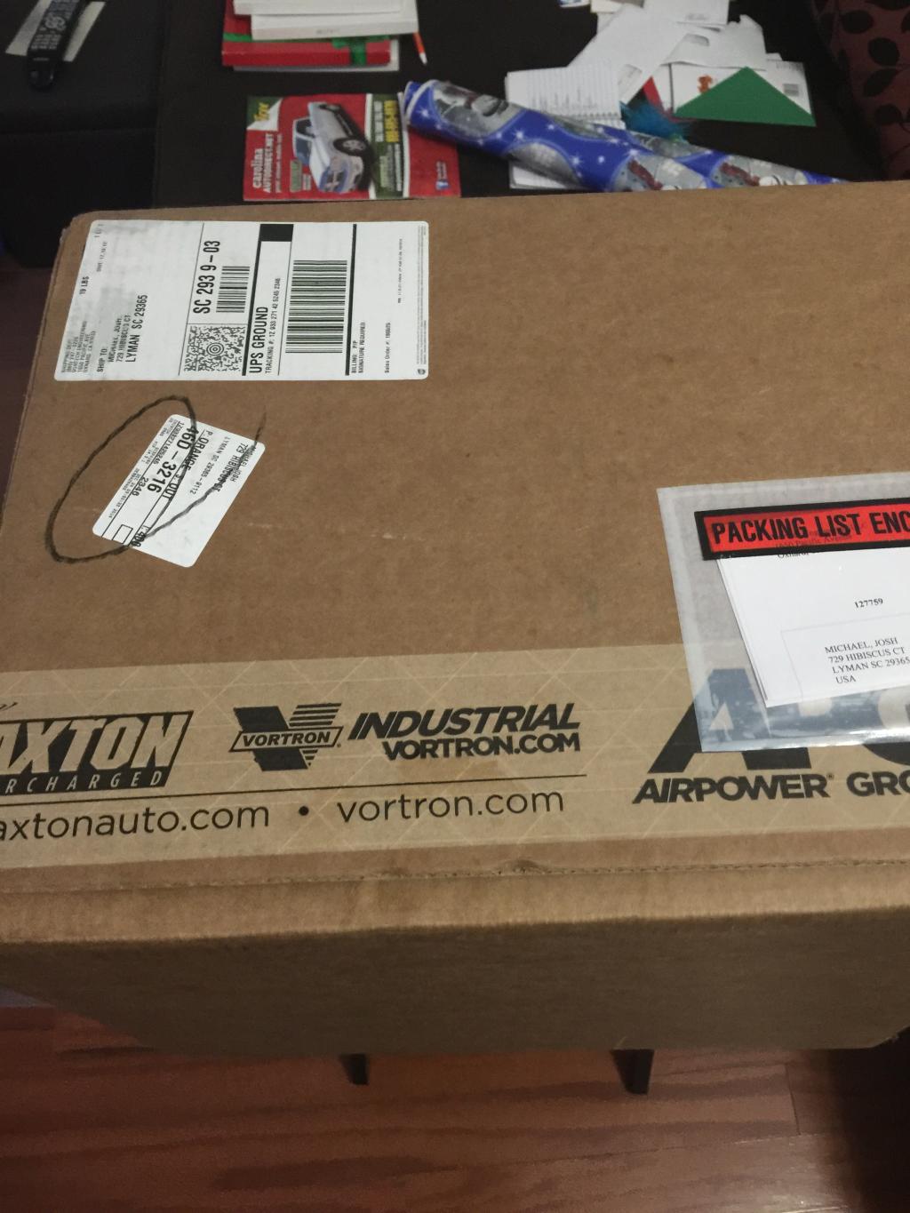

Got a present on Christmas eve..
Old Dec 24, 2014 | 04:08 PM
  #251
meanz's Avatar
meanz
Joined: Jan 2010
Posts: 2,197
Likes: 57
From: greenville, sc
I've driven it around a little, I hit 16psi at 6k so far.
