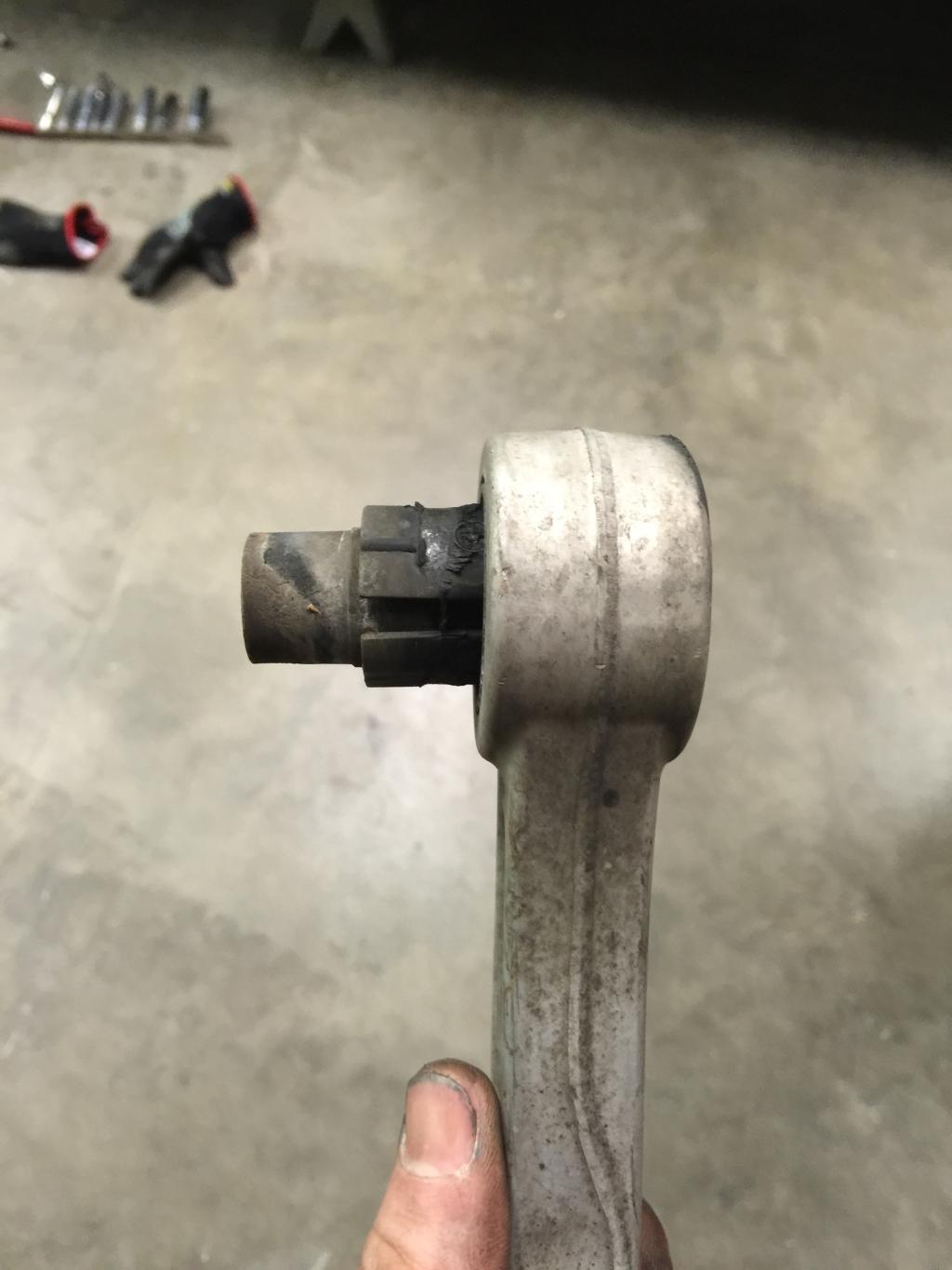

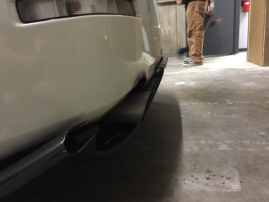

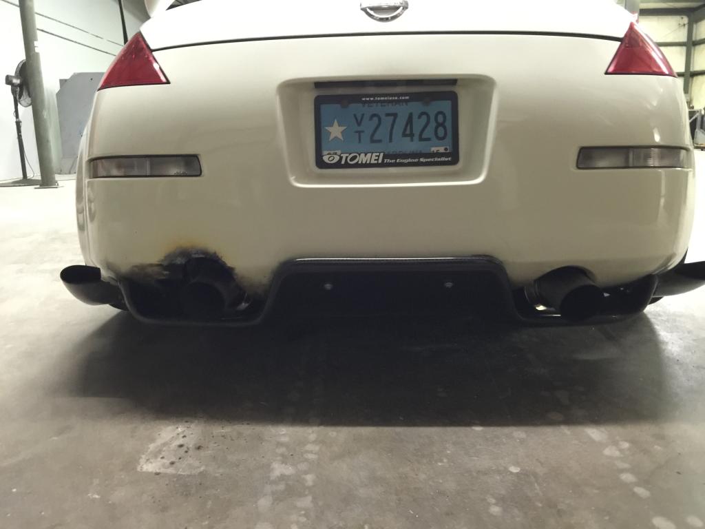

Sorry guys, I was busy after work changing my lower control arm bushings. One was completely shot. Still have a clunk somewhere that I'm trying to track down. I took a couple pics after getting your notification old man, but they are kinda shitty. I promise I'll take some tomorrow when it's daylight still.
Don't let my shitty flame toasted bumper ruin the look for you guys. It fits great and is even on both sides. I need to do something about the bumper soon. My tomei kept my rear on fire pretty much.
Also as far as the price with out the test pipes, we never discussed it. I found out they were gonna start building this exhaust and i told them I wanted it. I asked about the test pipes and I was told they were included in my price. Which kinda surprised me because I got hooked up.

you check the lower control arm busing that connects to the front subframe? That one tends to fail with the control arm pulling off the bushing.
Swaybar night and tight??

Yes, we replaced both bushings on the lca. I've went through and re tightened everything so many times tying to find something loose. The sway bars are tight, but I might remove them to see if that's where the clunk is. I also have bushings for the compression arms that need to get done.
