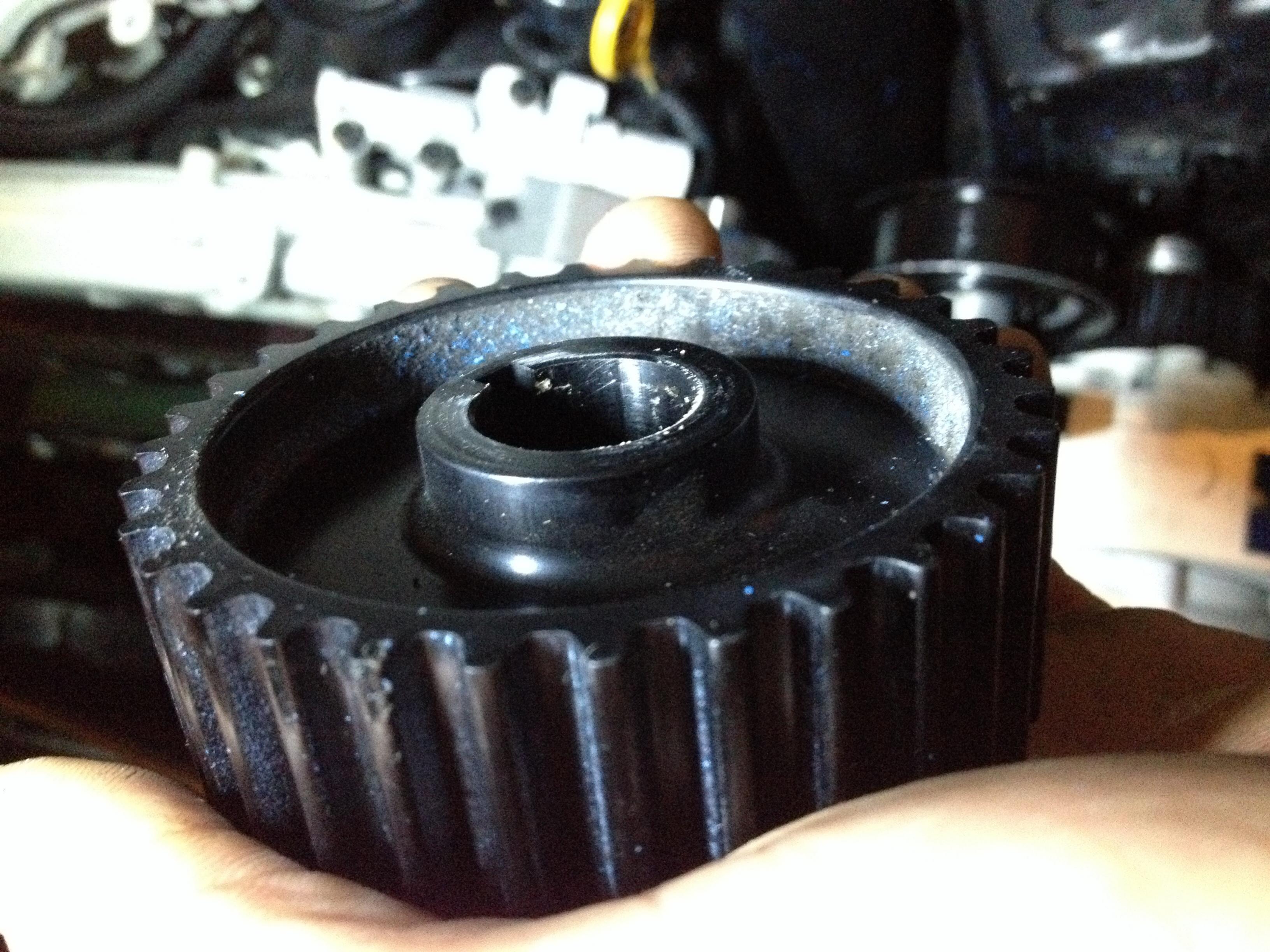

Ran into a small problem with my cog belt setup. Belt is over the edge by maybe a couple mills. Seems just enough to shred belts. I put new belt on last night and did some pulls. Can see on the inside of belt where it's tearing up. Going to the shop on Friday to see what's going on . As far as I can see, everything is still tight. Prolly have to mill down the cog pulley on the inside to get the cog over more.

This is the side we're thinking about milling down. The idler pulley and the cog on supercharger look to be lined up perfect. When pulling the cog off it was still tight as hell. Had lock tight on it.

DO NOT Mill anything.........
All you need to do is space out the Idler Pulley with a washer or two, so that you get all of the belt on both cogs....

here is a pic, see the washer at the base of the Idler Spacer.
Look at the belt on the jackshaft cog, it's offset. and on the blower cog it's offset the other direction. Because of the Vortech Design, you can not get the belts centered.

I'm gonna try some things tonight since I don't work tomorrow and see how it goes. I will see how spacing the idler out does when i get off work.

Oldman, just noticed the picture you posted. I had checked your post on my phone, thanks for the picture. Ive added the washer like yours the other night. Been beating the crap out of it every chance I get. Been doing a lot of 1-3 pulls and so far, fingers crossed, think I have it. No unusual wear on the belts. Car is pulling really hard, loving this weather.
