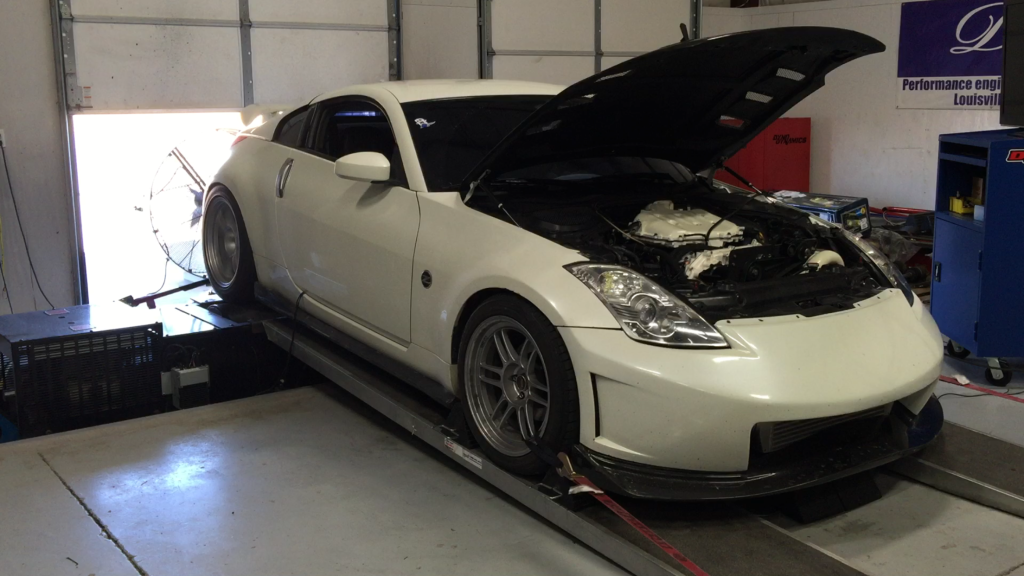

We are here at dynosty. Hal has been tuning on the z for a while now. Picked up 30hp over baseline on old tune. Most of the gains are above 5500rpms. Seeing some belt slip. Only hitting 20-21psi with this new cog. Numbers are low compared to what I dynoed on before at Cin. He did say that my numbers are kinda unheard of on his dyno with a blower. No final numbers yet, we all took lunch.

Went from 502 baseline to 565 when finished. Little under 6500rpms @20psi. I am seeing slip obviously. Gonna try to cure this on my own this week. Gonna redyno on cins so I can get an accurate reading of my gains from the SI blower to this t trim.

Ya, at the 20psi the bracket is flexing. And Yes you should be able to see it flex under load. It's does not take much to cause belt slip.
When Driving how does the car feel compared to before?
Got a pic of the dyno? that will help.

It is hard to see because the camera is moving.
But it flexes toward the front of the car.
It does not take much at all to get less tension on the belt and ten get belt slip.
When it flexes forward, it makes the distance shorter and then the belt gets loose.
You MUST have NO Flex at all.....
Let me help you fix it!
