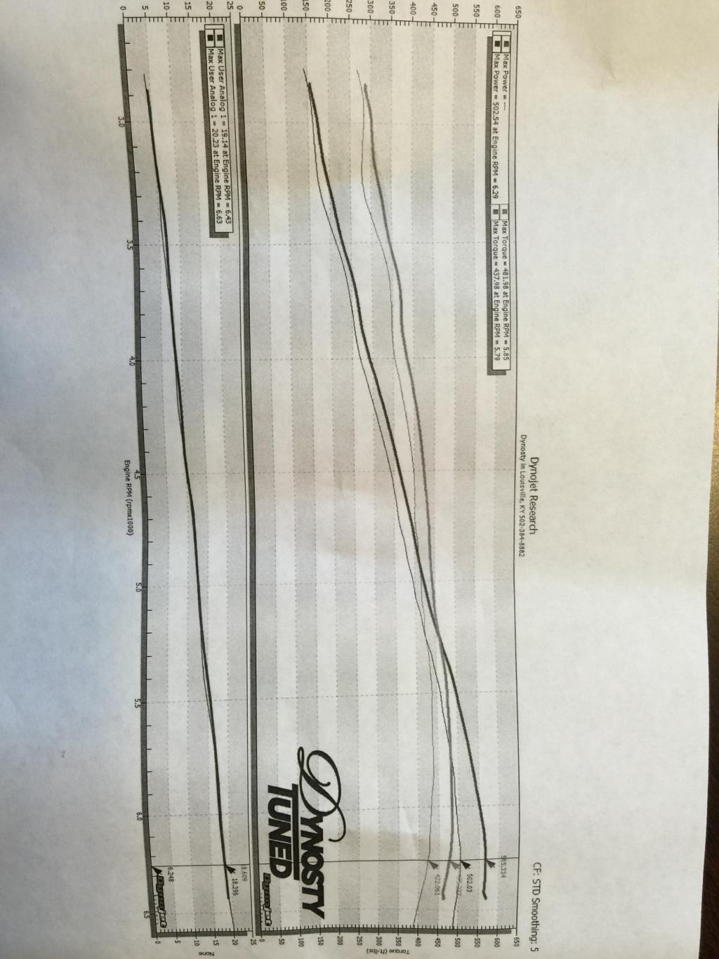

Also the 502hp is where we started with the first pull, max he hit was 568. Also gained a good bit in torque. 437-481

thought they had a Dyno Dynamics and not a dynojet..
time to update your sig!
OVer 60whp gain is a good chunk.
Wonder what hal is doing for the traction control. Ignition retard?

Can you post up the whole Dyno? And the one before the last?
I bought your blower is out of steam.
On my stock motor I'm making power to 6800rpm and TQ over 6000rpm.
Your power is falling off @ 6350rpm....

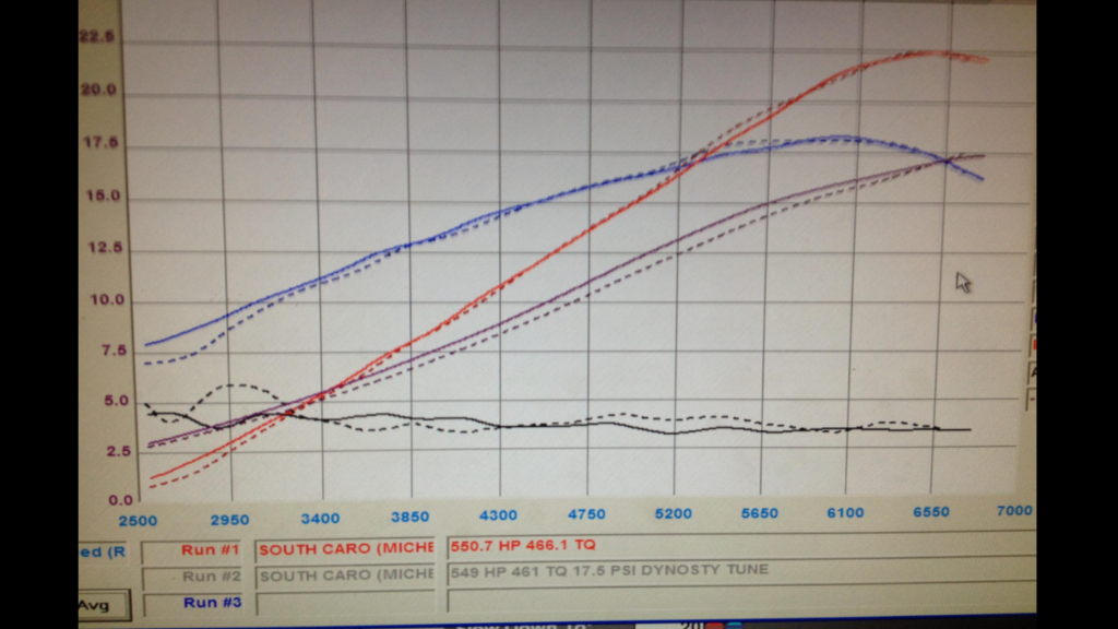

Different dynos and different blowers, power still falls off about the same place

Does this mean I'm maxing out the blower efficiency?

NO! Your car runs well, just there is a lot left on the table.
IMO
#1 Issue is belt slip problems. HP should not be falling off @ 6350rpm. With the C2 cams IMO it should make power to over 7000rpm.
#2. May be Intercooler. This may be hold holding you back some. You can't cheap out here. Tons of power is to be made or lost here. I don't know the Spec of what you have now.
Don't get focused on Boost to much. Monitoring PSi is more for Diagnosis. Motor wise Hp & TQ thrught-out the RPM is what matters. Making that power is a result of how much AIR you cram into the, and how easy you can get it out. Keeping the AIR as Cold as possible means you can cram more Air in and make more power.
For every 5.5f degrees you raise the Intake Temp, you Loose 1% Power & TQ.......
That means if you are in the 500whp range and you have lower the ATI's 27.5f degrees you just gained 5% HP & TQ thru out the RPM Range. At max power, that's a 25whp gain, and if you don't, you are leaving that on the table, not to be had. Think about it
For compairison, my ATI's are 8-10f degrees above Ambiant on a full hard run. Note this must be logged, as ATI's will be all over the place. It's can go way up when you get out of the throttle or just cruising around town. The temps that matter are under full load, boost and rpm (hard driving).

If you put a smaller pulley it will just start slipping sooner or run out of efficiency sooner.
Your impeller calculations were what again for that pulley? If you take the time to calculate impeller speeds at the point where it drops off and can log IAT against that, you can start to tell if the blower is dropping off etc.

If I'm not slipping, it's spinning up to 65k. Blower is rated to 58 I believe. Power starts dropping at 6350rpms give or take. That puts the blower right at 59k. So there it is.. Out of it's range and it starts to drop..

Yeah either you're slipping like fawk at that speed or you're loosing efficiency. TBH I'd bet it's a bit of both, but to me the power drops like you're running out of efficiency more so than slip.
I'm assuming you're tuned on Volumetric Efficiency? Look up how to data log your intake temperature sensor on the haltech. Then go do a few pulls. Post up either screenshots or what you saw.
Also a lot of these people are trying to compare dyno numbers. Dyno is a tool for measuring changes on a given day, and for ease of tuning. Comparing two different cars on two different dyno's is a crap shoot. Especially dynosty's dyno which is well known for reading quite low. That 700whp YSI car would be pretty close to 600whp on the dynosty dyno I bet. Possibly even lower.
Ultimately yeah you probably are slipping some, but the IAT temp is what's going to tell you what's causing that power curve beyond the psi curve.
If you're heating up at that point there are a few things you can do to help make more power. Bigger IC piping, bigger FMIC will both reduce intake speed, and reduce pressure loss. Both of these will decrease intake temps. Easier than that is just adding some water meth. That would probably get you more gains for less money and work. But first I'd get that belt working as best as possible.
My gripe would be the 2.75" piping is pretty much maxed out for the max cfm a Ti could push. That doesn't mean the car can't make power, it just means it would make more with a 3". How much? I don't actually know.

dynosty uses a dynojet. cin;s website says they are on a mustang, which you can setup however you want. Classically a properly setup mustang will read equal to a dynojet if not lower.
If you think Hal left alot on the table, did you talk to him about that?
looks like 40-50* temp increase but it drops immediately after dropping out of boost. i'd like to see Oldmans 8* increase over the same kinda of pull.
could be intercooler but could also be past the supercharger efficiency.
plot your boost vs rpm. that will immediately tell you if you have slip.
