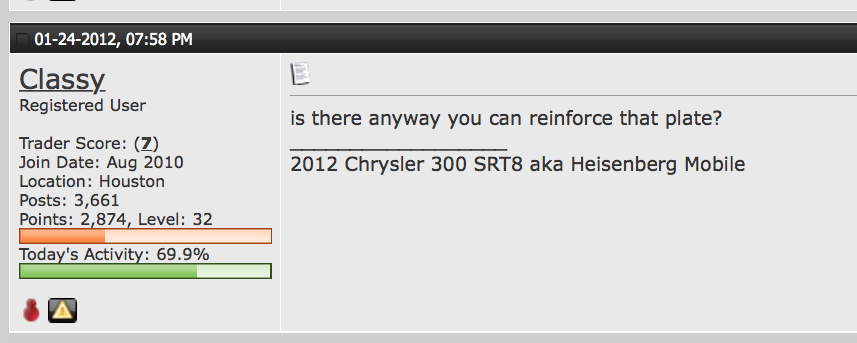

And Ya, Classy here is a pic of your post about making the plate stronger.
Attached Thumbnails Another built motor Vortech dreamer thread.-screen-shot-2015-02-05-at-9.50.03-pm.png

I was not nearly as well informed then (3 years ago) than I am now.
I think alot of your posts oldman have been EXTREMELY biased towards people buying your radius rod, good bad ugly, it doesn't matter, you are kinda forcing it down people's throats. Vendors in my experience who do that generally are kinda shady.

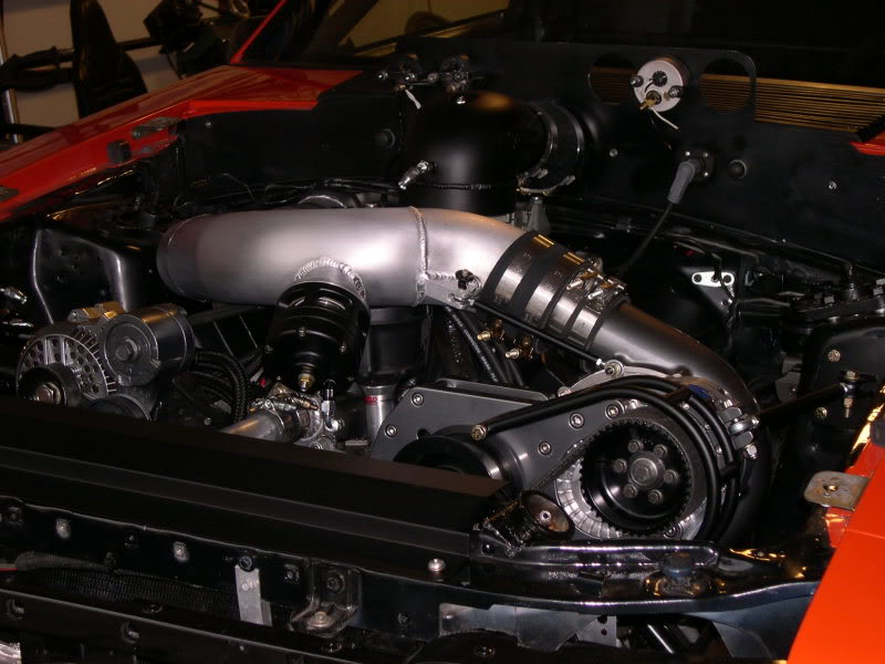

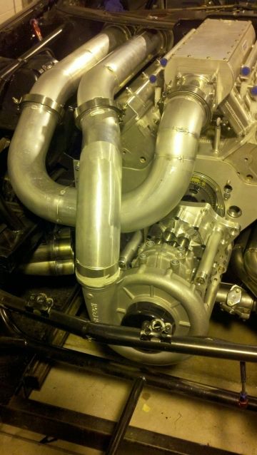

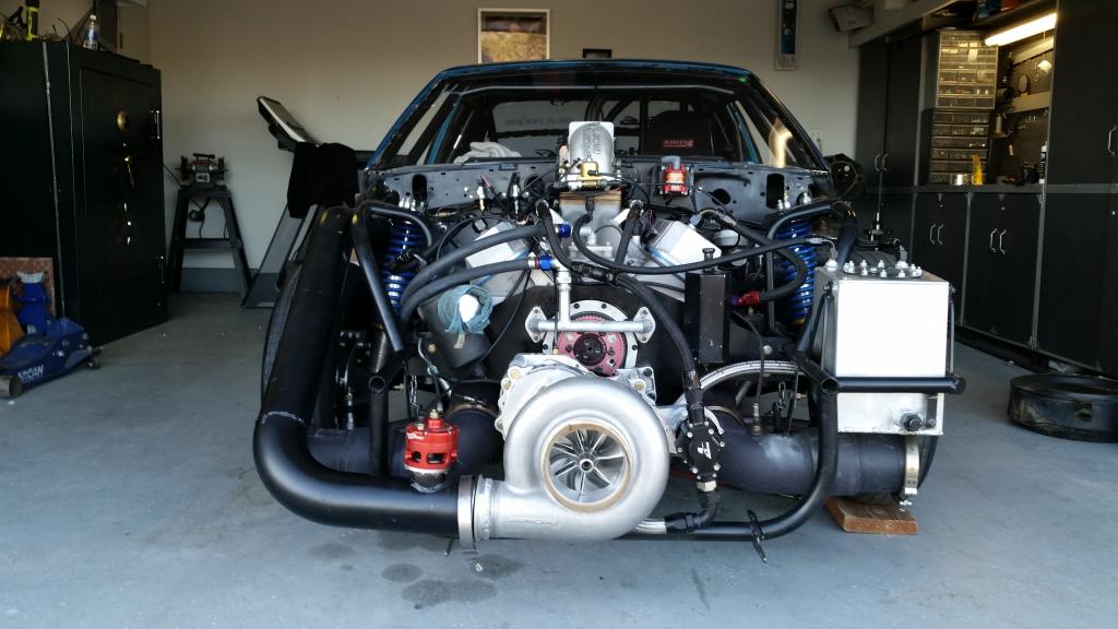

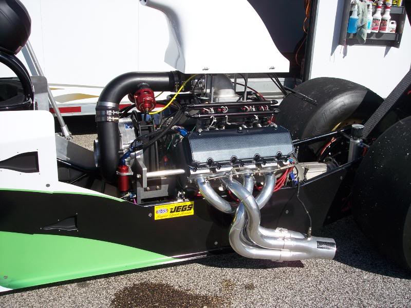

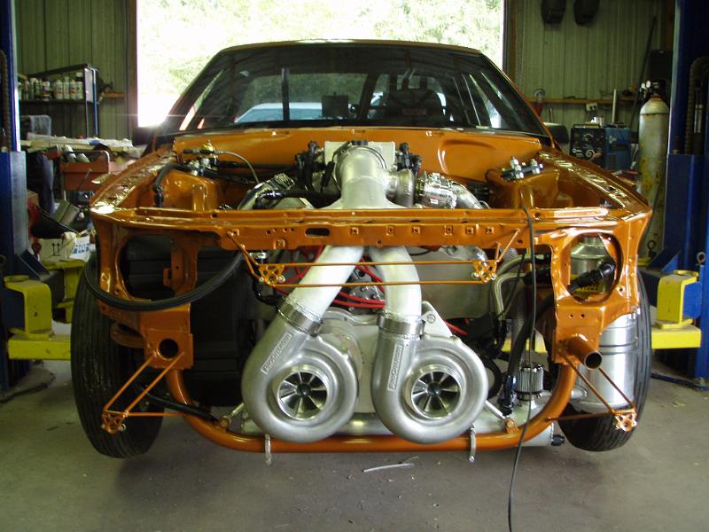

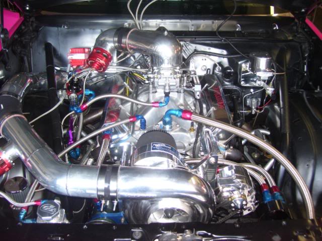

Attached Thumbnails Another built motor Vortech dreamer thread.-306720_10151055439795255_921701333_n.jpg   Another built motor Vortech dreamer thread.-p8260003.jpg   Another built motor Vortech dreamer thread.-20140823_184359_zps0a150e12.jpg

dang what year 350z or G35 are those? because I am sure that we are taking about VQ35's
Old Feb 6, 2015 | 03:24 PM
  #352
Classy's Avatar
Classy
Joined: Aug 2010
Posts: 7,606
Likes: 615
From: Houston
Those are gear driven, like the murder nova was

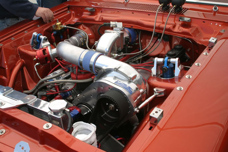

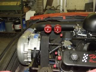

Attached Thumbnails Another built motor Vortech dreamer thread.-rpmmagazinephotoshoot1-27-09002.jpg   Another built motor Vortech dreamer thread.-1.jpg   Another built motor Vortech dreamer thread.-jpfwork026.jpg   Another built motor Vortech dreamer thread.-picsofcars2008033.jpg   Another built motor Vortech dreamer thread.-100_1548.jpg

Oh Look!
What is that mounted to the shock tower and Blower?
Could that be a Radius Rod?

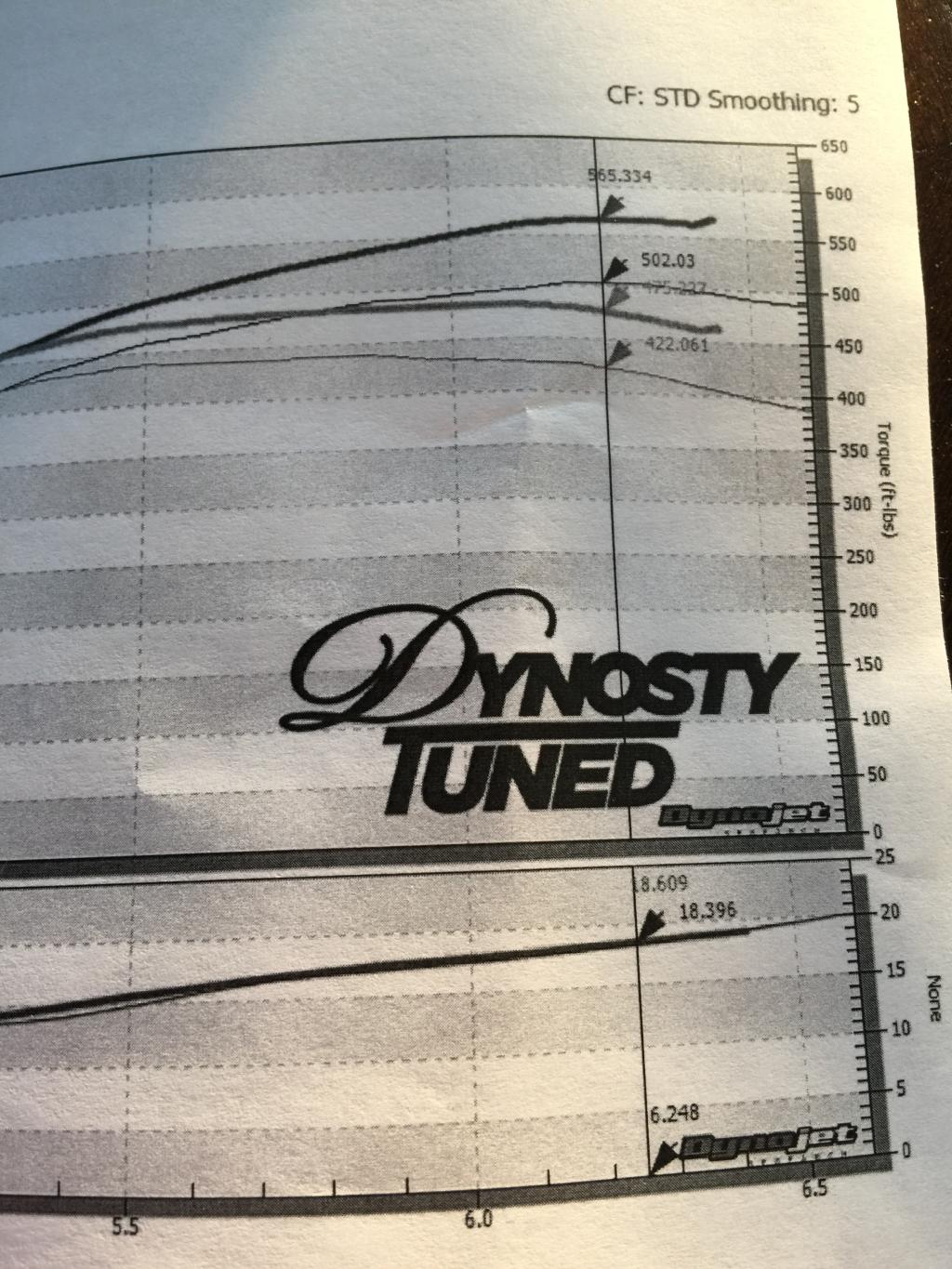

Here is a picture of the upper end of the graph. Note that my boost line is still slightly going up, I can literally lay a straight line on it and it pretty much matches up all the way across. My hp is now flattening out though. If my boost is still going up, should my hp still climp also. Maybe the hp flattening out is a small amount of slip? Or maybe this blower is out of steam already?
