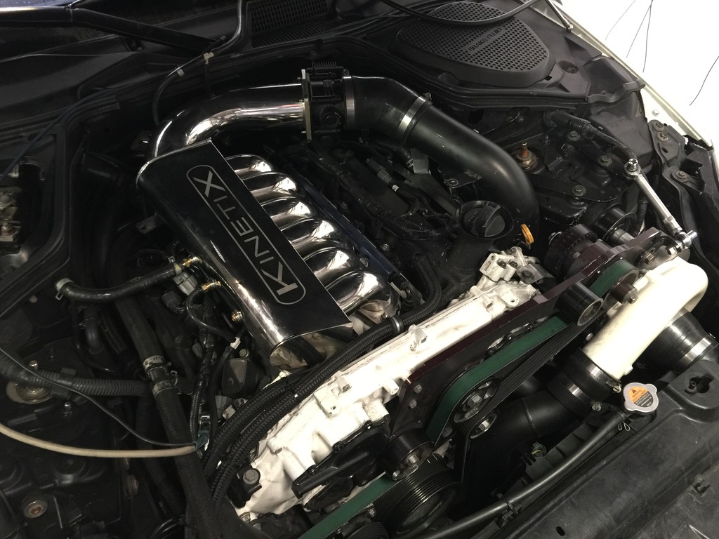

Today in my quest for more power...
I borrowed a friends new kinetix velocity intake. Went to soho and did some pulls with my current set up and then changed the manifold only and did more pulls/testing. No changes were done to the tune. Now I wasn't expecting anything crazy on gains. What did happen was my afrs went rich around 4500 to redline. Ended up dropping about 25hp and 30 or so more trq.
Boost was the same every run at 20psi. Let the car cool down between runs. Did about 7 total pulls.
Now my question is, if the kinetix is as good as most say, shouldn't I be running leaner and not richer since I should be taking in more air? All I was trying to do was see something promising, wasn't looking for big gains, especially untuned. Just surprised it lost so much power. Well anyways, I'll post pics and vids. Nic at soho was kind enough to let us spend 3 hours swapping things around. Great pricing also.

The Kinetix Velocity does not make good gains. People stopped claiming that a while ago after some extensive testing. I chose the Velocity more for its cooling ability over my painted MREV+ and spacer.

The explaination is it wasn't a loss in power it was a shift of power. Which it needs tuning for. What I'm saying is. It's tuned to run at X position on the map for stock intake but it was running farther to the right with the kinetix.
