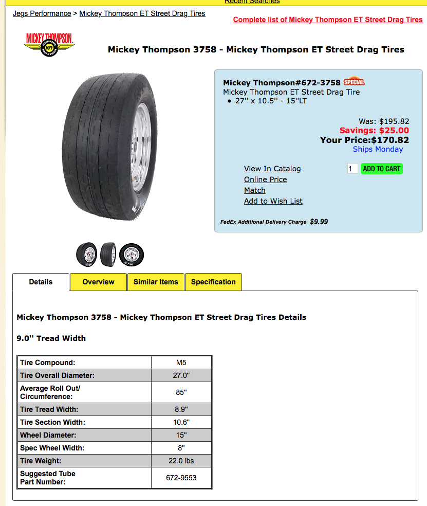

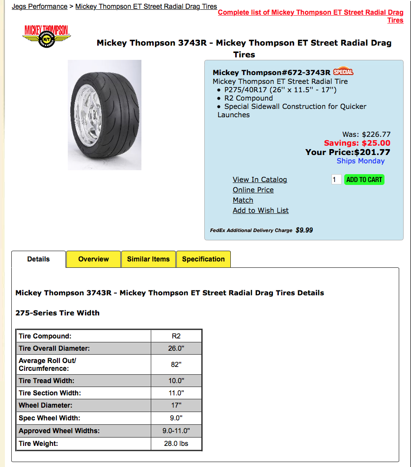

You don't really need DDS axles, you need some MT ET Streets. (NOT MT STREET RADIALS) That way you could still drive to the Dragstrip.......
This Tire will save your Axles......... It's has lots of Cushion and stop wheel hop, and you won't get the huge spike in load that breaks axles that you are getting now with your low profile street tires.
See below, you can get them from Jegs or Summit mounted and Balancedout the shipped to your door for less than $800.
This is a far better investment than $2200 axles, as the complete DDS Pro is the only level worth getting. The lower levels still use the factory inner CV Joint.

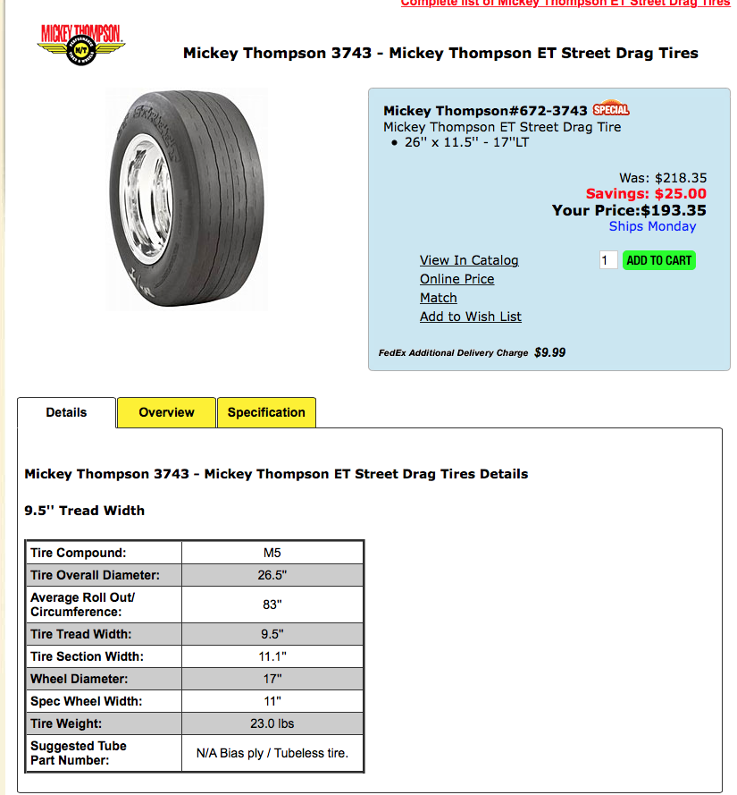

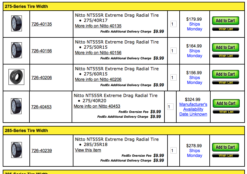

NO! They will not fit over stock brembos. That's a drag......
In this case you can go to something in a 17" or 18" wheel and tire.
Mickey Thompson has some tires available in 17" and 18" or maybe even a Nitto.
and for a wheel yo could go with a Weld Racing RT-S Series S71
Go to the Jegs site and look around......

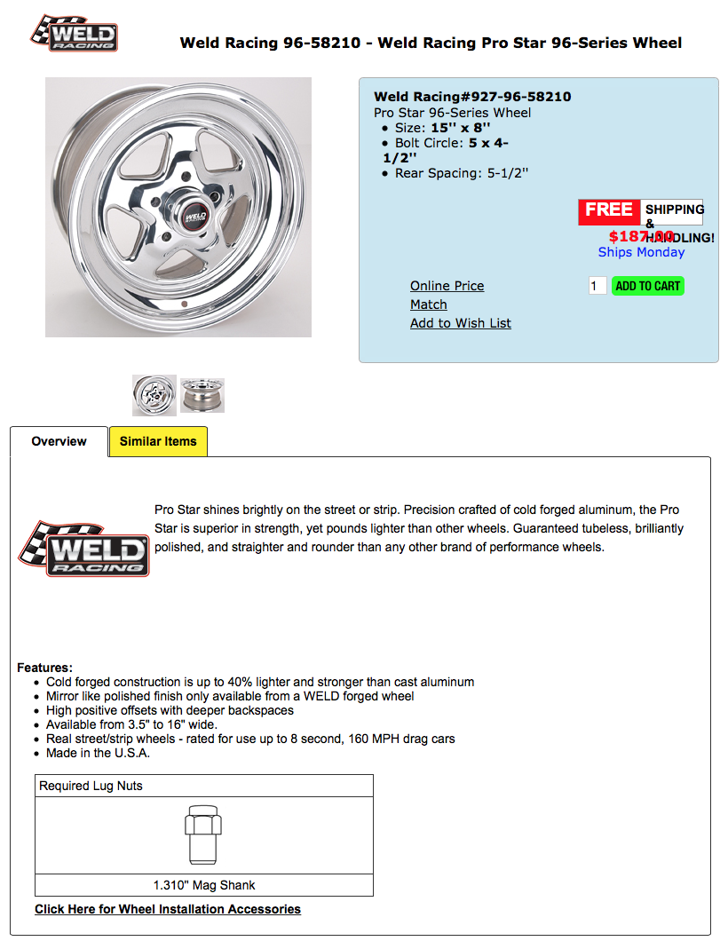

Weld Prostars 15" x 4" with 1.75" BC and a 1/4" spacer with 1/4" longer Lug nuts. And for tires I used MT ET Front 27.5/4.5-15

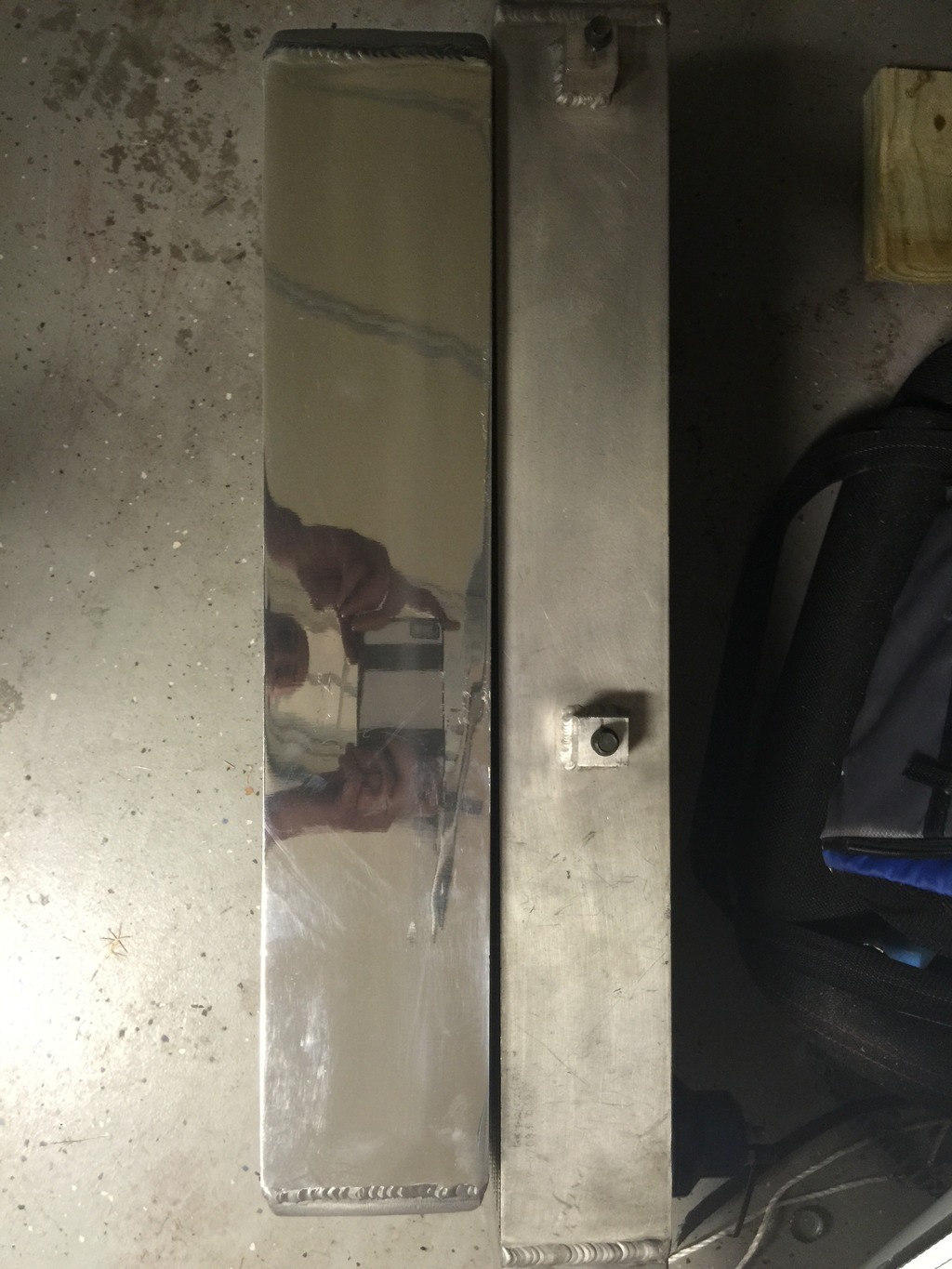

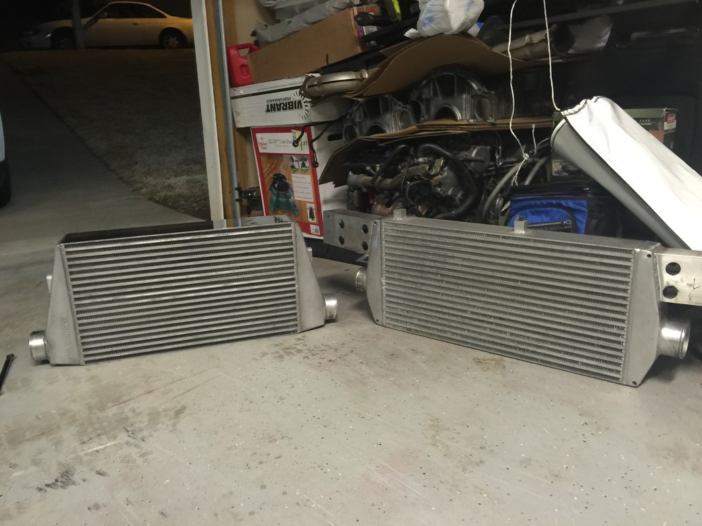

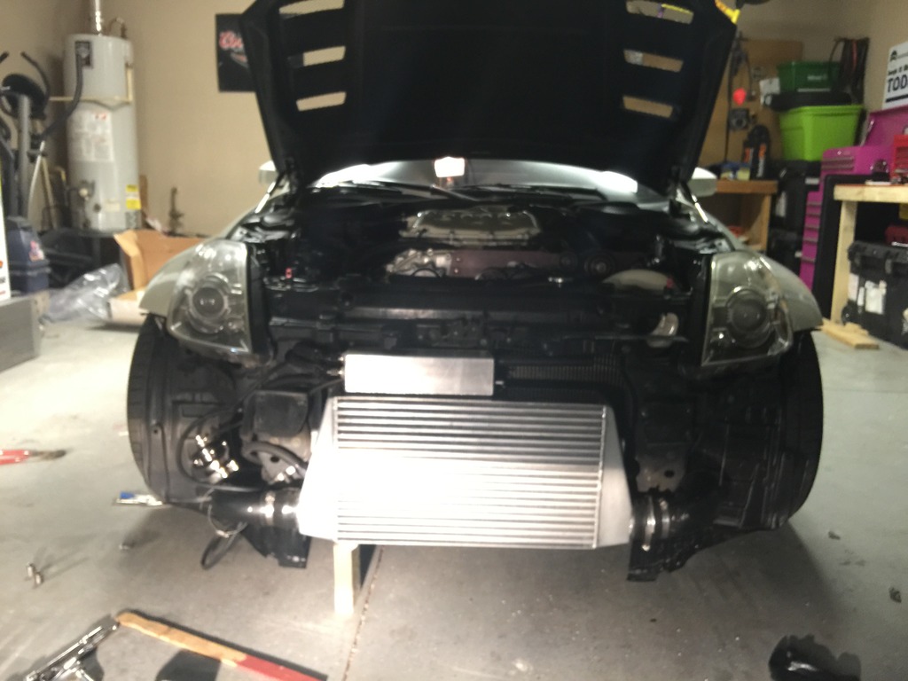

My new tr1245 intercooler came in today. Gone try and get some brackets made today to mount it. Will eventually end up cutting a crash bar and weld it in again.

Old Mar 17, 2015 | 06:47 AM
  #474
Classy's Avatar
Classy
Joined: Aug 2010
Posts: 7,606
Likes: 615
From: Houston
Will you need to modify your bumper to make that IC fit? I like the crash bar thing you did and are doing again.

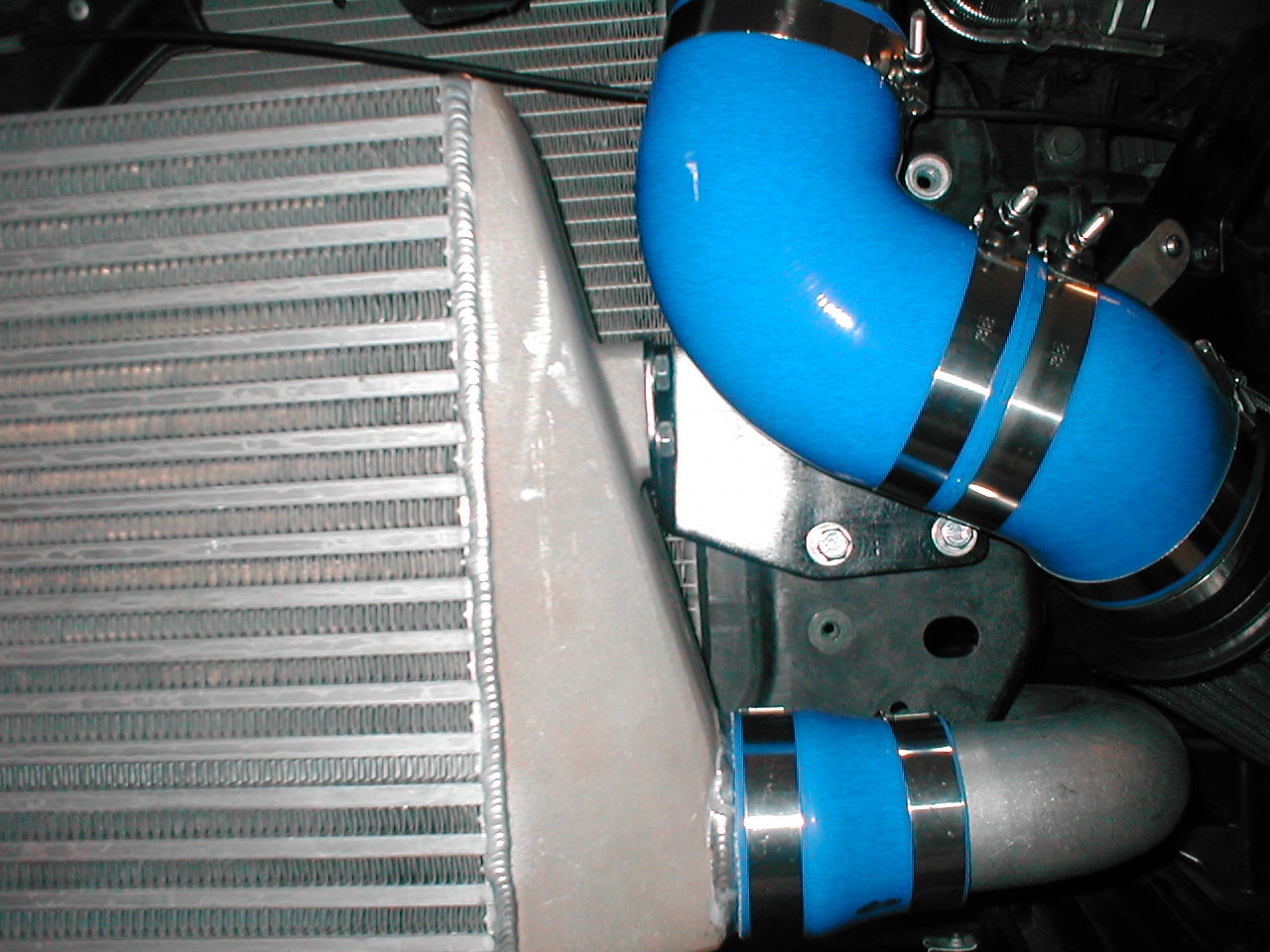

Attached Thumbnails Another built motor Vortech dreamer thread.-p1010016.jpg
I think I'm going to go back to my v2 bumper. Has bigger opening in front and more room. I would need to cut this bumper up again to fit. Will prolly still cut it up and make it fit. I miss the v2 though.
Tim I got your email, thanks for that! I'll try and go after work to get what I need.

you run the splash guard right? That helps divert air to the IC/Radiator and not just go under the car.

So far it has cut my temps down a good bit. At the track I was seeing high 130s and even a few 140*s. On a 60* day. That was the low end of 4th gear because the track was a 1/8 mile. It's 60 here and highest I seen was 105 on a 140mph pull in 5th.
My current bumper set up does block a lot of my intercooler, I'm going to put my v2 back on, it has a much bigger opening and most of my intercooler will be exposed, I expect it to drop even more
