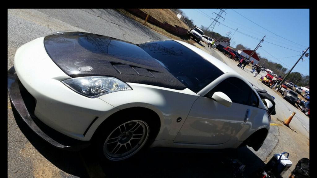

Went to track today, street tires and popped an axle on a 4500 rpm launch.. Street tires and they are sticky!!

Damn, what are you ordering for replacements?

Talking to a vendor now to see what's out there.. I already fixed it and back in the staging lane.

Street tires with Lack of Cushion and Wheel Hop is what kills axles.
I still on stock axles with a 1.51 60ft.
With all that power you need a good set of Slicks and you would be in the 11's first time out, if you ever get to a 1/4 mile track. Plus it's a lot more fun....
You must have brought a spare axle with you, good thinking.....
