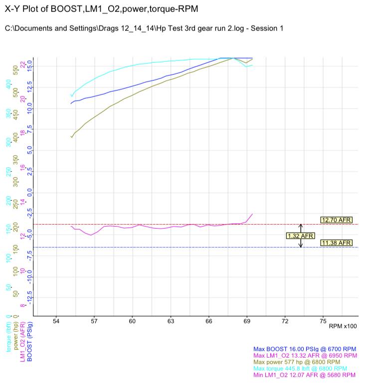

https://my350z.com/forum/attachments...-577-446_2.jpg
This is old mans dyno he put in the top 50 list.

Here is my Dyno. It's making horsepower to at least 6800rpm.
This Dyno is Log info from the Dragstrip in 3rd Gear, so the data you see above 6800rpm is a little wacky as i'm backing out of the throttle to shift into 4th gear.
( Note: this Dyno is from last year when I only went 127mph and was very Lean up top. Also only show 16psi as my boost channel was set to 16psi max)
Attached Thumbnails Another built motor Vortech dreamer thread.-577-446_2.jpg

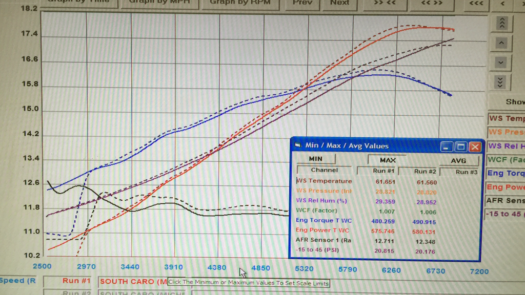

2.87 pulley
6.12 fluid dampr
32/28
93
Mustang Dyno

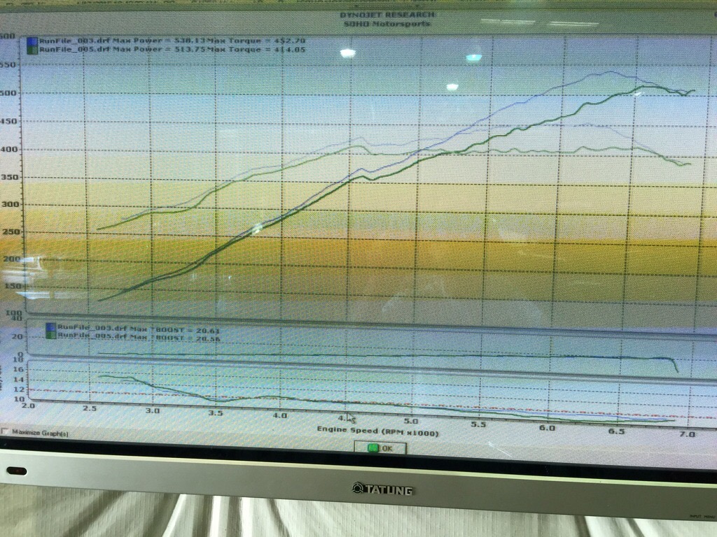

Soho dyno jet

Hi Josh,
I've looked over your dyno's very carefully! I don't know the time difference between the Mustang dyno and Soho dyno, but based on your Mustang Dyno, I'd just through out the info from Soho, just to big of difference.
The V2- Ti Trim HD (Heavy Duty) is a very Tough-Stout blower, you are not going to hurt it!
1. The HP (Solid Red) line in the Mustang Dyno does not fall off hard and pulles to about 6700rpm ( this lead me to believe you may be getting some belt slip )
2. Even at 7000rpm with your setup you are only running the Ti up to 61583rpm. Slower than I run mine and I have a Standard Blower) You are not pushing the blower hard at all, IMO it has a lot left in it. Blower is rated at 26psi and you are making 20psi. That blower is good for the 700whp Range!
3. That being said, trying the 3.12 and running the motor to 7500 would be a good test.
4. Though IMO if I were you, I'd run the motor to about 7000-7200rpm, go to a 34/28 Cog, and a 2.87 serp this will get you 65,400-67,300 blower rpm. Keep in mind that many drag racers run the YSi to 80,000rpm ( 15,000 beyond it's max rating.
5. IMO, I still think you may have belt slip. You could try a 34/28 Cog with a 3.12 serp and run the motor to 7500rpm. And then compairing dyno's would be able to see if you are having slip. This will run the blower a bit slower, so if you make same or more hp (and make the same or more boost), you had belt slip with 2.87 and 32/28 cog setup.
6. Mustang/DynoJet conversion factor is about 12-15% Take 580 x 1.12 = 649whp and 667whp at 15%. And remember a dyno is just a tool for tuning, don't get hung up on the numbers.
7. Only one area that i'm confused about is your 1/8 mile trap speed, this is where getting 1/4 mile info would help you a great deal. If you are shifting @ 6300rpm this makes sense, but if you are running out past 7000rpm you should be @ 100mph or better.
8. All my calculations are based off of 0% belt slip. All Serp setups have some belt slip.
9. It's always a go idea to set your rev limiter just beyond max hp, because even though hp is falling off the car is still pulling.
10. My Stock motor is making Hp to at least 6800rpm. Aftermarket cams you car should pull beyond that for sure.
