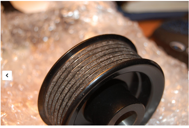

The manifold isn't leaking Im sure. I seen the same psi with the stock plenum, kinetix, and this cosworth. All within a month, lol. I think it's my pulley slipping just that much. What could I use on the pulley to help it grip more?

You can try this:
http://www.carbinite.com/Applications_Auto_Pulleys.html
If heard it works great!
Attached Thumbnails Another built motor Vortech dreamer thread.-screen-shot-2015-05-12-at-7.44.09-pm.png

I haven't called them yet, but are they in business? That page doesn't work. I want that coating. On a 3.48 pulley. Actually make that 3.6

Alotta places can do a friction coating like that, ask around locally

Thanks, I'll try and ask around local and see what I dig up. If not I'll give those guys a call in that Link above.
I don't know about local guys (here at least lol). But carbinite has a reputation.
Some people claim their coated pulley works better than an 8 rib. And I know it's not terribly expensive so...
But I want to get my kit in first, then figure out what I need to do with the intake pipe (maf tube looks janky), and get my intercooler fitted/get the t-bolt clamps. Then get the car running. Then I'll worry about the belt routing/pulleys before I get a proper tune.

Quick research shows those guys coat a lot of pulleys with success. Average price is about 100$ with quick turnaround. I'll be calling them soon to get my 2.87 pulley coated.

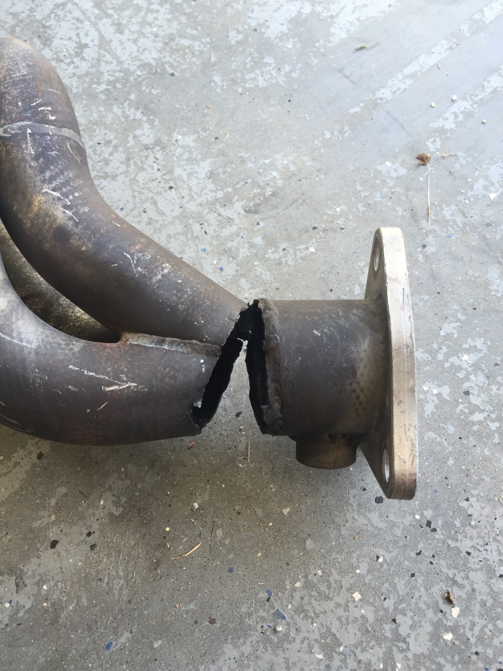

Did some pulls last night and heard a nice loud exhaust leak. Jacked up the car this morning and found out my headers cracked around the weld. They said it was because of my heat wrap and are not warranting them. Working on welding them now..

That's really unfortunate. I hope you're back up and running soon. It's understandable that they won't warranty the headers when using wrap. The wrap just traps in the heat instead of dissipating it. I asked DC Sports about wrap before I bought mine and they said the same thing. That's why I opted for the ceramic headers over the stainless steel with wrap. Good luck. Get that thing back together soon.

I think that is retarded. It obviously broke at the weld, which proves to me crappy workmanship...
Also, that metal is paper thin... Junk imo

Well I had my friend weld it up for free, so I'm gonna put it back in this weekend and see what it does. Hopefully it holds till I can afford something different.

That happened to me. I had a second layer of steel welded around the area.
Make sure that the exhaust is well supported at the end of the test pipes.
IMO, it's from vibration and lack of support.
