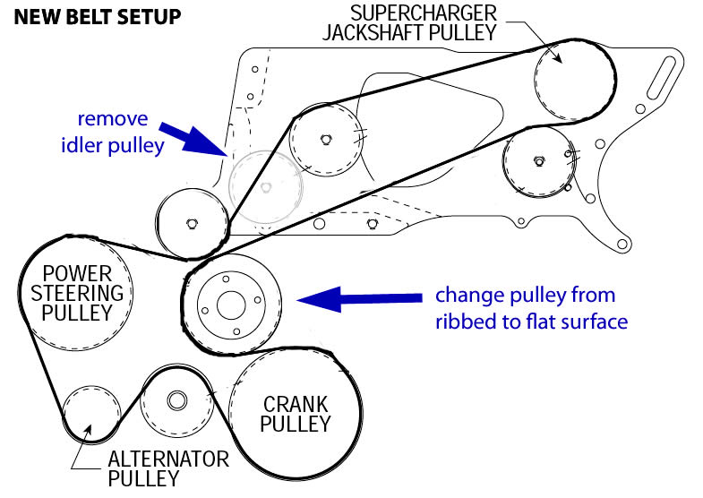

Perhaps it's time to do a belt setup like mine?
Theirs a picture on here somewhere.
https://my350z.com/forum/forced-indu...-solution.html
This is like mine less the idler pulley under the jackshaft pulley. This way you get about 250* of belt rap around the crank pulley.
Also the small idler pulley above the Large diameter factory idler pulley is not needed.

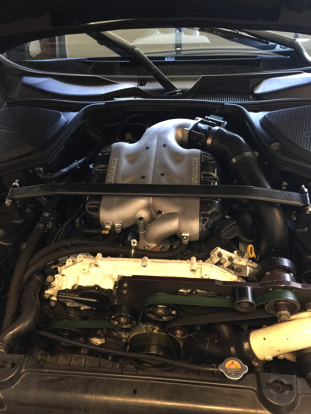

Finally installed this today. Car runs and pulls perfect. Feels like it pulls better through the top end, but prolly my imagination. I'll be going back to soho to use their dyno and have Hal tweak the tune a bit via wifi. I'll have to do some work to the bay to get everything to match. Kinda wanna polish it and the blower.

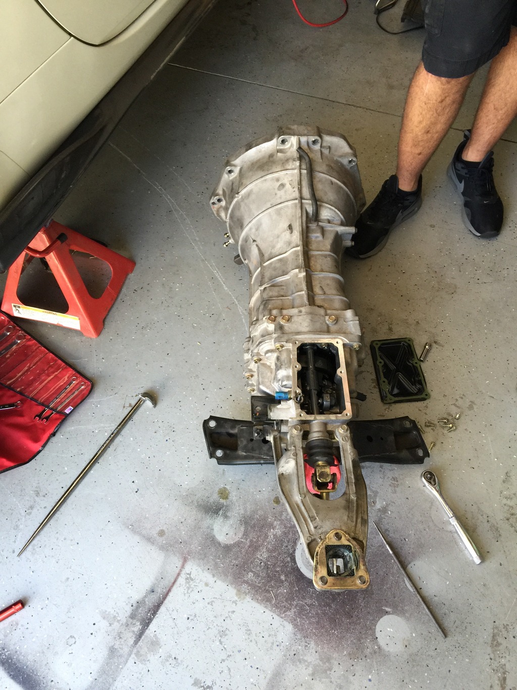

Well my tranny got locked into 2nd gear. Tried everything to break it free. Even got pulled over because I was riding in 2nd gear and my car was loud as hell. I would ride second then hold clutch in and drift. Cop seen me tacking 5k In 2nd gear beside my friends terminator cobra and thought we were racing. He was very cool about everything after I explained what happened.
Pulled tranny today. Came out pretty quick. Took about an hour. Still locked up in 2nd. Got a friend of taywAns that's gonna rebuild it for me. It's a cd009 and I'd like to hold onto it. As for now, I'm getting a loaner tranny till mine is fixed lol.

Ya, that sucks.... I wonder what happened?

Really don't know, was doing some pulls and went to hit 3rd and it just stayed in 2nd. Hopefully it will be torn apart soon and I'll you guys know.

Got a replacement tranny put in, then we had to pull it right back out. The Pivot ball was to long and keeping the clutch engaged. Swapped pivot ***** out and put it back in. Tranny is nice and smooth! Big thanks to taywan!
