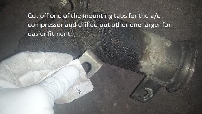

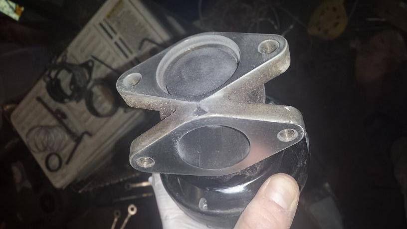

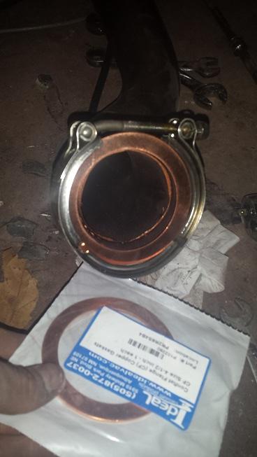

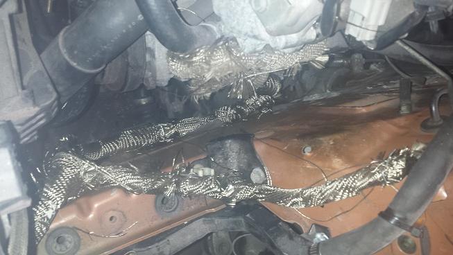

Took the entire hot side of the kit completely out of the car two weekends ago due to exhaust leaks.
Bought all new clamps and copper v-band gaskets.
Installed some more 1800 degree exhaust wrap on A/C lines (doubled them up because I do not want to replace them)
Sanded every flange end to smooth out to try to get rid of these exhaust leaks.
Installed 7-8psi spring(I think)
Purchased the UTEC wideband gauge/adapter for easier tuning(it's pretty good anyways with the tune from the UTEC website with slight modification)
Got half of it installed last Sunday, but ordered the wrong V-band clamps and though I could pick up wastegate gaskets at autozone. Will finish installing this Sunday.

Installed cheap nismo replica exhaust off ebay and it sounded exactly like stock. Took it off due to not fitting too well and purchased an exhaust cutout with a wireless controller.
Also when installing the exhaust it made the exhaust at the y-pipe start to leak even with my copper gaskets in place(didn't leak before I installed ebay exhaust) I am going to take the copper gaskets out and install 100% graphite gaskets.(on only the y-pipe flanges)
On a side note I was barely able to get the car to boost in neutral and make the BOV go off. I can now do this with the spring swap(should of made a different) and just taking it out and sealing the exhaust leaks

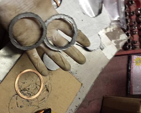

100% graphite v-band gasket. The copper ones didn't work well because I could not get enough pressure to make them seal. The graphite will seal at much lower pressures and can withstand 3000 degrees

I'm around $2000 for the build. Worst part of the kit was the sealing of the v-band clamps, which is now perfect. If i did the graphite gaskets in the first place it would have been fine. I probably would have done a custom rearmount setup if I were to do it again, but it still would have cost around $2000

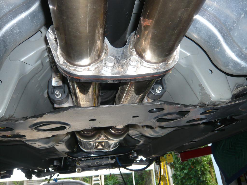

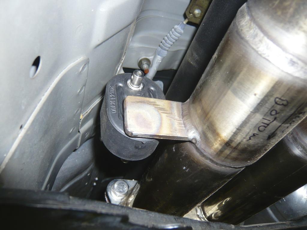

This is me. My "golf" is right in my garage. Have not driven this car in many years but am really enjoying the journey of working on it.
When I got my car back from the awesome bubble shops the HKS exhaust system was only supported by the 3 down pipe bolts and at the very rear and as I disassembled it found it was leaking like crazy.
Here is shot of the totally fabricated fix.
then I get to have fun beating my cheap Miata to death
