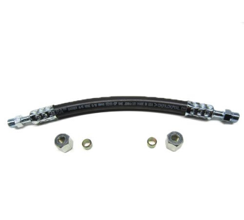

Blew a/c line on a 100 mile trip yesterday.(won't drive the car without a/c) I need to take the turbo out and possibly downpipe to repair. I am going to get a longer line and compression fittings to make a custom line completely away from the exhaust

My labor is free. I just need to see which pipe it is(there are two very close to the exhaust. then I'm going to install a 12" or 24" compression fitting to rubber hose line fix in it's place to get it away form the exhaust.
The original TN kit came with a new line which costs $170+ship. THis line will cost me less than $60 and I have a 20lb cylinder of r134a in my garage anyways

These compression line fix cane come in custom sizes. I can re route them anywhere to get them away form the exhaust.
TN kit?! This is GODSPEED!!!(same piping)

Took turbo out. Rubber hose a/c running along side framerail burned through. Cut, got pex connectors and replaced with a longer 300psi air line. Filled up and a/c works fine, but line expanded.
Ordered correct a/c line to withstand pressure. Have to wait for it to come in to replace.
