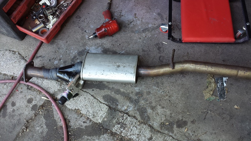

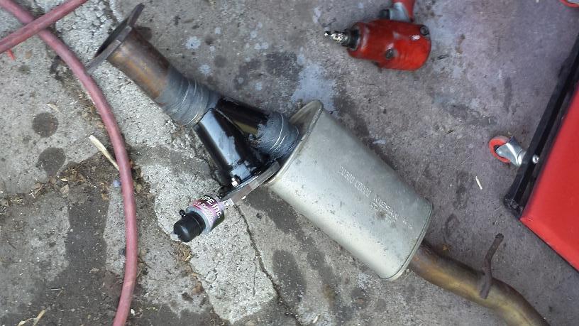

Installed electronic exhaust cut-out (Didn't drive since I still need to run the wire in a more neat fashion, but played with it while my car was jacked up) since
I'm running the stock exhaust.
This will dump before the resonator and the muffler for when I want a some more hp/faster boost
Ran out of welding wire, so I used titanium wrap/muffler weld/mechanics wire. No leaks
Unfortunately the resonator was a little bit in the way. I could have moved it further down the exhaust and leaved the e-cutout where it was, but I didn't want to keep bolting the exhaust back up and down, plus I don't think blocking 10% of the cutout exit will really make a difference.
Will get a video soon of sound once I run the wire to a permanent location

Realized that the flap hits the resonator...Had to pull it off last night and cut a pizza wedge into the side then weld to angle the e-cutout to pass the resonator. It now opens fully and sounds like a car with no muffler/resonator/cat would sound with a turbo.
Game night today, but if I get enough time to run the power wire(before hand) I will take the car out and video it.

I would have just deleted the resonator. The turbo quiets things down at least as much as the resonator would, so it shouldn't end up louder than stock, at least outside of boost.
Old Jun 26, 2014 | 07:13 AM
  #266
iideadeyeii's Avatar
iideadeyeii
Joined: Nov 2011
Posts: 4,028
Likes: 479
From: Lawtown
I didn't want any rasp from the stock exhaust and I hate rasp with a passion nor did I want to test deleting resonator then having to put it back in. I've bolted this exhaust up and down about 5 times in the past week already
Also, this truly is a sleeper now...sounds badass(obnoxious) with the dump

FWIW, he's right, turbos tend to kill rasp pretty well. The impeller basically chops up the sound waves. Any rasp you hear on turbo cars is usually from a wastegate dump.
