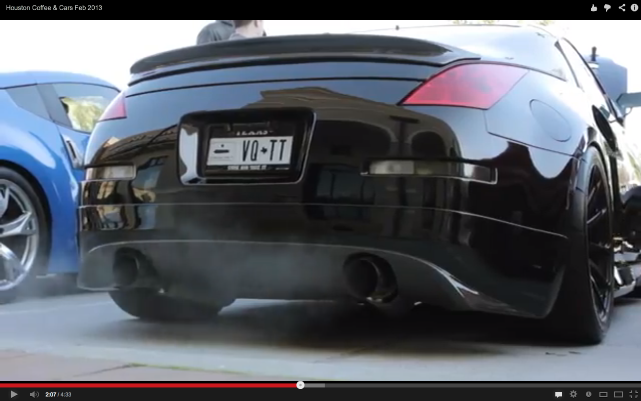

Originally Posted by Jaxter
Thanks man. But what is their camber? That is what I'm trying to avoid. All I can speak for is my car. The setup did not fit my goals.
Need to ask the guys that are running it. Remember... It doesn't "have" to fit "inside" the wheelwell. Even mine poke out some and are only flush with the fender at it top center point. I prefer a square alignment like what you're going for.
https://my350z.com/forum/wheels-and-...es-thread.html
Attached Thumbnails Stillen HR S/C-screen-shot-2013-07-10-at-10.33.25-am.png
