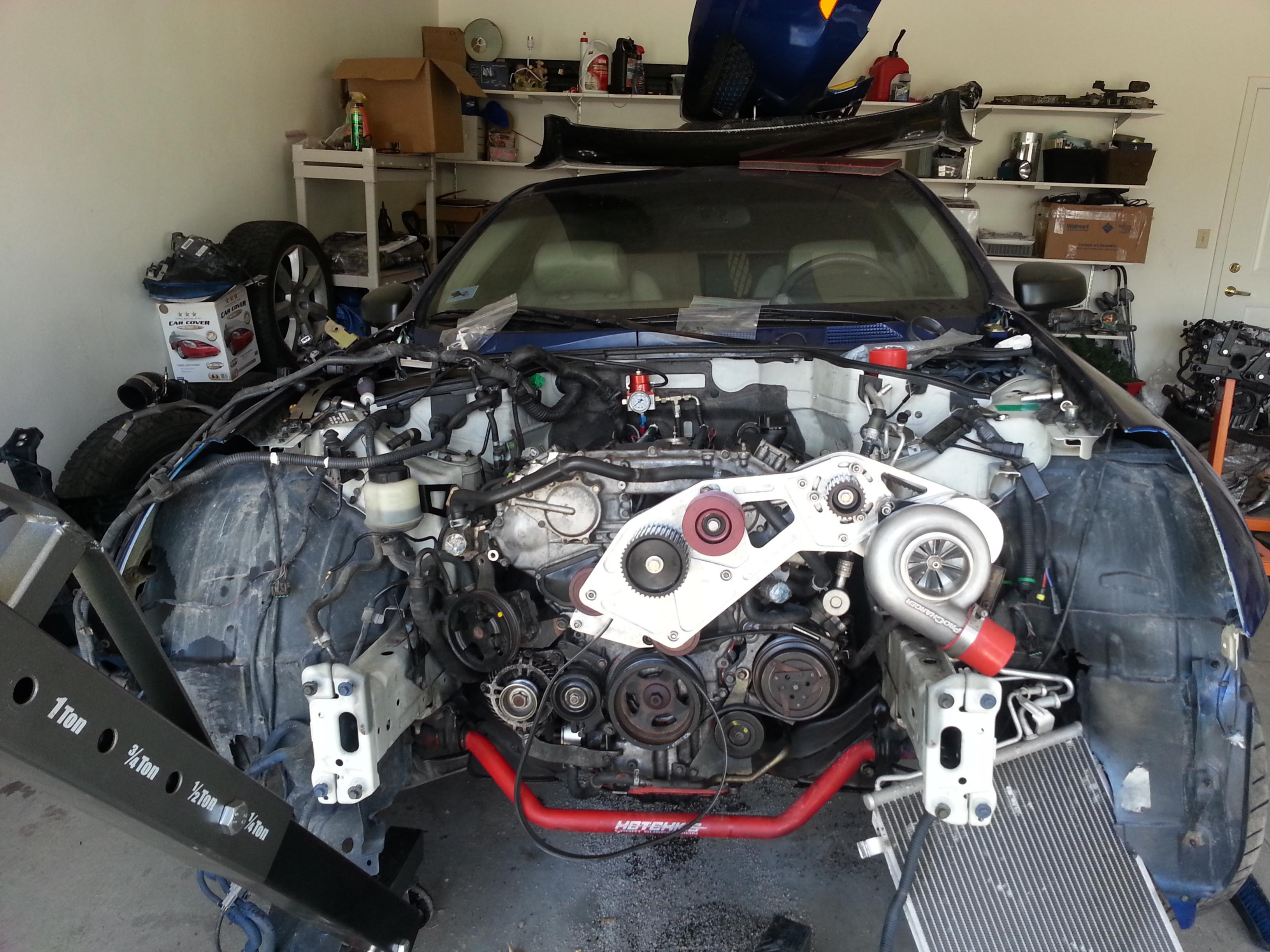

Motorn is installed!

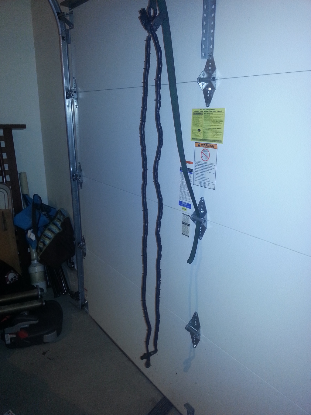

Well the wire harness is installed, but my front 02 sensor harness are to short for my new exhaust so I had to extend my harnesses.
Only thing left to do is extend the two wires that go to my water temp sensor on the back of the motor by 1-2 inches.
