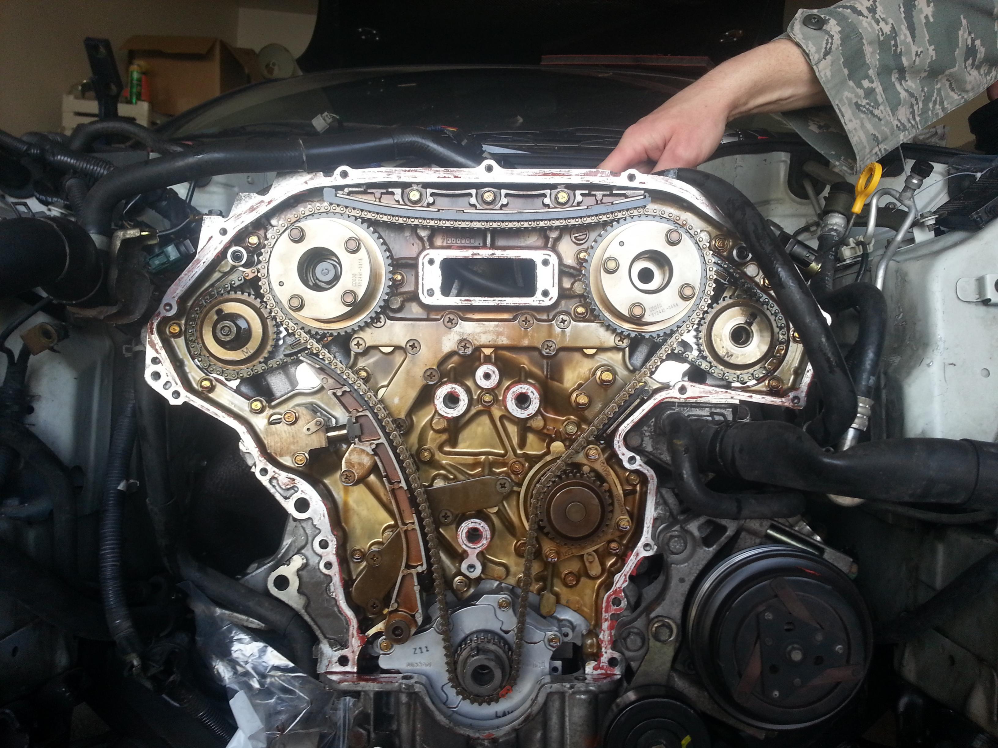

I also pulled off my timing covers to look at my cams compares to my other motor and they look identical. So im gonna do a compression test to see if i can find anything.

Cb7I looked at the cams while #1 was at tdc and compared it to my other motor and I cant see a difference between any of the cams
Pretty sure you'd hear some heinous noises if you had a cam off by any significant amount. But they might be off a degree or two... I think though you would get a p0340/5 code or something similar.... Not sure. Could be a sensor? Do you have good grounds?

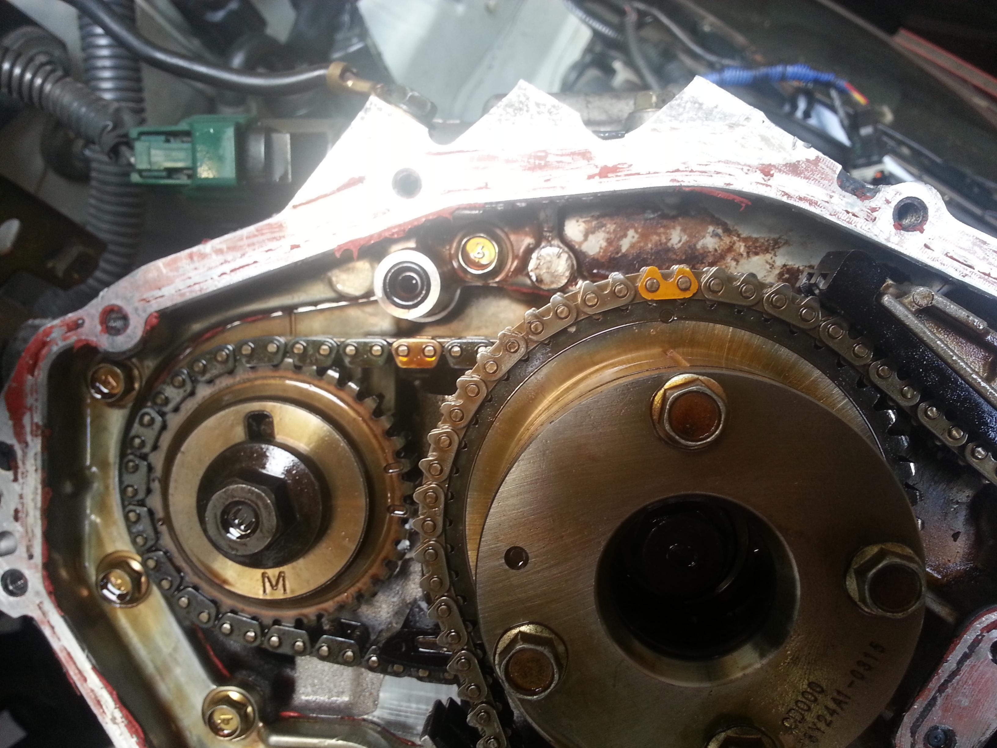

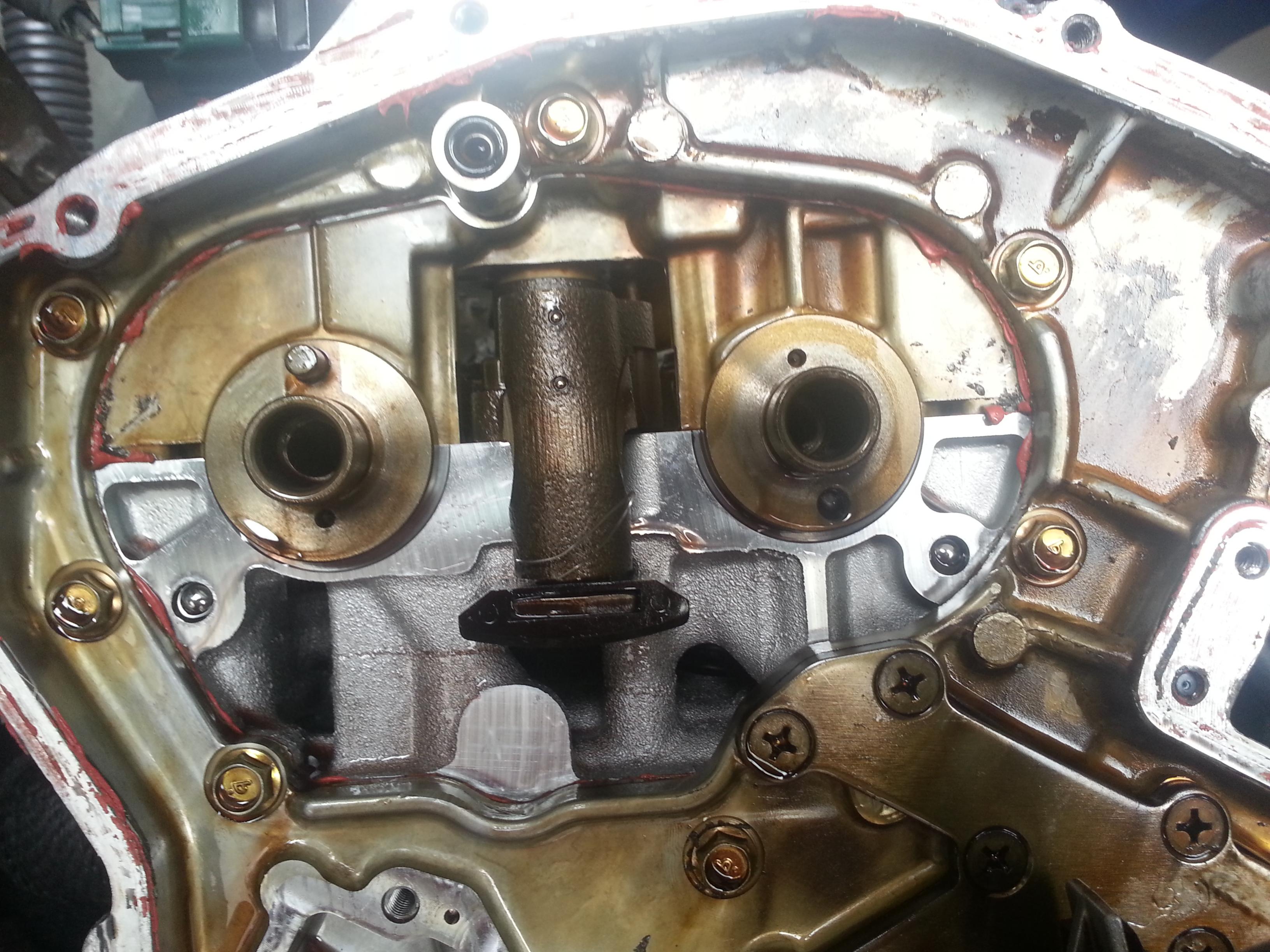

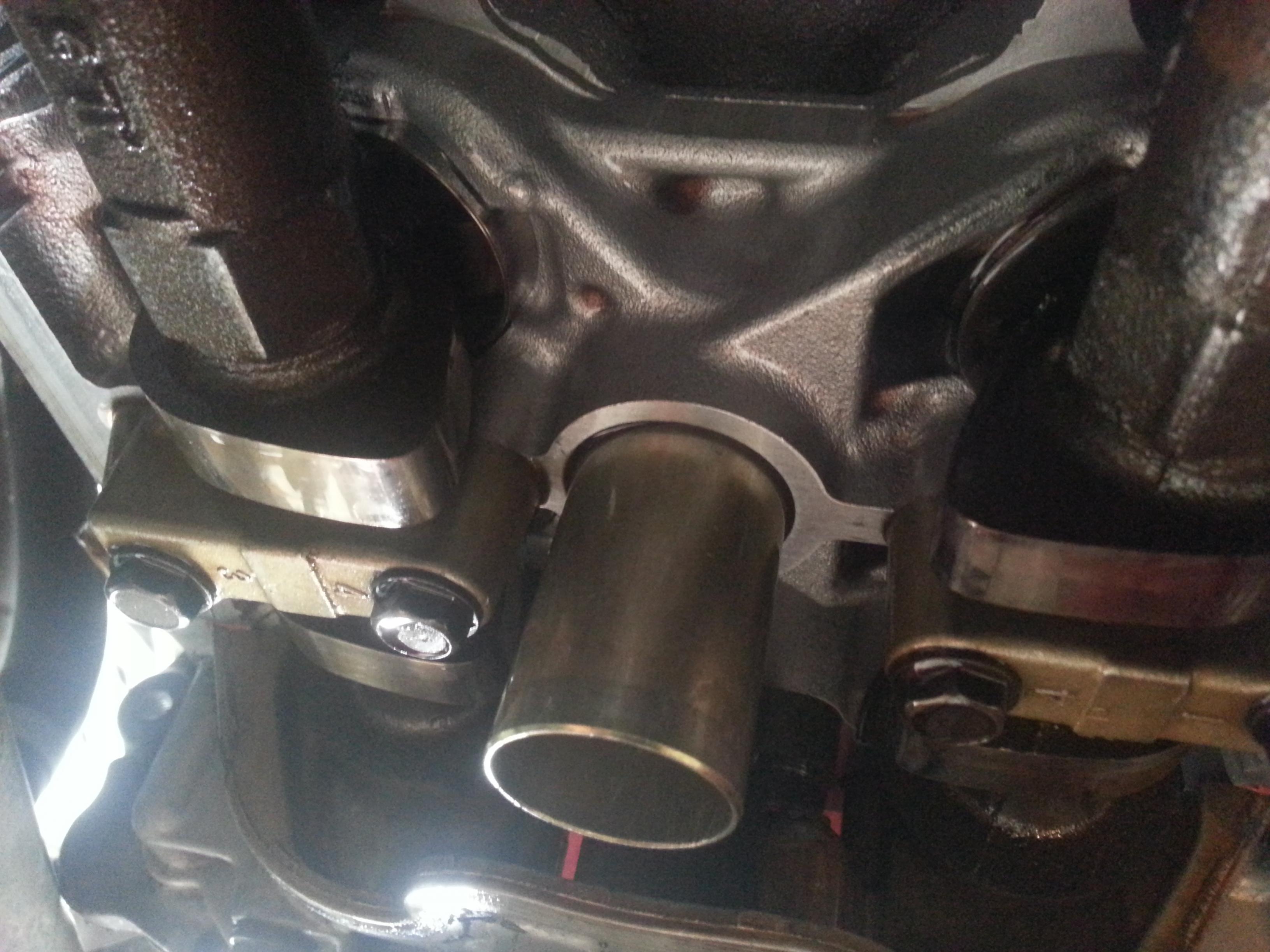

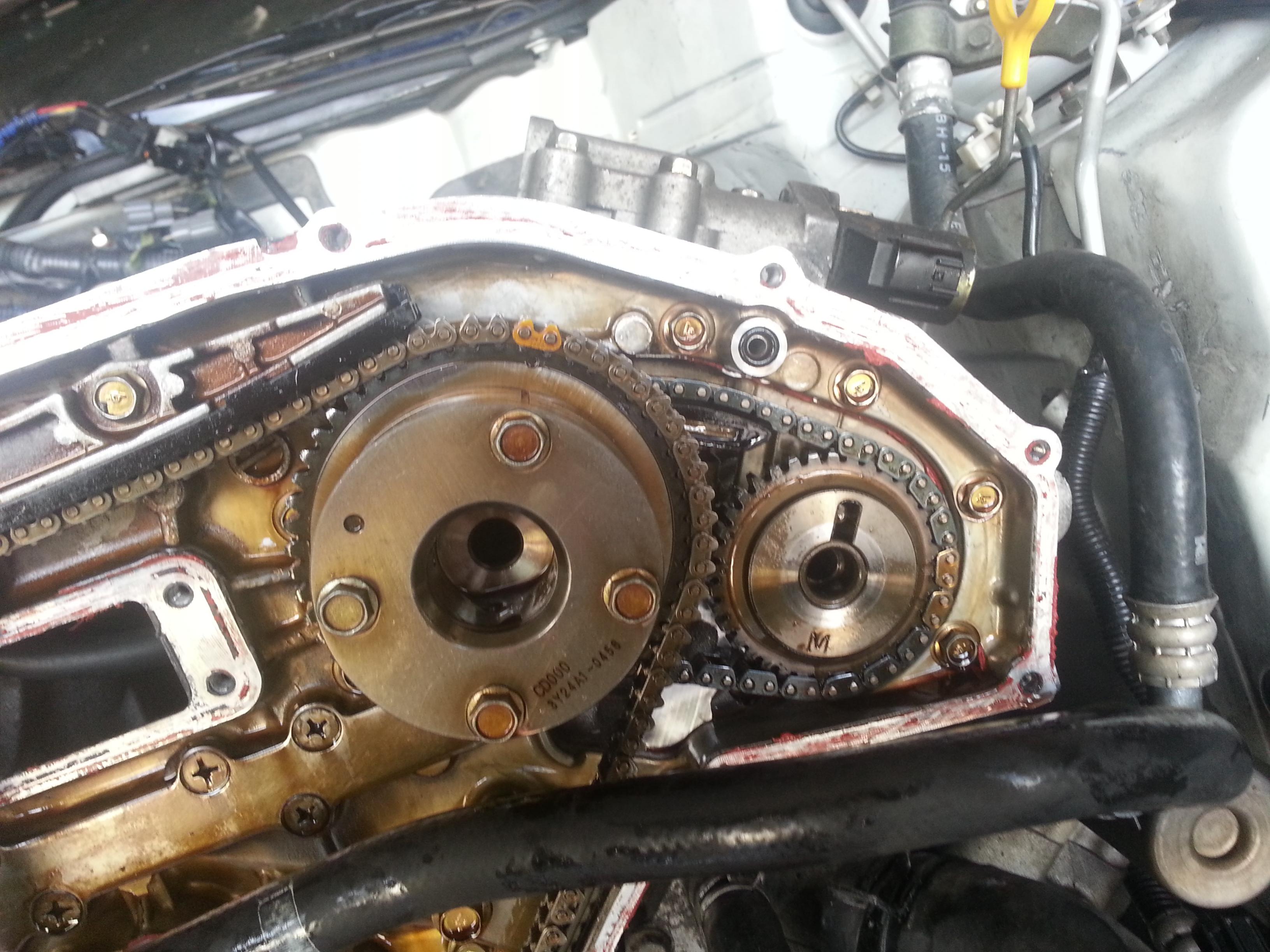

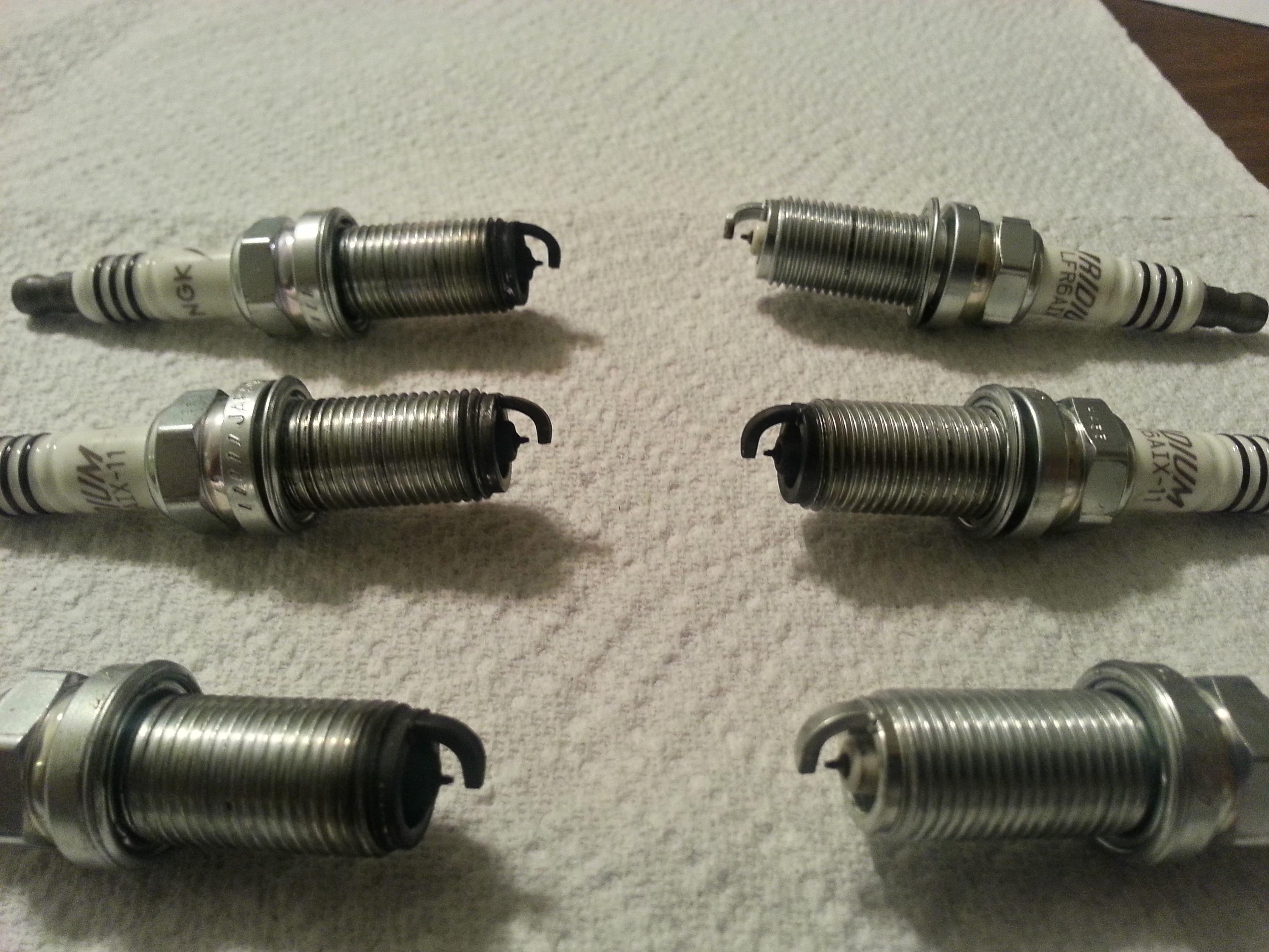

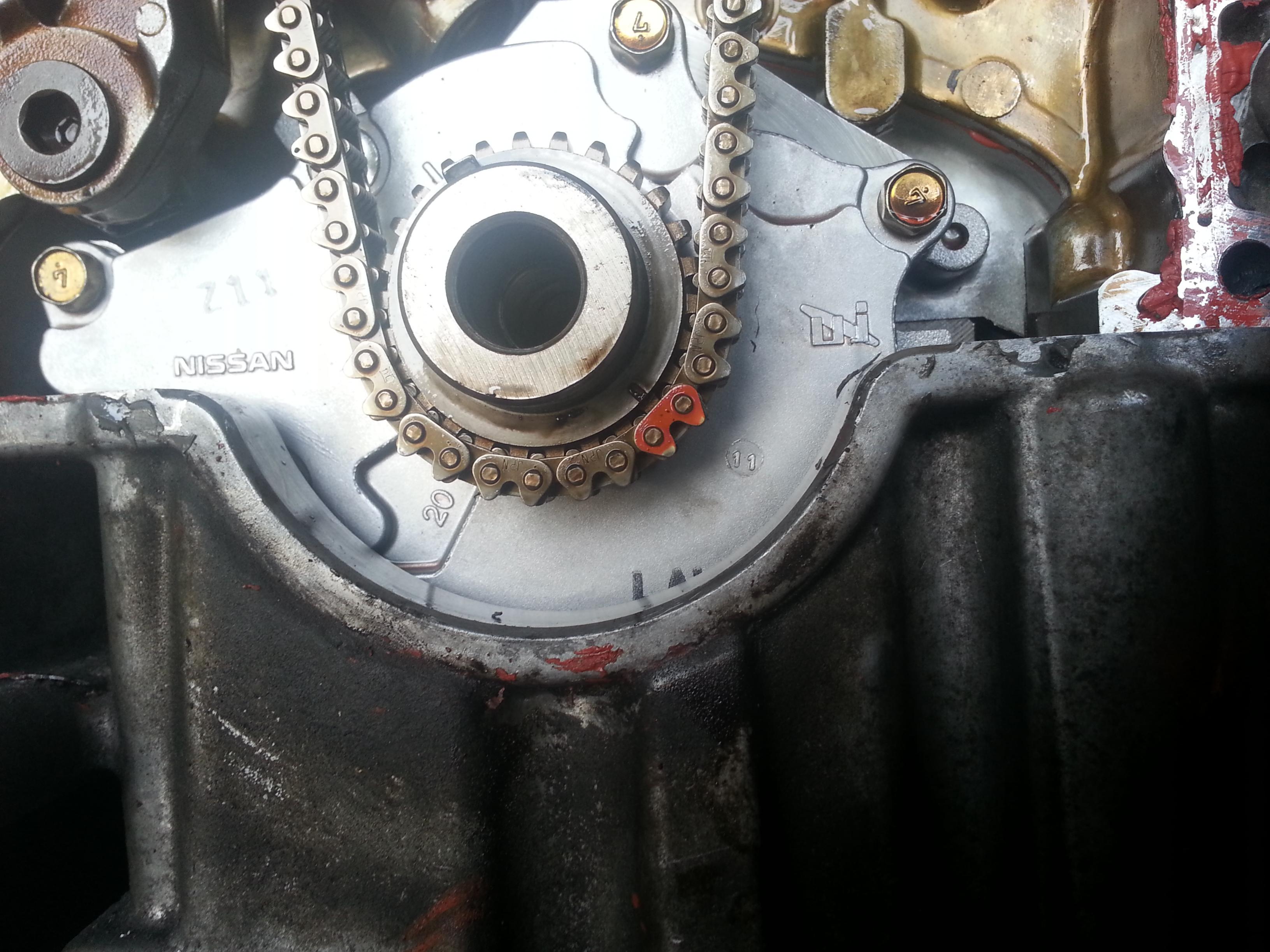

So I reset the timing it looked like bank 1 exhaust was off a few teeth. I also pulled my plugs and 2/6 are still silver like they arn't firing. I will be putting it back together tomorrow and hoping for the best.
