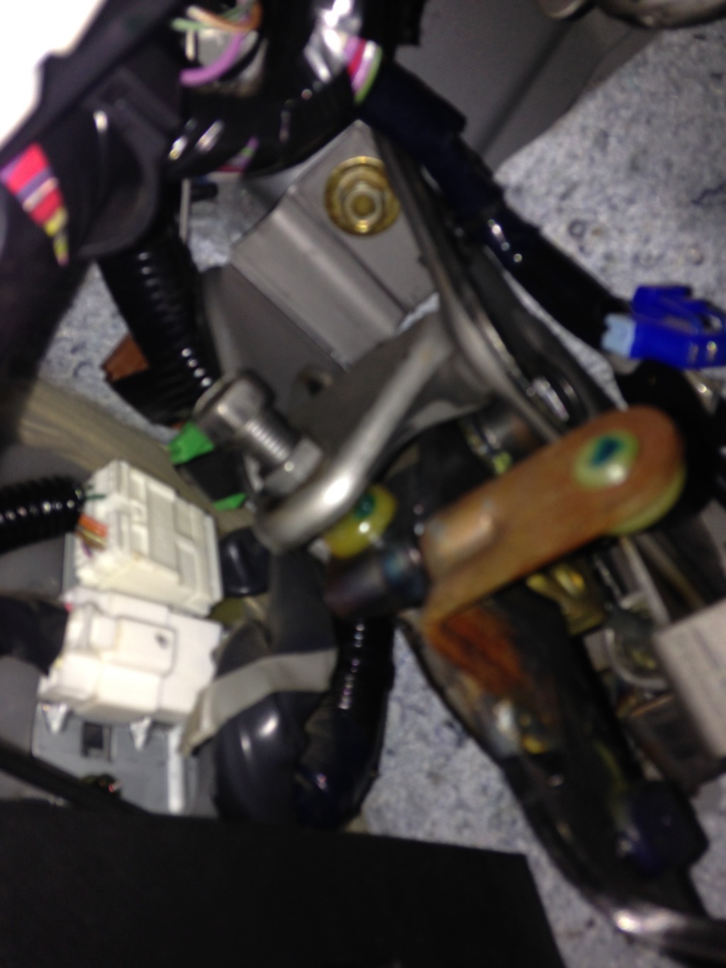

Yea the sensor or bolt at the top of the pedal travel back it out and then try to bleed it

Likes: 43
From: new bern nc
See the bolt. I had to back it out to get mine to bleed. Yours may have sensor if you have cruise. Name:  59B0D91A-3604-4F30-806F-BEA98E5BEFCA_zpszkd4kprs.jpg

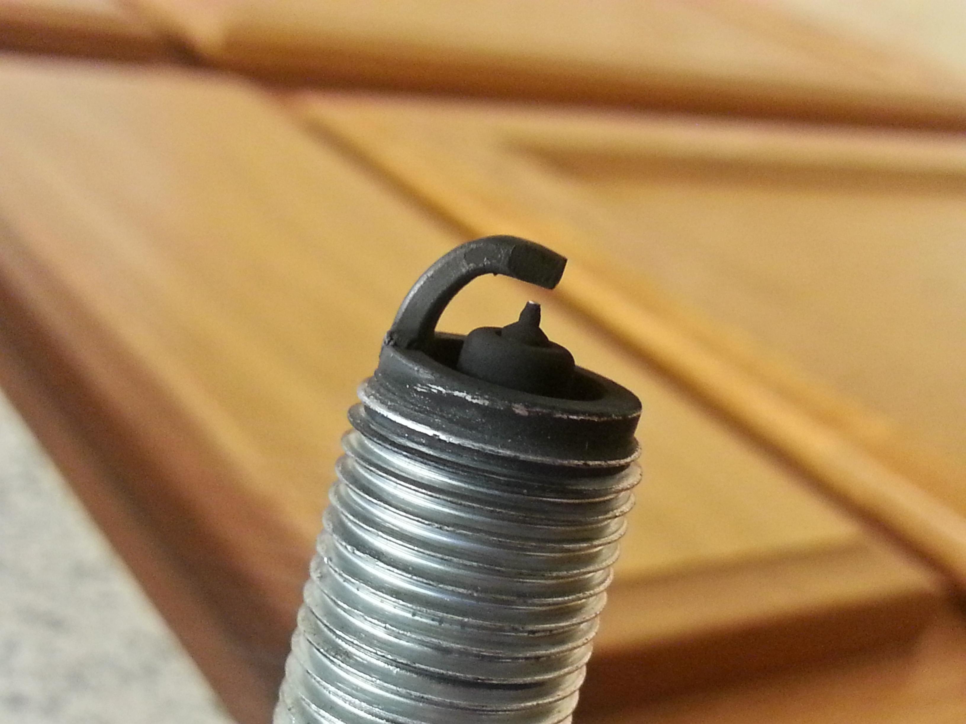

So I double checked the coils #2/4 were crossed. Now it sounds a little better but dies if I dont give it gas.
So im checking plugs and find 1,3,5 look like this
2,6 are still silver with no black and smell of fuel. #4 has a little bit of black on the diode now.
After I reassemble im going to do the power test again to see what I find.

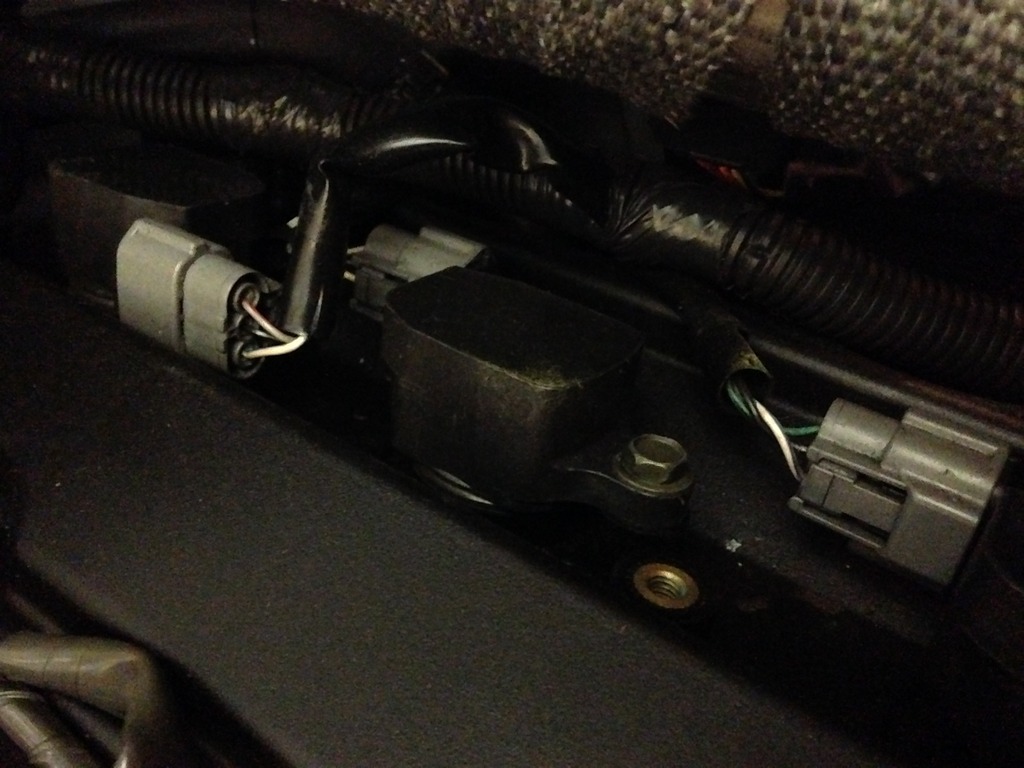

4 come from the back and 6 is the middle one.
Old Apr 18, 2015 | 05:58 PM
  #260
2bad240's Avatar
2bad240
Joined: Jan 2011
Posts: 1,067
Likes: 43
From: new bern nc
the wires for 6and 2 are by each other and the wire for 4 comes from the back.
