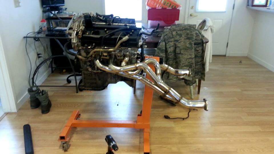

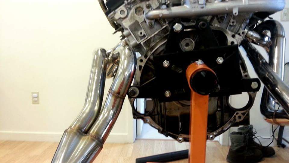

Will be doing a test fit to ensure they clear the firewall...why would you make left and right headers so different??

Originally Posted by Conway_160
Attachment 371796
Attachment 371797
Steering **** and **** clearance
I see that they have to clear certain things but is that reason enough to have one side completely different than the other?
Motor will be temp installed this weekend to ensure LTH will fit and clear firewall and steering.

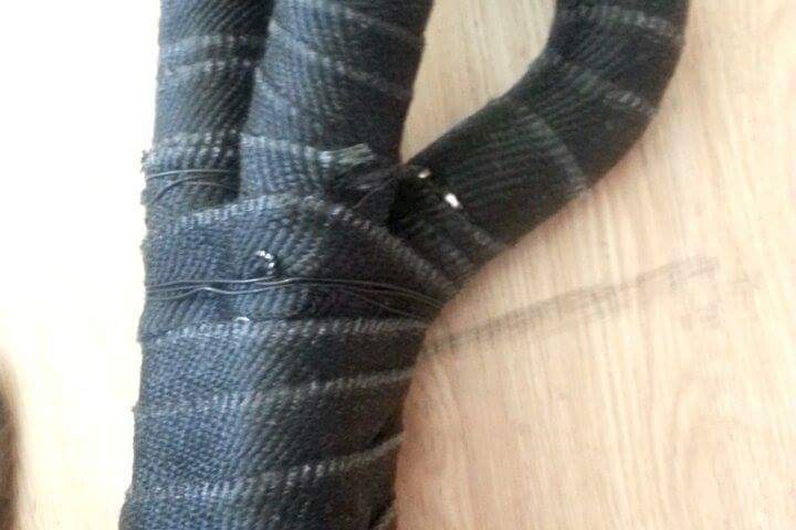

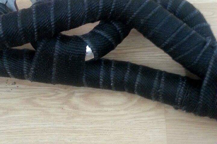

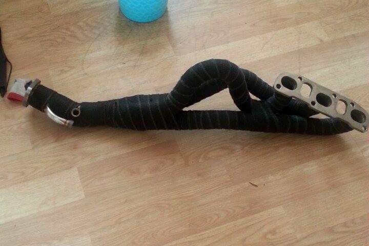

Well got one header wrapped. It took about 3-3 1/2 hours and ~46' of 2" wrap. Overall I don't think its that bad but I missed two spots and this is going to be the easy one to wrap.
You can see where I missed a my first spot, and its a big one.

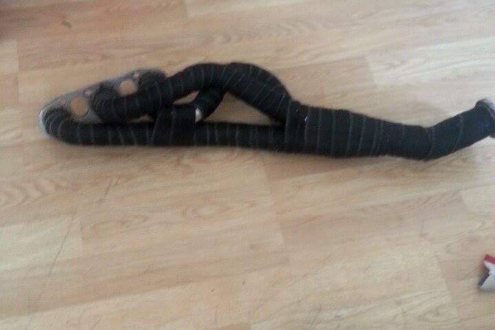

Better shot

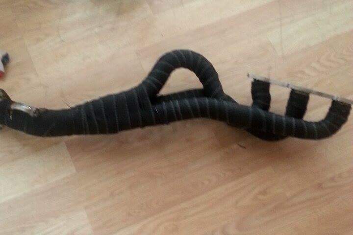

The other spot I missed but its a small one.

Tomorrow i'll go buy the spray and spray the **** out of it to make it seal even better.

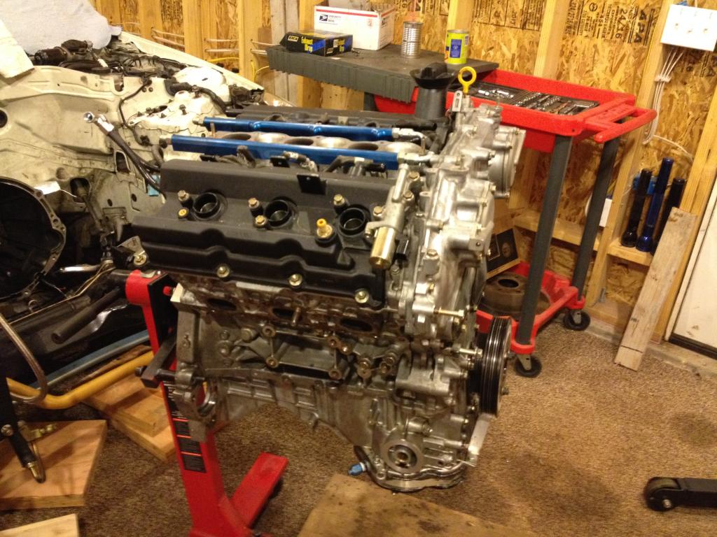

Size:  363.9 KBName:  20150406_114729_zpsihmrlnka.jpg
Size:  326.7 KBName:  20150406_114713_zpsvdwspvxl.jpg

nice. what fuel rails are those? cjm?
I was told they was CJM but I'm not 100% sure. I think its a pieced together kit unfortunately.
Thanks Tim!

Those look like 1st gen CJMs

Yea thats them 1st gen cjm

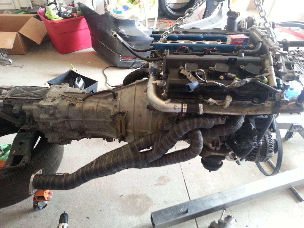

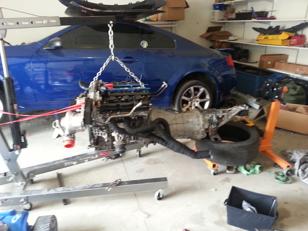

Headers are wraped and installed, transmission is on, fuel rails, fuel injectors are on, and supercharger is on. We will see if she fits this weekend
