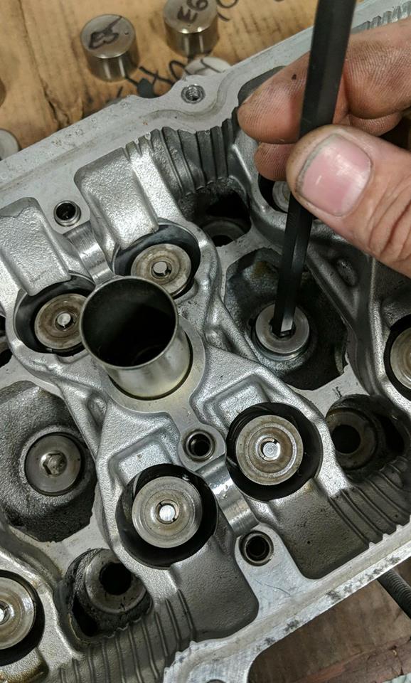

So the one with the allen key is the one that was leaking. They said the engine will be ready to be picked up later today at no cost to me. I'm trying to see if a new headgasket was used. I hope so since I don't think they are reusable. Also asked if I should worry about my rings and bearings so well see what happens.

I would ask the shop how they managed to produce a leak in the head. I've never heard of that particular issue before. The fact that they reused a headgasket that seals by crushing is a red flag. Which shop is this and what's their track record?

The shop is Emerald Coast Motorsports. They have a good track record from.what I've seen and heard. I'm not 100% how the found it but I will be testing it again when I get home. I know they have pressurized the system and looked for the leak that way. I don't know how you isolate it in the head though.

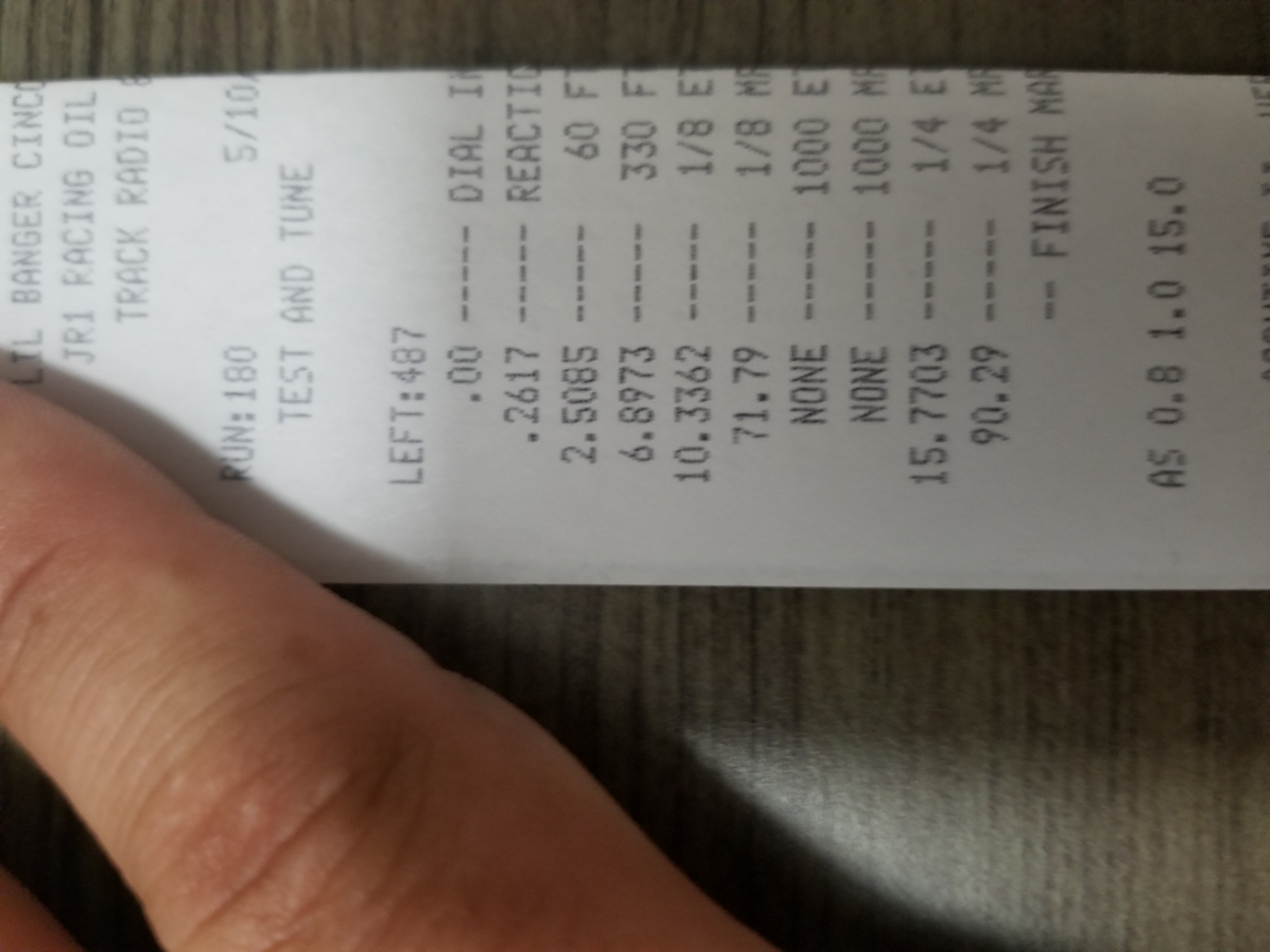

Well figured i would lighten up this thread a little bit.
Tomorrow i'm going to try to beat my G's fastest time down the strip in a 2017 Nissan Quest. I doubt i'm able to do it but i've got another week close to a 1/4 mile strip.
Stock G was:
2.0845 60 FT
5.9967 330 FT
9.2167 1/8 ET
76.35 1/8 MPH
11.957 1000' ET
--------- 1000' MPH
14.2831 1/4 ET
98.02 1/4 MPH
Well see how a Quest does with a VQ35DE in it as well.

So i talked to the shop and they told me how they figured out what was leaking. They fabbed up some coolant plugs so they could pressurize the block. When they pressurized the system with out the valve covers on they could see the coolant flowing out of the coolant plugs in the head and down a oil passage through the block.
