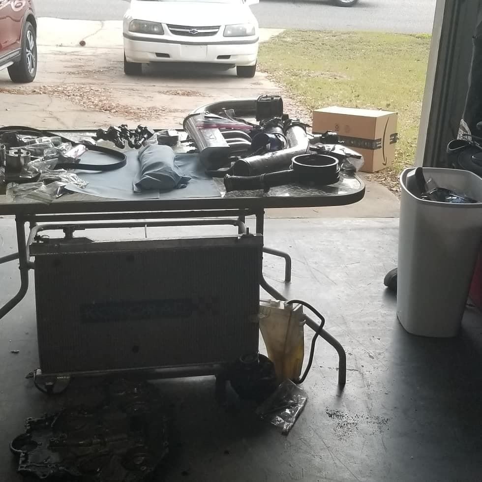

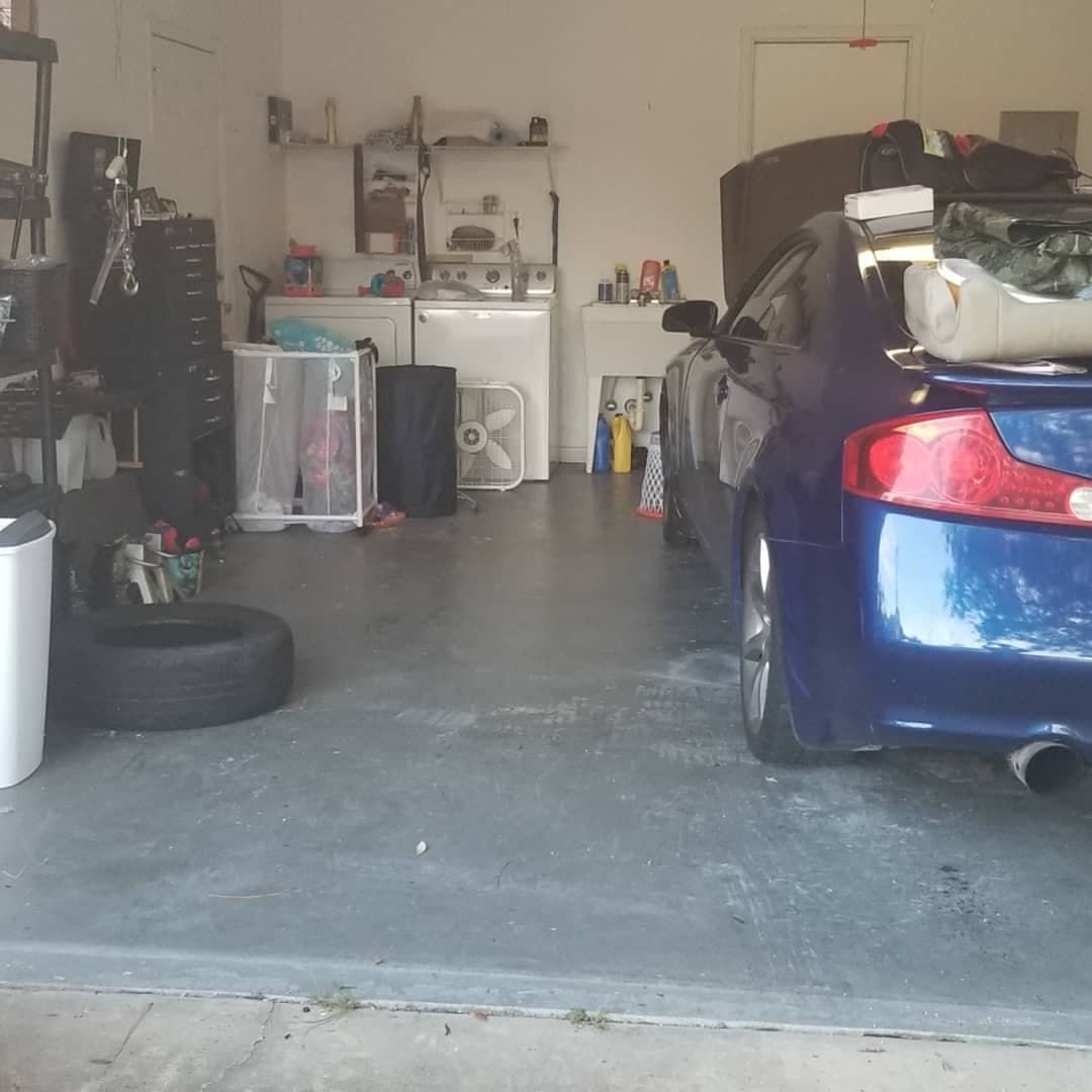

Over due update sorry.

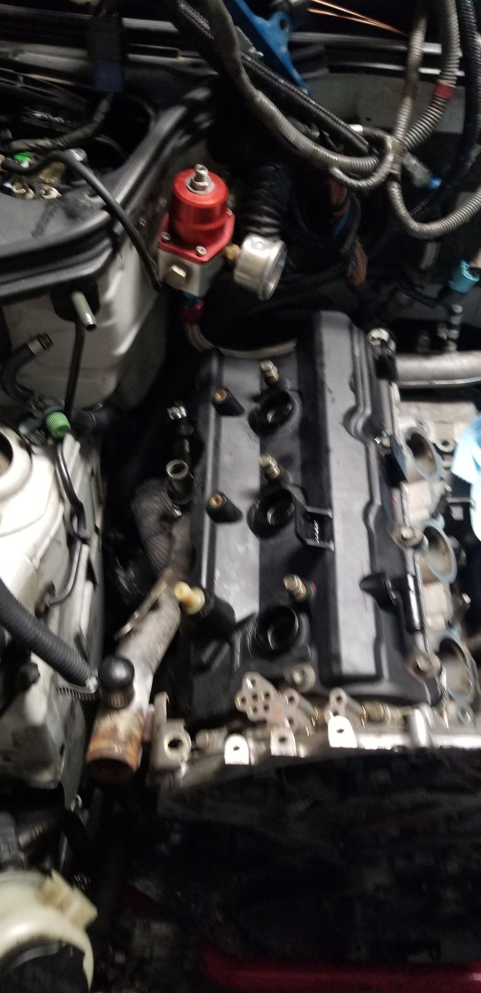

Start tearing the car a part sunday.
First step is to clean the garage so you have a place to put all your parts once you're done.
End of day one, didn't get a a whole lot accomplished.
Almost have the driver side head ready to be pulled. Cams are removed just put the valve cover on for the night to keep it clean.

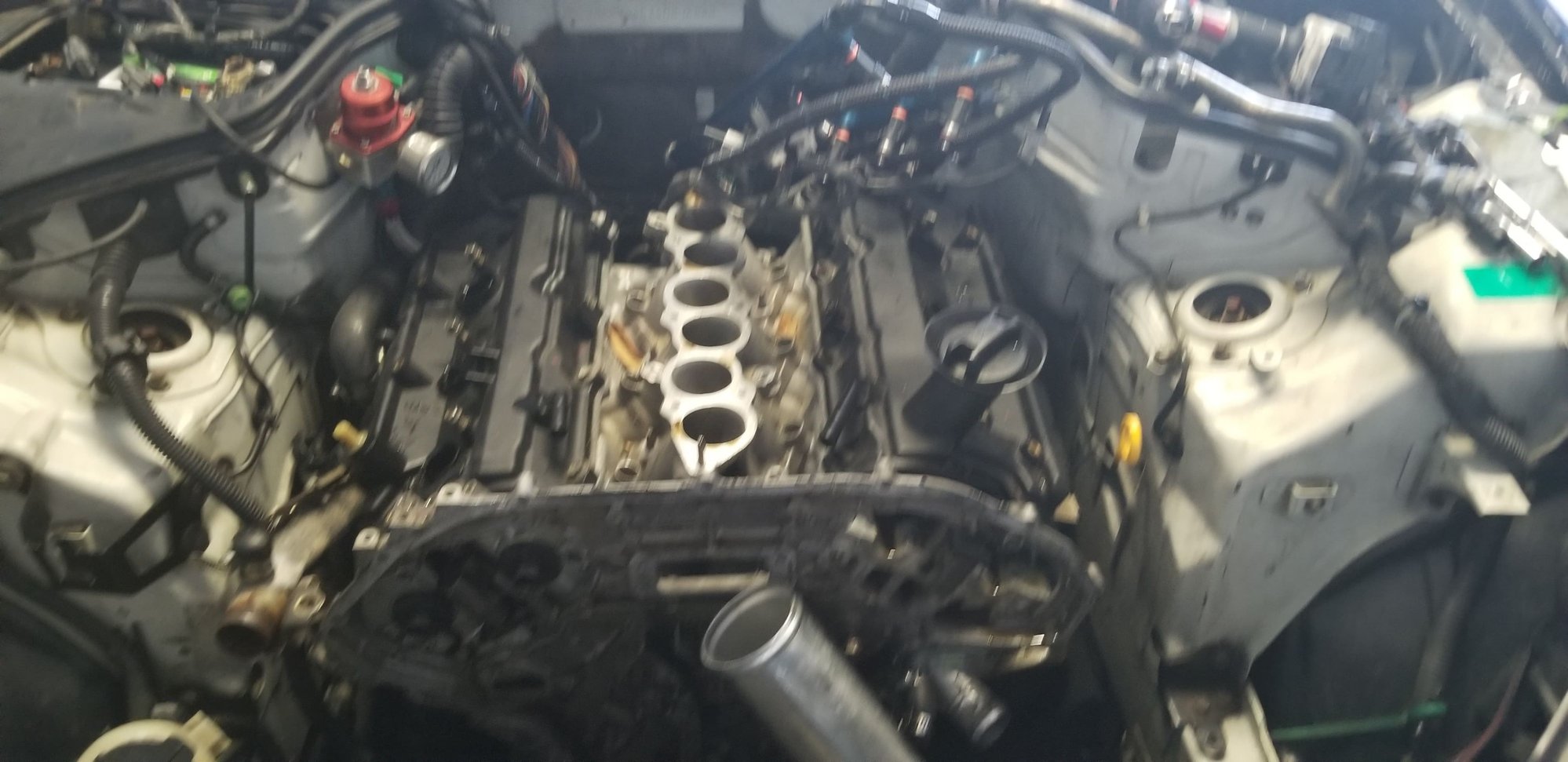

Finally got back around to tearing into it tonight.

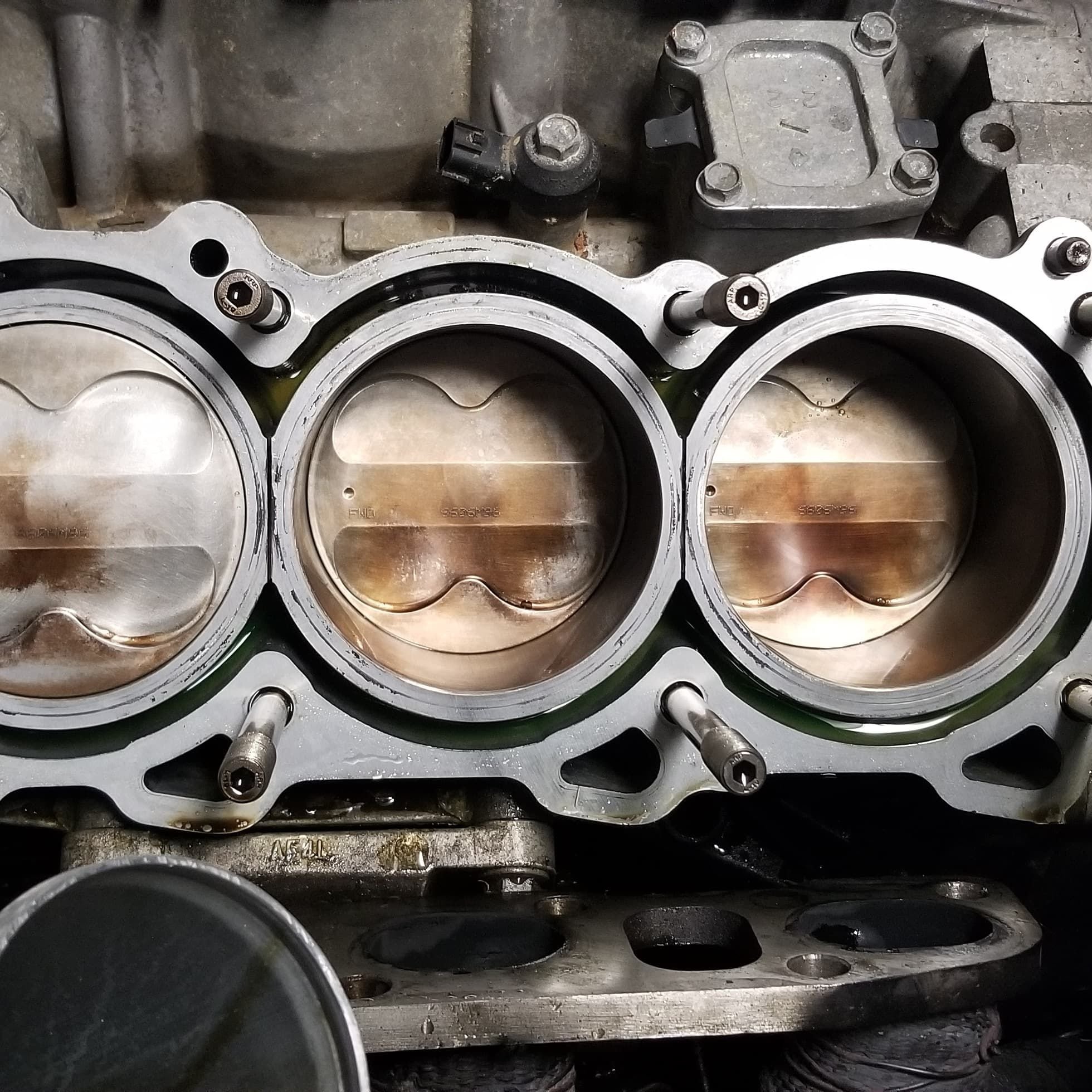

I cleaned up all the coolant inside the cylinders, and everything looks good to me and my novice eyes. I don;t see anything odd on the heads either indicating a leaking headgasket but i'm not exactly sure what i'm looking for either.
This is all i have left, thankfully it's not like anything important is in the way.....FMLd
A few notes:
One scale of 0-10 i would say so far its been a 4. A decent amount of room to mess with stuff on the driver side. I'm thinking the passenger side will be an 8, it looks like there is no room on that side. We'll find out more in a few days once i get time tear back into it.
I also think, my heads weren't torqued down to 90-95ft lbs like ARP recommends. I was able to break them loose quite easily with a 2ft breaker bar. I'm going to get a 2" 1/2' drive extension for my torque wrench and set it to 90ft lbs to see if they are actually torqued to the correct specs. Yes i know you can't "verify" torque, but if i can turn it lets me know it's torqued to less than 90ft lbs.

Deck looks good on drivers side. What does the head Gasket look like?
It's Does NOT look like any Rupture of the seal, as you would clearly see it.
What about the Passenger side?
Who said you had a blow Head Gasket?

I'll post a picture of the head gasket tonight, but nothing looks odd to me. Its slightly deformed and doesn't set flat anymore.
The heads have very clean head gasket mating circles. It doesn't appear to have been leaking on the driver side.
I haven't pulled passenger side, i'm only capable of working on it here and there for a few hours. Hoping to have that head off friday.
I think i blew the head gasket because after i did the 4th gear pull the car started putting out very very white smoke. I also noticed that the radiator was basically dry when i got home. I had the green ooey gooey stuff under my oil cap as well so i have coolant and oil mixing.

I think reinstalling the heads is a step in the right direction even if the symptoms didn’t necessarily 100% pinpoint a failed gasket...you could chase this issue until you’re blue in the face.
If it was me, Conway, I’d have the block inspected for flat-ness (even if you have an experienced engine builder inspect it(not sure how to accomplish this with the engine still in the car?) and I’d have the heads machined...you just never know and you’re this far into the engine.
I can only assume you're putting new head gaskets in it?
the HPA guys say don’t use copper gasket spray as it can create inconsistencies that could effect sealing. I'll probably do a light coating my next go-round. We'll see...

You should absolutely check the Deck & Heads for flatness.
Get a High Quality Straight Edge, a Short 1 and a Long 1
Check in both directions every few inches. If you can Fit anything over a .004 Inch Feeler Gauge under it in any area, they need to be machined.

Top and bottom no idea which one is which though. :-(
This is driver side still.

I almost think, knowing what you've presented thus far (head studs not quite to 95ft-lbs, white smoke under load) that you have a failed joint based on clamp. Meaning on vac and low load the headstuds were holding fine but as soon as you put some load on the engine and you had higher cylinder combustion pressures the force wasnt in the headstuds to completely seal the heads & block.
