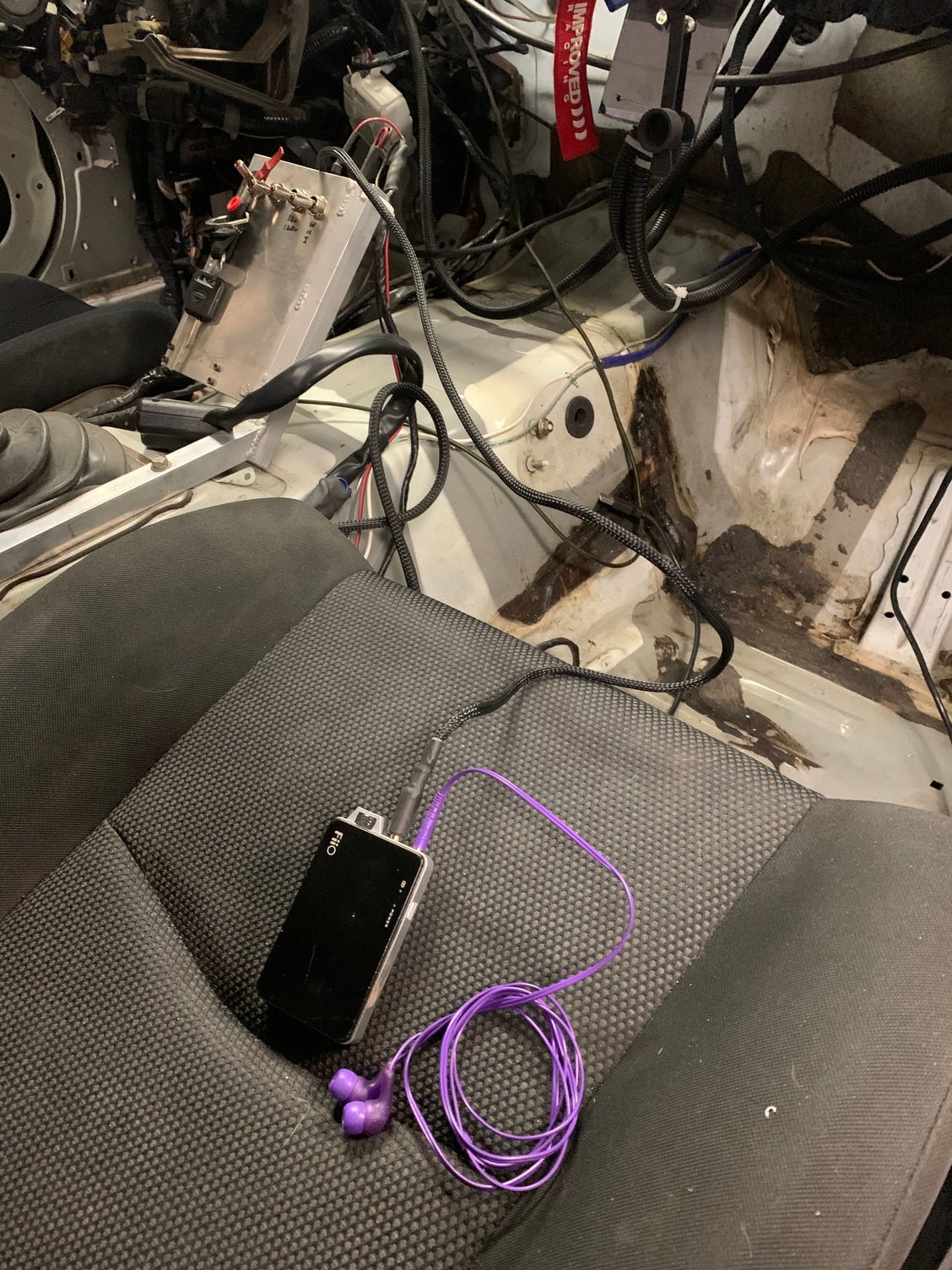

Is the knock heard quite easily?

If you need another knock sensor subharness I have 3 of them sitting in a box...also, since it's out, you should wire-in the Uprev listening device. Equivilent to the Plex Knock-Block, ie 'det cans' ... actually pretty cool, you can listen to the engine. When I run my car, especially if I'm planning on running it hard, I have plug headphones in hooked up to mine. Basically listening for knock.

You cant hear it without an amplifier but yea, you can hear it
Some good audio recordings of knock ...
https://theknockbox.com.au/the-knock...nd-recordings/

That sounds insane. There is no doubt you can hear knock.
