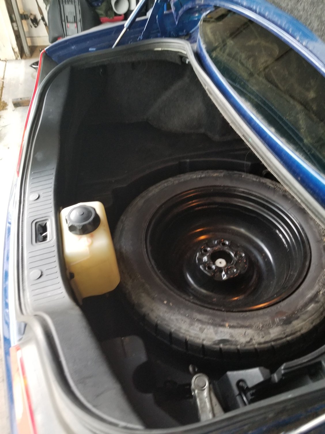

Decided to mount the reservior on the back of the trunk, this give me the best location to refill it, also allows me to keep my spare tire.

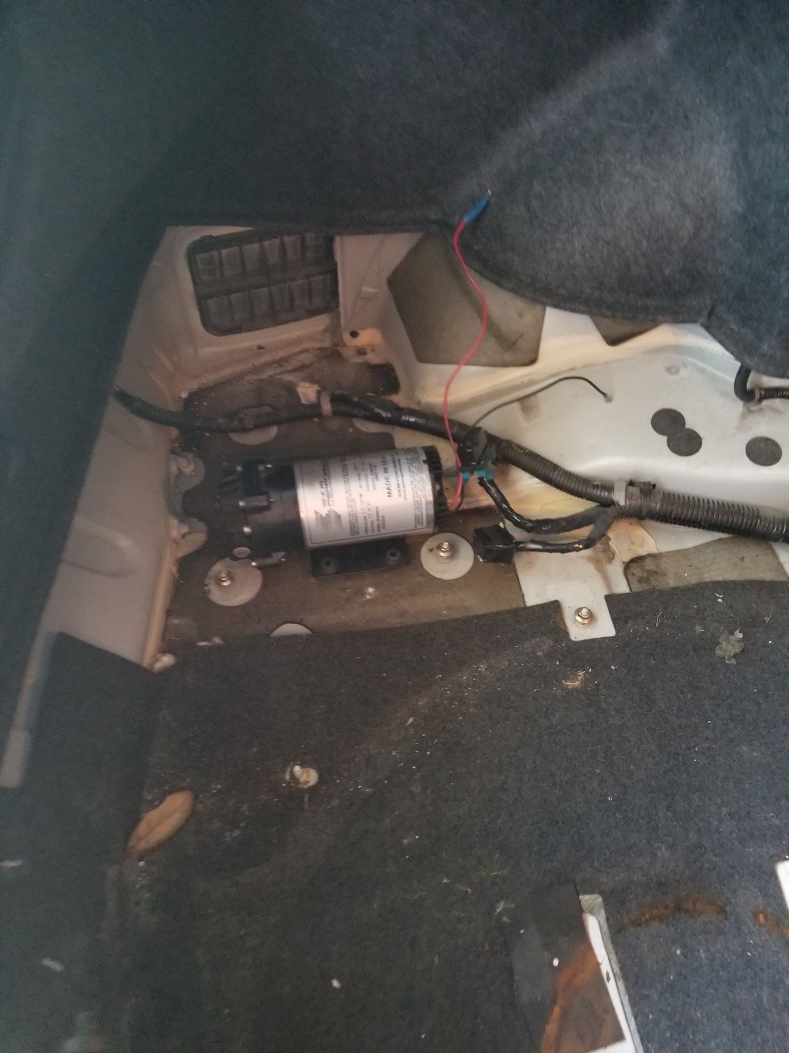

For those who don't know on G35's they have this false bottom trunk thing. This is where the OEM Bose amp was located. Since the previous owner put an aftermarket stereo in here figured I didn't need the amp anymore.
This is what the false bottom cover thing looks like with the pump under it.
As much as i don't want to I may end up cutting the plywood thing so it can set over top of this giving me a usable trunk in case i need to run the store and take someone to gapple bee's at the same time.

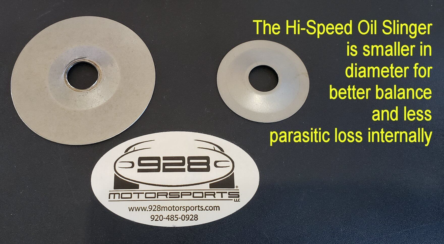

These Pictures are from 928 Motorsports.
The purpose of the oil slinger is exactly that, it pulls the oil from the "reservoir" and slings it through the case to lubricate the bearings and gears.
The OEM gear is known to fail, and if you don't catch it quick enough it can destroy the gears ruining the entire blower. Thankfully I think i caught mine quick enough and didn't notice any damage on my gears.
I will be upgrading to their smaller one. Since I will be spinning the blower at 70K+ and it's made with better materials.

The only thing that makes sense to me is, since the slinger is thin (1/16th inch maybe) it doesn't have enough material withstand constant changes in speeds and it slowly eats the inside of the slinger. Then once it get a little wiggle room is exacerbates quickly.
The slinger is spinning about as fast as the impeller so on a normal drive its going form ~27K rpm (Engine 4000 rpm) to 15K rpm (Engine 2500 rpm). Now if your racing it and you completely wind out your gears that little thing is spinning 60K+ that is a lot of inertia to be stopping.
928 Said it is a very common problem with the V3, so it was just a matter of time before it went.

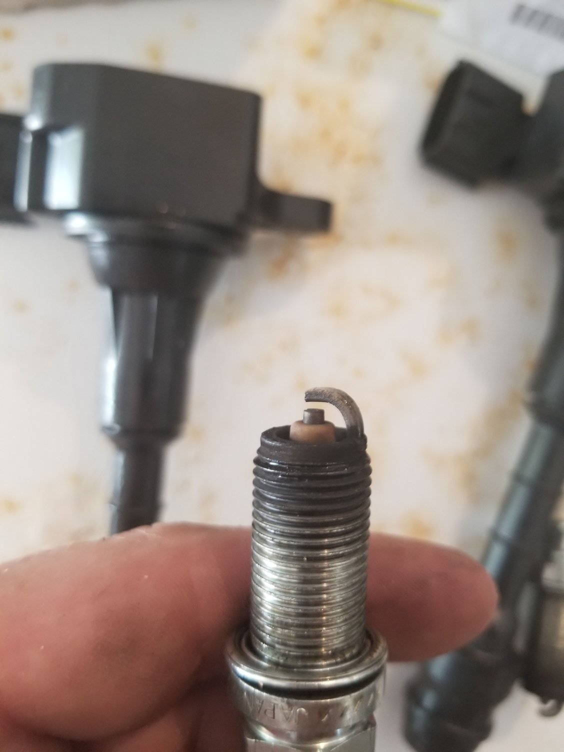

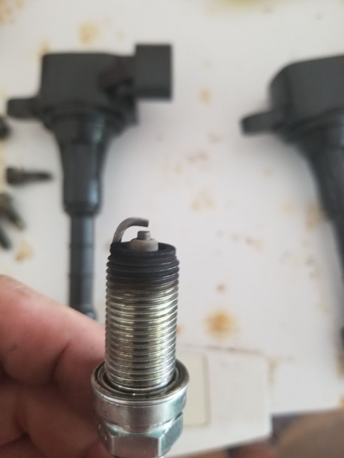

I put in Denso Iridiums and gapped them between .035 and .030. Can't find my dam feeler guages so had to use one of the gappers i have. No its not the dookie one everyone has.
How do these look? Still can't read plugs very well.

how are you detecting mis-fires? CELs? butt-dyno? haltech?
Plugs look slightly lean but not horrible ... what's worse - fouled plugs due to excessively rich or lean plugs? Pick your poison!

The car would buck and you could hear pop and bang. I only did it twice and knew it wasn't a mistake there was something wrong.
I would think lean is worse, lean = heat, heat = melting.
