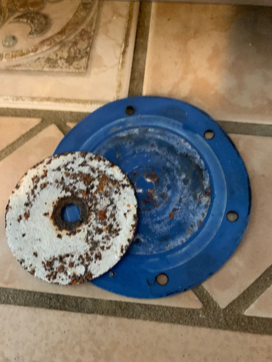

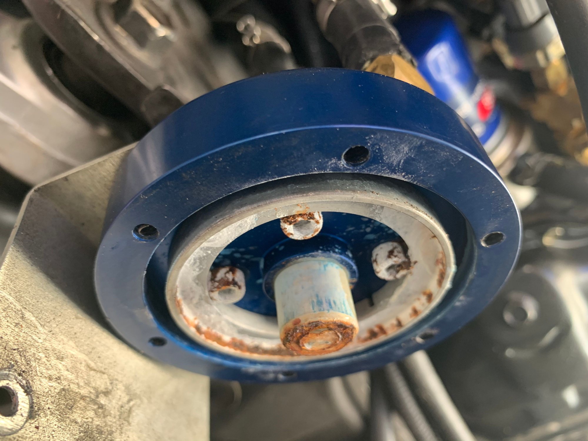

Tim,
Sent you these. Anyone have any idea what the hell could have happened? I even cleaned the diaphragm off a bit before the picture. I‘m taking the whole thing out to see how it failed....
WTF!?
Old Aug 23, 2020 | 12:22 PM
OldManZ350's Avatar
OldManZ350
Posts: 2,429
Likes: 230
You are Right!
FMU is Bad. It’s from moisture in the Fuel.
You can clean the corrosion out, and get a rebuild kit. Try SuperchargersOnline for a better price.
Kit comes with all new insides.
TimRod

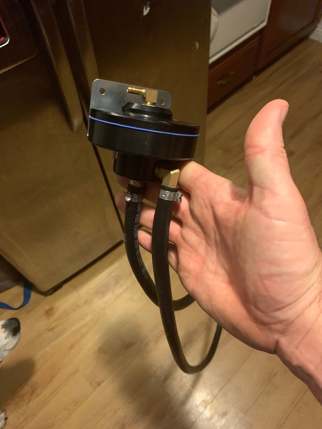

Old Sep 1, 2020 | 01:54 PM
Scojoturner's Avatar
Scojoturner
Joined: Feb 2019
Posts: 44
Likes: 17
From: Yorba Linda, CA
Special thanks to Jamie at Vortech for getting me a new FMU and getting her ripping again. 11.5 AFR to redline!
