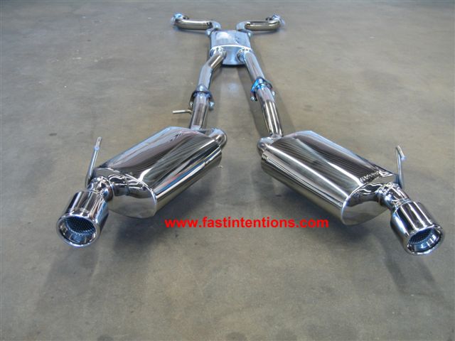

Thumbs up Fast Intentions Intimidator Exhaust TD
Group Buy going on now!!!
Threads located at:
https://my350z.com/forum/intake-exhaust/180725-i-was-the-test-car-and-wow-good-news.html
https://my350z.com/forum/vendor-group-buys-115/
http://g35driver.com/forums/showthread.php?t=91857
And the website at:
http://www.fastintentions.com
