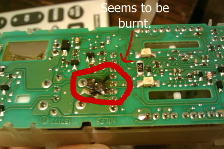

Im having trouble with the driver side i bought both new motors pass. side works drivers side not working i tired looking at the pins as Jay z has described and nothing. Tired the drivers side old motor nothing tried the pass. new motor on drivers side nothing! Could it be the main switch if so any idea on the price?
Anywhere else i can look?
Im Stumped!
Old 11-20-2009, 11:27 AM
  #274
skunk281
skunk281's Avatar
Join Date: Sep 2007
Location: San Antonio,Texas
Posts: 70
Received 0 Likes on 0 Posts
well after trying Jay'z method i ruled that out and after trying this motor here that motor there. I opened the main switch box and discovered what seems to be a burnt circuit board not sure here are the pics you tell me what you think.

Skunk, +1 on that board being burnt. It sure looks that way...
