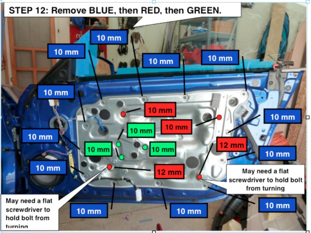

One more official thanks for the DIY on the window motor repairs. I followed the directions and made a few mistakes along the way. I tried to improve MASTER VO7848's instructions...I've got a PDF file with similar instructions. PM me with your email if you want them. (I don't know if I can post the file?)
2003, with 20,000 miles and it's on it's 3rd passenger side window motor! 2 by the dealer and this one by me.

Default updated picture with socket size
just an example of the door view...I added socket size and some detail on the fasteners that may need a screw driver. Hope it helps.
Attached Thumbnails How-To Repair Stuck / Broken Window Motor ...-window-repair-door-view.001.jpg
