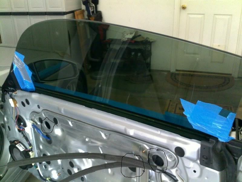

Old Aug 22, 2010 | 04:32 PM
  #315
usa_alex's Avatar
usa_alex
Joined: Oct 2008
Posts: 225
From: ohio
Default door
i think there is a easier way to work on the motor
here is the way i doo it
after the door panel is removed i remove the three bolts(10mm) circled in black in the pic that hold the window to the regulator.
after i pull the window out i remove the bolts(9 or10 bolts 10mm) that hold the metal panel with the motor and regulator on it, and have the whole thing outside of the car
this way you don't have the motor and the regulator just hanging in there
if you have any questions PM me or just post here i don't mind taking my door apart to take some pics
Alex
