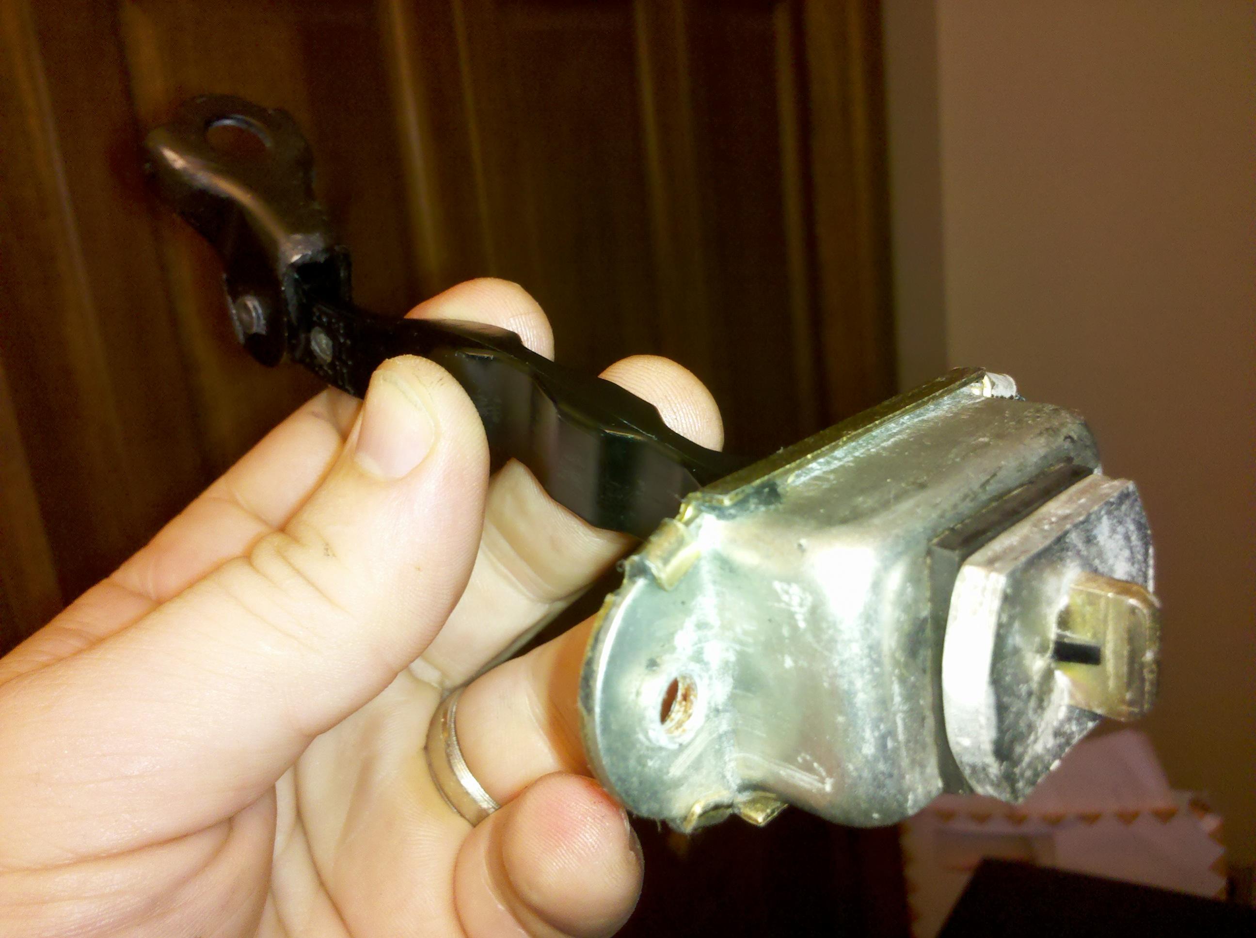

Got my new (significantly cheaper than my dealer) motor. Removed the old one and installed the new one. I was looking in the inner "well" of the door and found this contraption sitting down there. I don't see it in any of your pictures and it doesn't appear to have anything to do with the window mechanism. I didn't want to put the metal panel back on until I found out what this was.

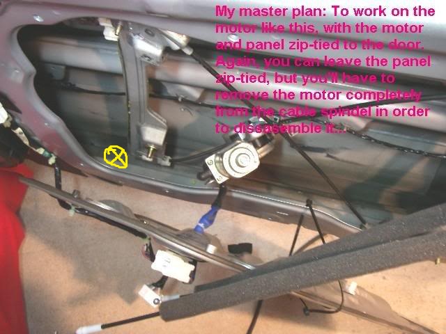

I copied one of your pix to use to indicate where I found this thing. It was right where I put the yellow X in your picture. Just laying there not connected to anything.
Attached Thumbnails How-To Repair Stuck / Broken Window Motor ...-img_20100905_163059.jpg   How-To Repair Stuck / Broken Window Motor ...-imgp3724.jpg

Looks like the door limiter came off. Don't know what it's called. Go look at your other door. There should be a top hinge and bottom hinge up front. You are sitting in the car and opening the door all the way and look towards the front of the door. In the middle there, there is a black metal slide that stops the door from opening too far and ripping the hinges right off. That looks like what fell off your door! Are there any bolts on that thing where you could get lucky and just put it back in? Not by my car right now...
