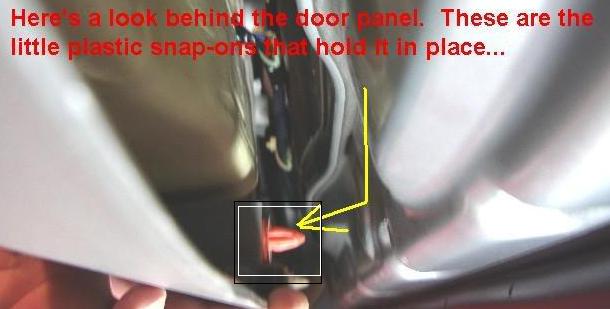

Vo, thanks for the writeup as I have been following for the drivers side. Replaced the motor and as of now everything works fine. Problem is, my previous owner obvious did a hack job replacing and left some of those plastic push pin things off when reinserting the plastic door panel. Any idea where I can find them and what they are technically called?
I see that they are supposed to remain attached to the door when you take it off, but simply push into the metal when reinserting.
Thanks,
Nate
Thanks,
Nate
You can pick them up at the dealer. They sell them in little bags. I forget the quantity you must purchase them in, but I had to buy some myself after breaking a few of them. The parts department can look them up on their PC. They'll have a door diagram.
