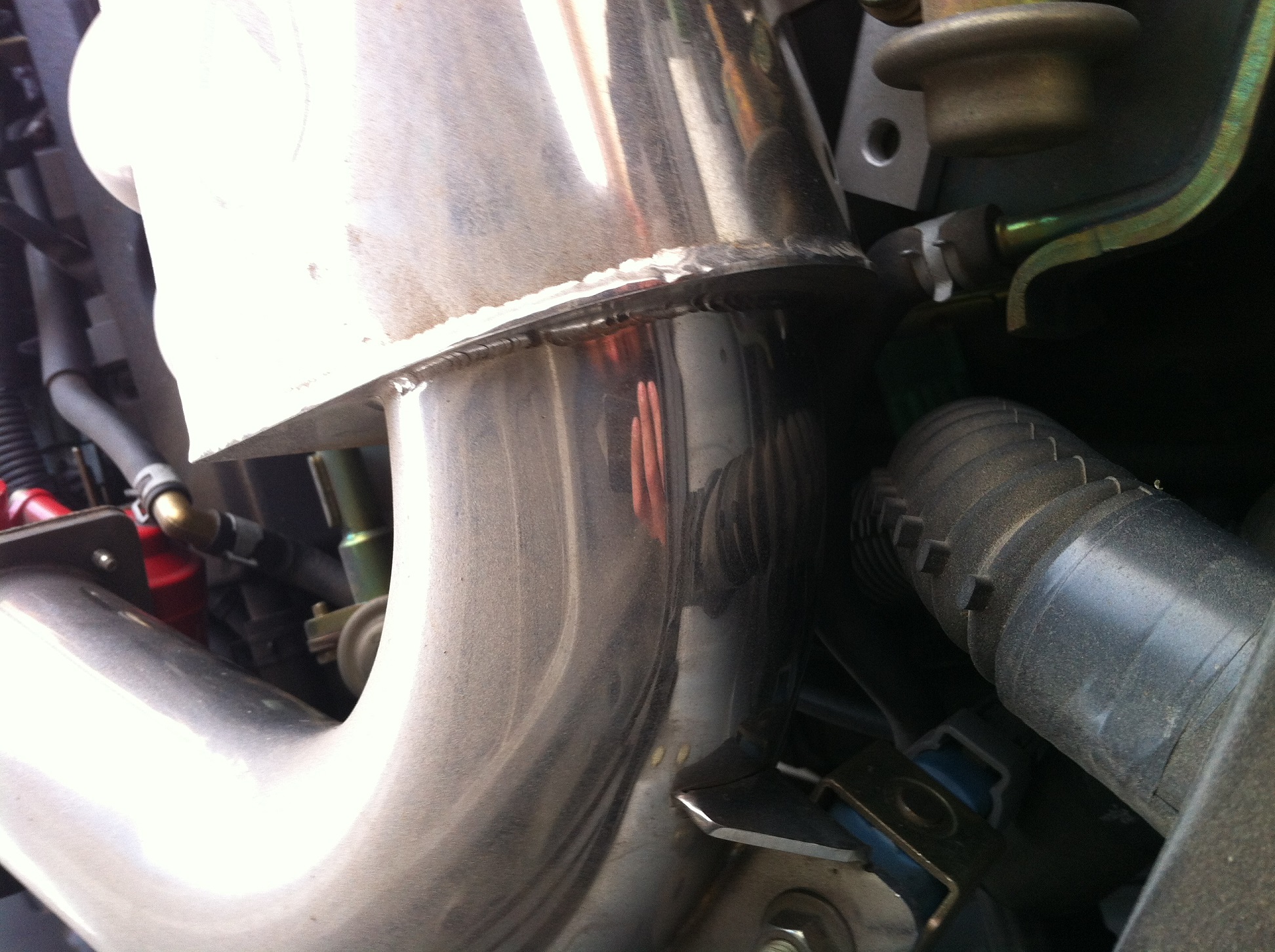

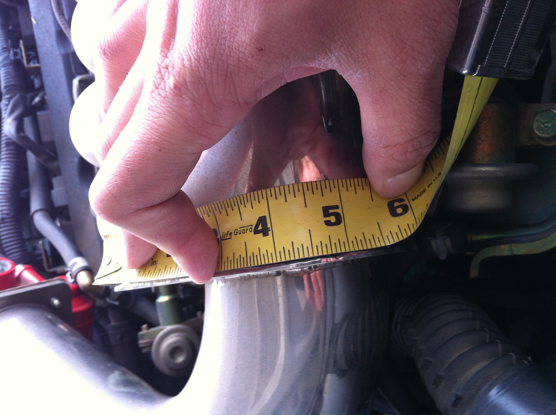

So I am thinking of using the Kinetix Velocity manifold and hacking the pipe off and using my own. I emailed them and they said it was a 3" pipe that connects to the plenum chamber. I am wondering if I could fit a 3.5" pipe. Might not be able to perfectly round, but what about squaring it off to the size of the end of the plenum chamber there? Anyone know the dimensions of that part or could get them? I may post in the intake section to see if someone can measure it for me.
Old Apr 1, 2014 | 01:34 PM
  #230
npr350z's Avatar
npr350z
Joined: Jul 2012
Posts: 967
From: way down in the valley
I have one on my car, I can take a look at it later tonight. I wanna say I measured it at 78-80mm once. Or do you mean the actual square bit on the Im where the elbow comes in?

That is an interesting idea. I was wanting to know the dimensions of where the pipe connects to the plenum. I don't think its perfectly square. It think its a weird shape. I like the smooth bend radius of the Kinetix manifold piping that comes into the plenum. I was going to try to replicate that with larger piping, but wanted to see if it would fit to plenum though. Kinetix told me the pipe is 3" and you could not go bigger. I was thinking I could it I form the pipe to match the shape and size of the plenum itself where the pipe connects.

I'll take some pics and bust out the tape measure when I'm off. Why not, if your cutting it off, extend the end off the intake manifold a bit, taper up and out at about 45 degrees for 1/2 inch into a 3.5" elbow if it's not large enough? Wouldn't be to hard with a mig welder.

Old Apr 1, 2014 | 04:59 PM
  #234
npr350z's Avatar
npr350z
Joined: Jul 2012
Posts: 967
pics attached.
Attached Thumbnails 87mm TB Project-img_0383.jpg   87mm TB Project-img_0384.jpg   87mm TB Project-img_0385.jpg   87mm TB Project-img_0386.jpg   87mm TB Project-img_0387.jpg

Thanks much for the pics. So that thing is pretty wide where it enters the plenum chamber. I did not realize it was that wide there. Plenty of room. I think I can make a 4" pipe somehow form to that shape. I will have to look into it.
Thanks again!
