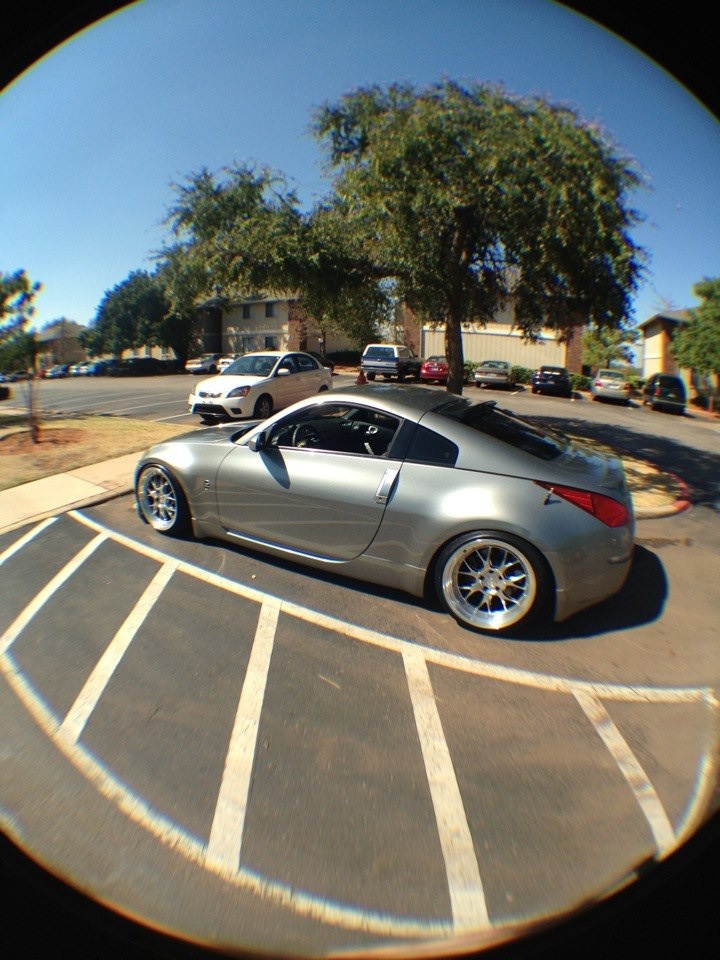

I have one inch wheel adapters and I have never had any problem, alignment or any vibration. I track and drag my z. 04 track 19x9.5/10.5 +12 with one inch adapters.

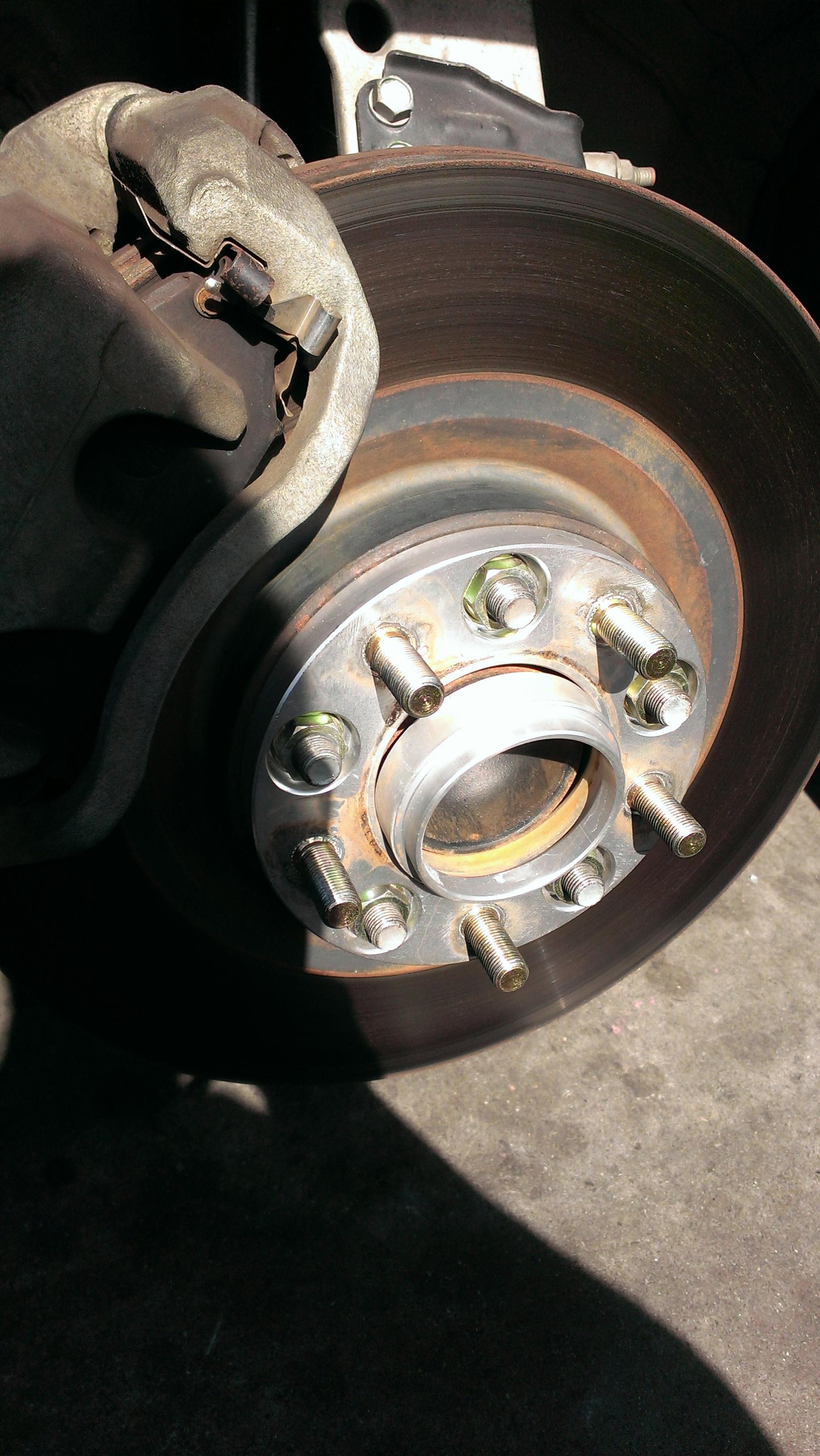

Sorry for the noob question but wanted to make sure these were hubcentric rings that are supposed to eliminate vibrations when spacers are installed with aftermarket wheels. When i install the wheel on the rings/studs, the rings don't stay put. I can see them move since my center caps are off the wheels. I can literally push them in, and then pull them out with my finger in between the center cap hole. Is this normal? I don't see a point to the rings if they can move. Would this have anything to do with steering wheel vibrations at high speeds?

That is a hubcentric ring for the spacer, yes.

^^Does it make sense that they move in and out while the wheel is installed?? I can stick my finger while the center caps are off and move the rings in and out. Doesnt seem like anything is resting on it or touching it. Doesnt that defeast the purpose?

Since you can move the ring I assume you aren't mounting OEM wheels. The hubcentric ring pictured above makes the spacer hubcentric to the OEM center bore, but, if you are mounting wheels that have a different center bore than OEM your set up isn't fully hubcentric. You will need hubcentric wheel rings like these:

Since I don't have that do you think that might be the reason for high speed vibrations?

Hard to say. Doubtful if you are using the right lug nuts and torquing them correctly in a star pattern.
