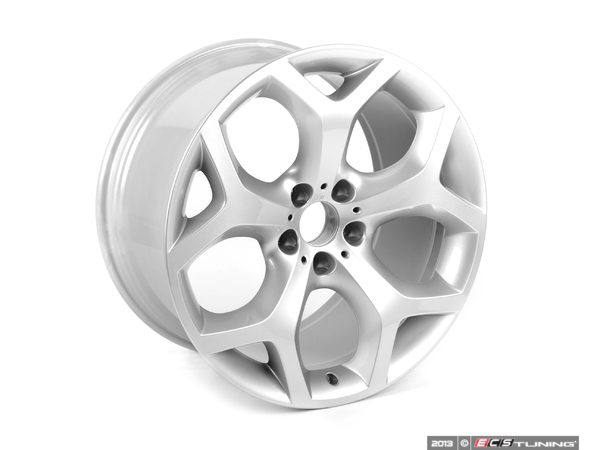

Hey guys I got an 08 350z. It has the stock 18" rims and I got a really good deal on some rims from a buddy that are 20". Ive never owned rims other than stock so I have no clue but in order for them to fit I need wheel spacers (from what I was told). The rims are BMW Ill attach a pic. Ive tried looking around but no success. Any suggestions on what spacers I need and any other useful information on the subject? Thanks !

Those rims you got are bmw bolt pattern. They won't go on your Z directly
You need a spacer/wheel adapter. Specifically ones that convert the 5x114 bolt pattern to 5x120. Without knowing wheel width and offset nobody will be able to say what thickness of spacer you need. BMW typically utilizes higher offsets than the Z so you probably need a thicker spacer to make it look good. Just a bad scene IMHO.
I recommend you ditch the wheels and see if you can get your $ back. It's more trouble than its worth and I think BMW X5 wheels would look like *** on the Z.
