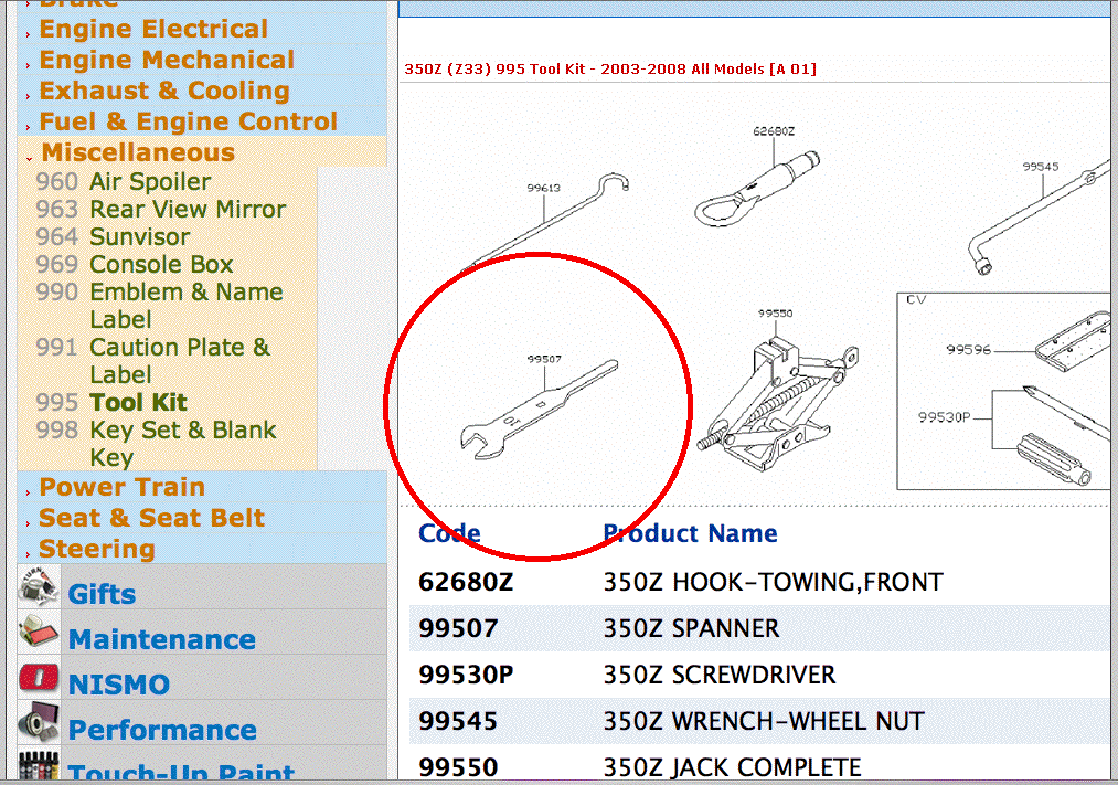

that little wrench in the trunk is that to take off that bolt
Old Apr 4, 2009 | 05:10 PM
davidv's Avatar
davidv
Posts: 42,753
From: Tucson, AZ
Apologies. Been driving the 350Z for 5 years but never used the spanner. Assume that it will remove the bolt.
