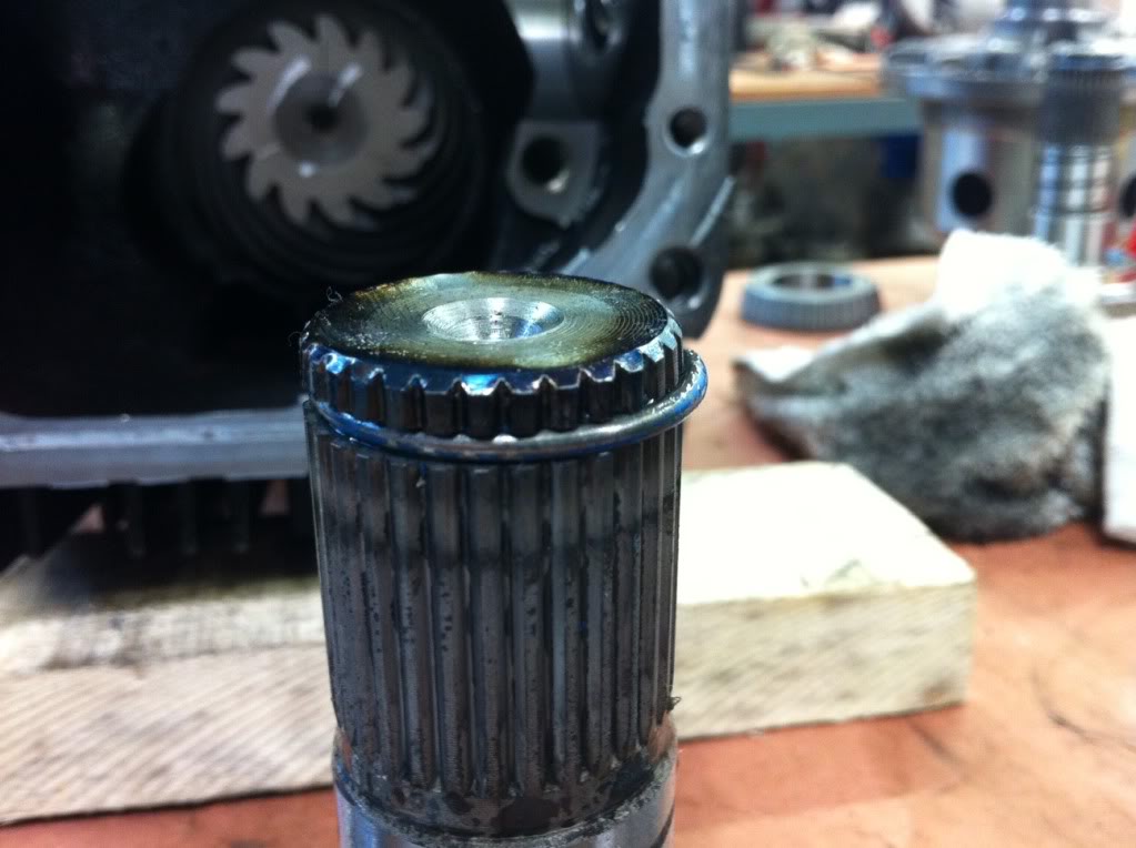

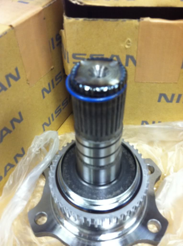

Good stub axle pix from Wavetrac

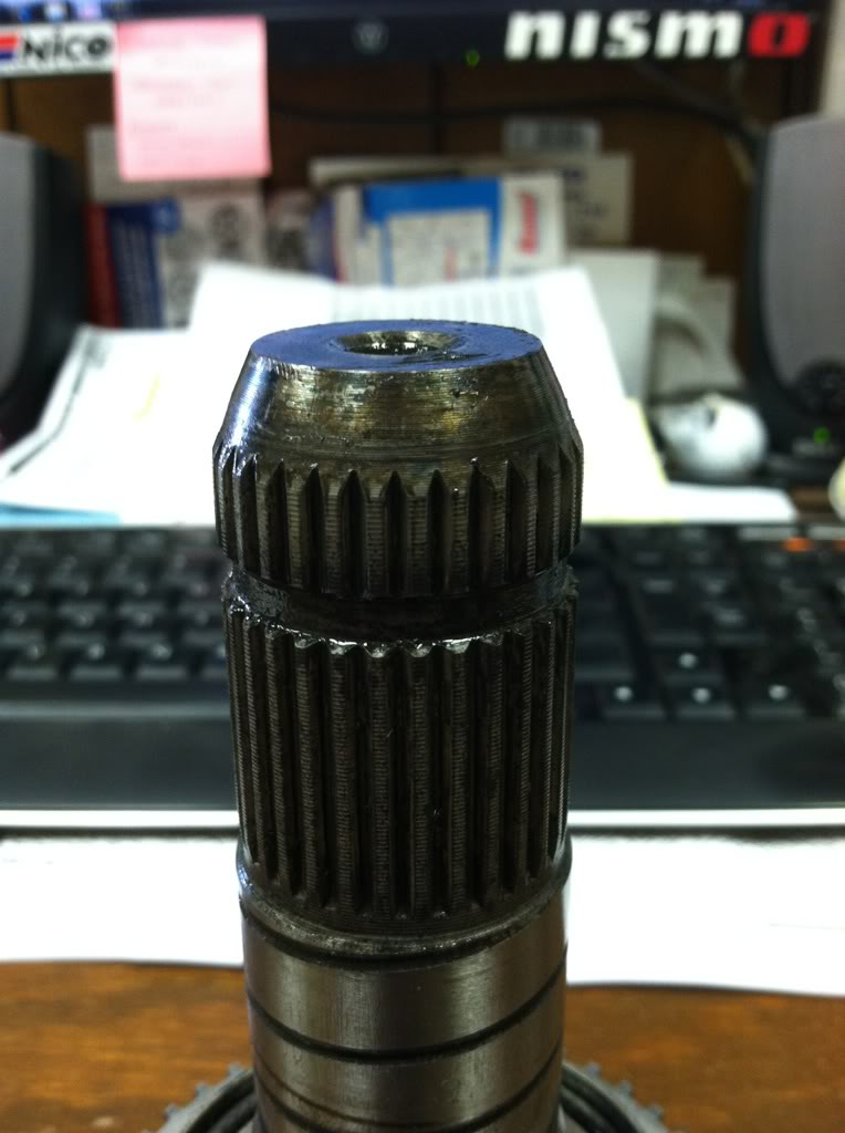

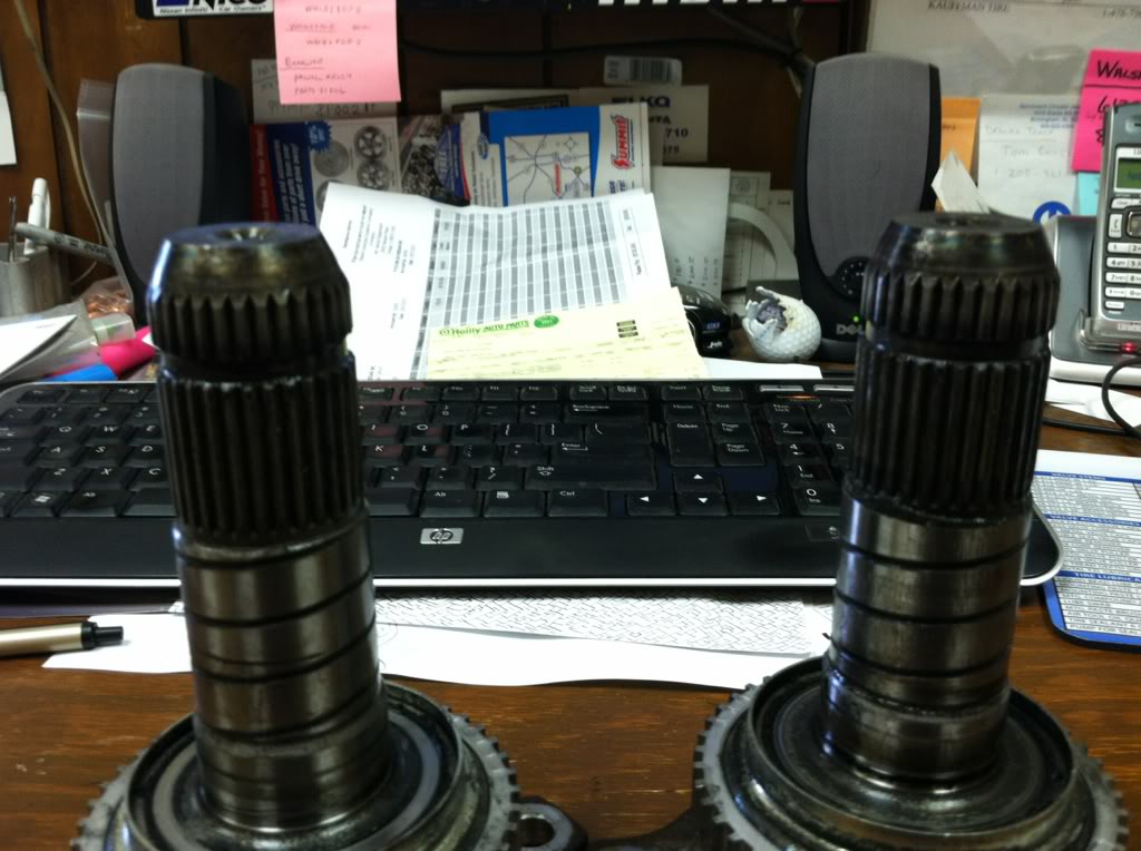

Pics of my 2007 base model open diffs stub axles

new stubs axles (2) in-the-house now...

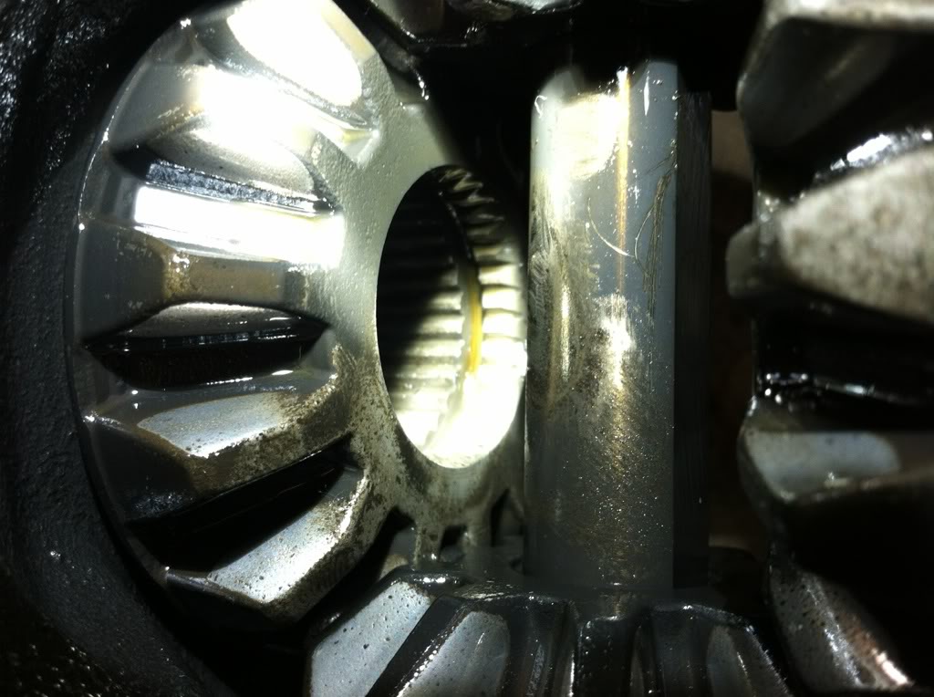

terrasmak...I think we have 2 separate problems...
My issue is that the axles will not slide completely into the WaveTrac diff...so the clips don't even com into play...the stub axles are too long...they are hitting something inside the Diff...
http://www.wavetrac.net/technical.htm
Laze, I bet it was just an issue of shaving/trimming down the stub axles, much like the Quaife requires you to do as well:
https://my350z.com/forum/engine-and-...tub-axles.html
The Wavetrac picture just looks like a shortened version of an OEM stub axle aka base model open diff stub.
Yup, it seems like yours needed to be cut for the c clips and the length shaved down to the VLSD short stub length.

The C-clips are fine, that is not the problem...the length of the axle is the problem
you need Qty of 2x VLSD short "un-modified" Axles and it fits perfectly!

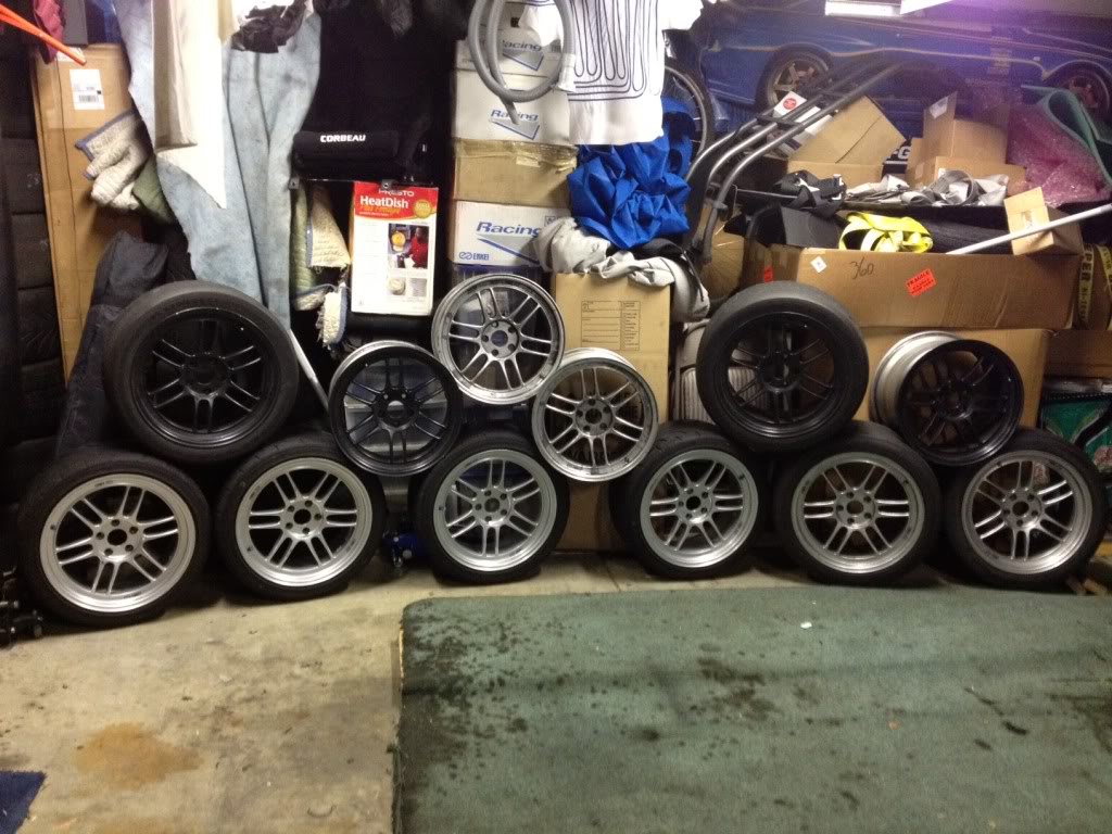

3 sets almost ready for SpecZ (six 9s and six 10s). Just need to get the silver ones painted black, then get the rest of the tires mounted up.

So, you are the one who scarfed up all the 18x9 RPF1s in the entire world???
Question: What offsets are you running?
All were used!
+35 on the 9 and +38 on the 10.

Are you sure the 18x9s are ET 30???
I can only find 18x9s ET35 new...
And what spacers are you running?

They are +35's. Scott bought the last set I had...
I knew I should of looked first. Sorry fellas!
