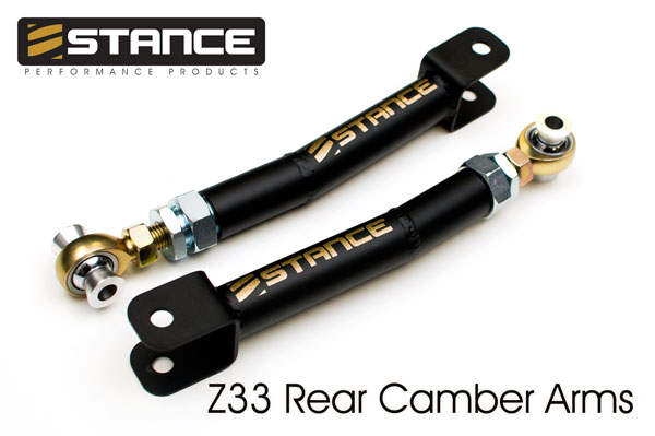

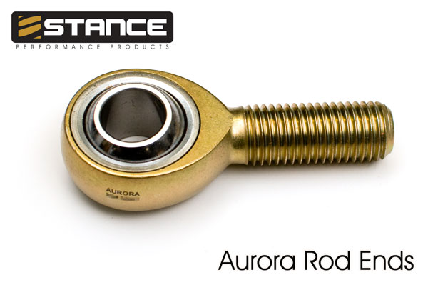

wrecker's Avatar
wrecker
Joined: Mar 2010
Posts: 184
From: vancouver
Default Aurora spherical rod ends
anyone had any experience or know about these rod ends?
these ones are on stance
the metal looks kinda thin..
Attached Thumbnails Suspension 101-stnc-z33-camber-arms.jpg   Suspension 101-stnc-aurora-rod-ends.jpg
