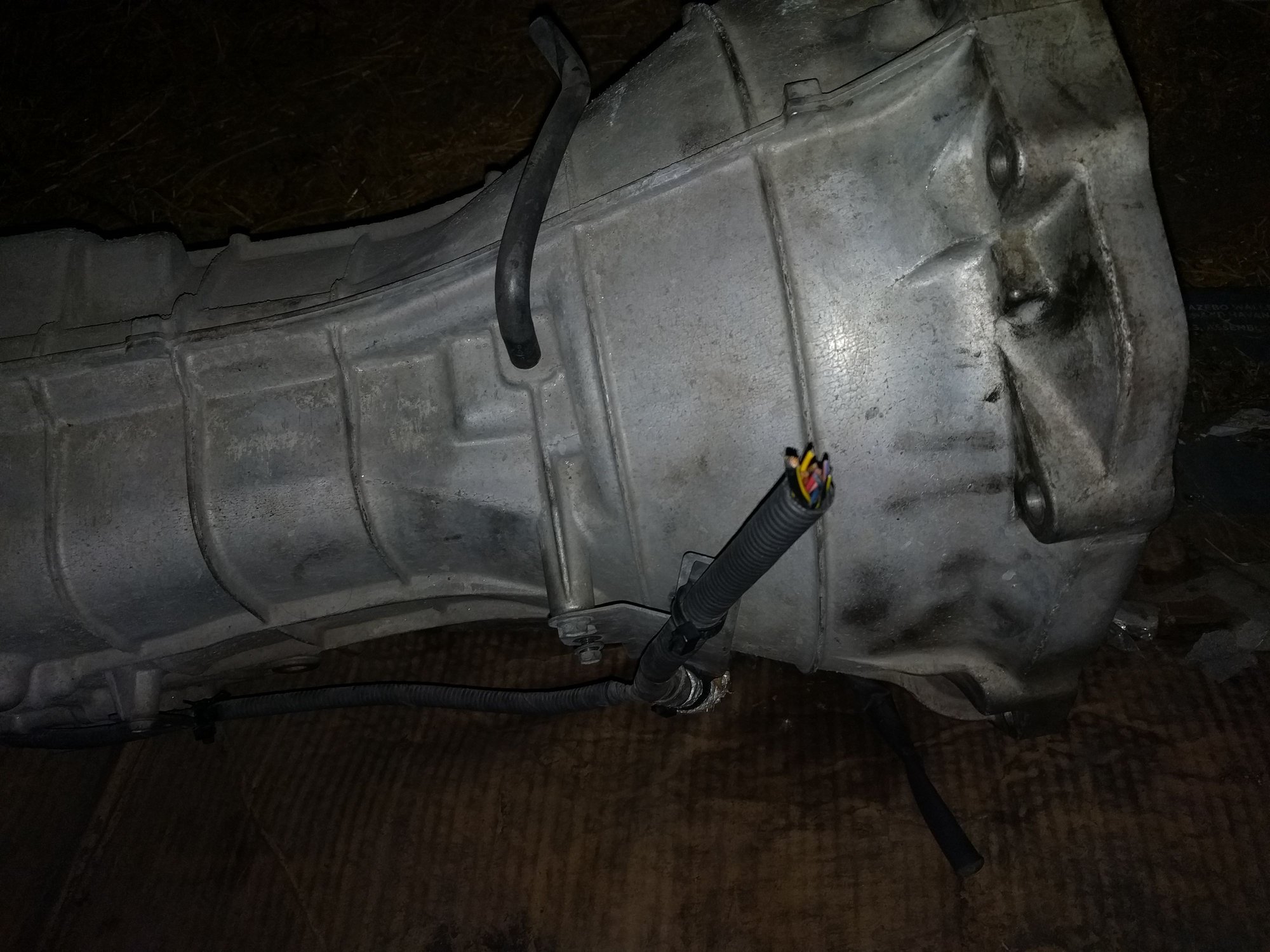

Just picked up a m/t to attempt this swap. Once I got home I noticed the harness was cut. How much of an issue will this present, not sure if I absolutely need anything wired up?? Thanks
Are there specific wires I need to worry about in there?

It doesn't matter as the harness is the one from your engine if you use MT engine harness... if you use AT engine harness, it will still works but you will have wires not connected and check engine.
