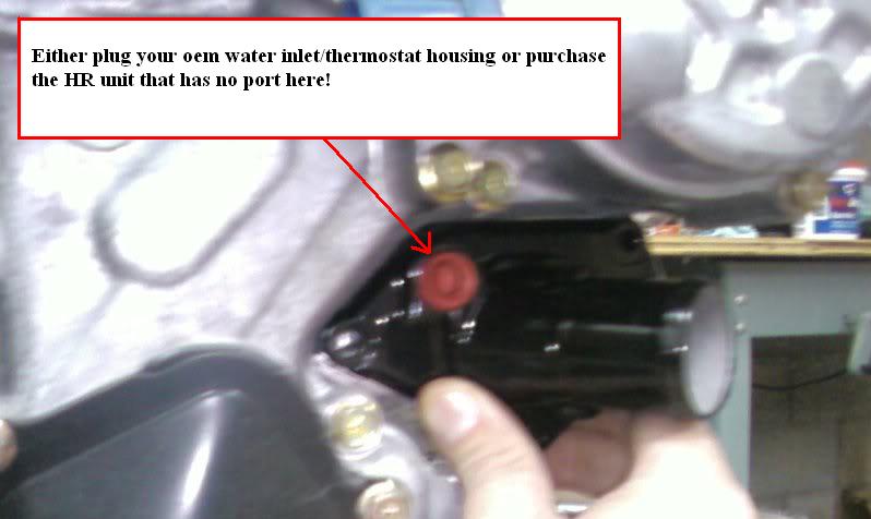

Water inlet/thermostat:
Replace with HR unit and no nipple will be there. OR thread and tap with an 1/8 NPT plug:
I will most likely just buy the HR unit.
