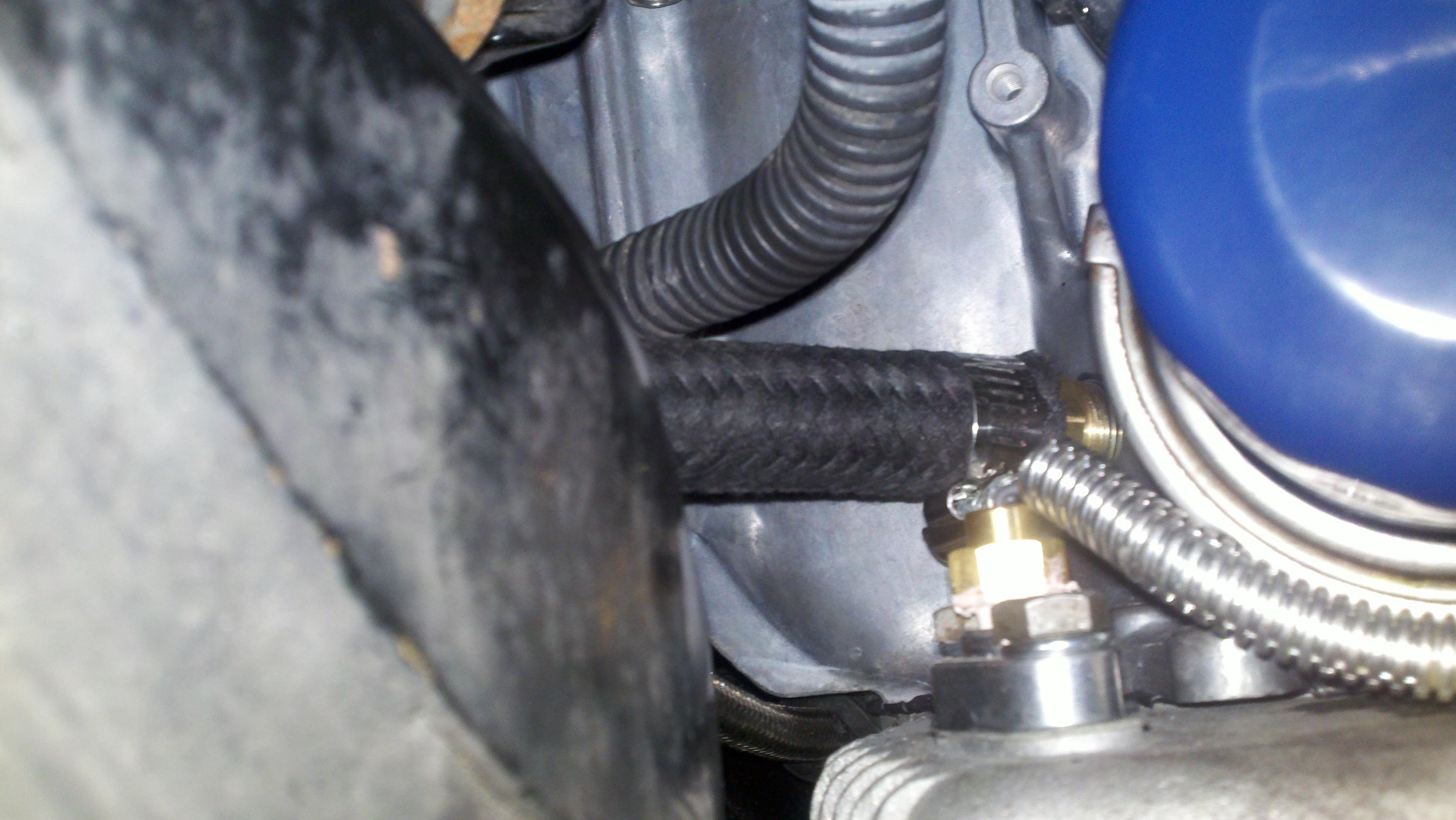

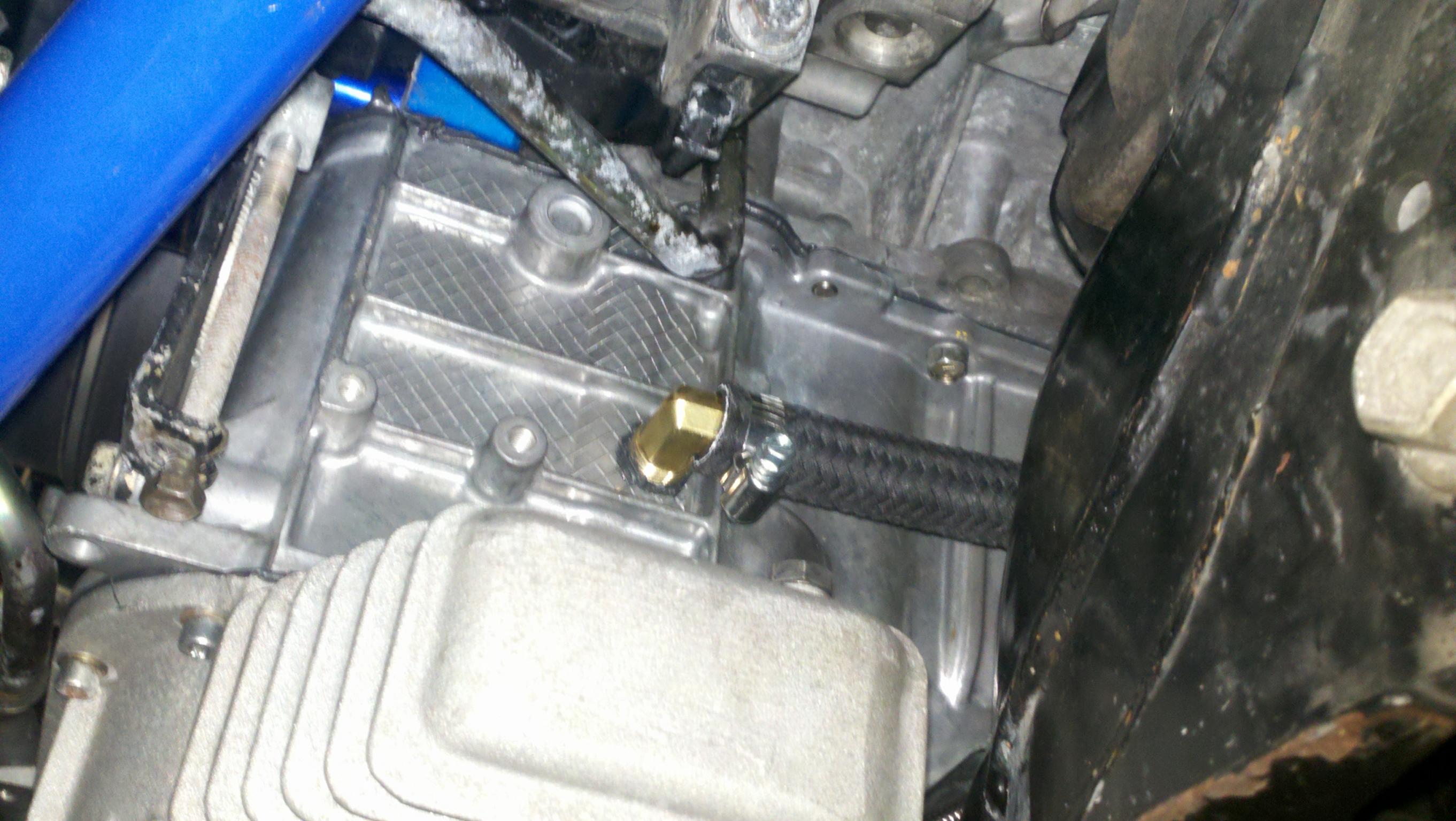

For Glex:
Drivers side: Cass007.... ver 5.0-2011-03-29_12-38-12_391.jpg Pass side: Cass007.... ver 5.0-2011-03-29_12-38-31_937.jpg
Just drilled and tapped the upper pan just below the windage tray and bought a solid piece to cover the the drivers side hole in the oil pan and a fitting that had the correct size/thread for the Defi oil temp sensor to go in the passenger side of the oil pan (you can see this in the second pic).

Let me know if you run into the smoking on deceleration.
Does it have enough downward angle for it to be gravity returned?

Will do. Yes, they have enough angle to be gravity fed and they should flow at least as well as the regular kit setup. Plus, these hoses shouldn't swell like the stock hoses did.
