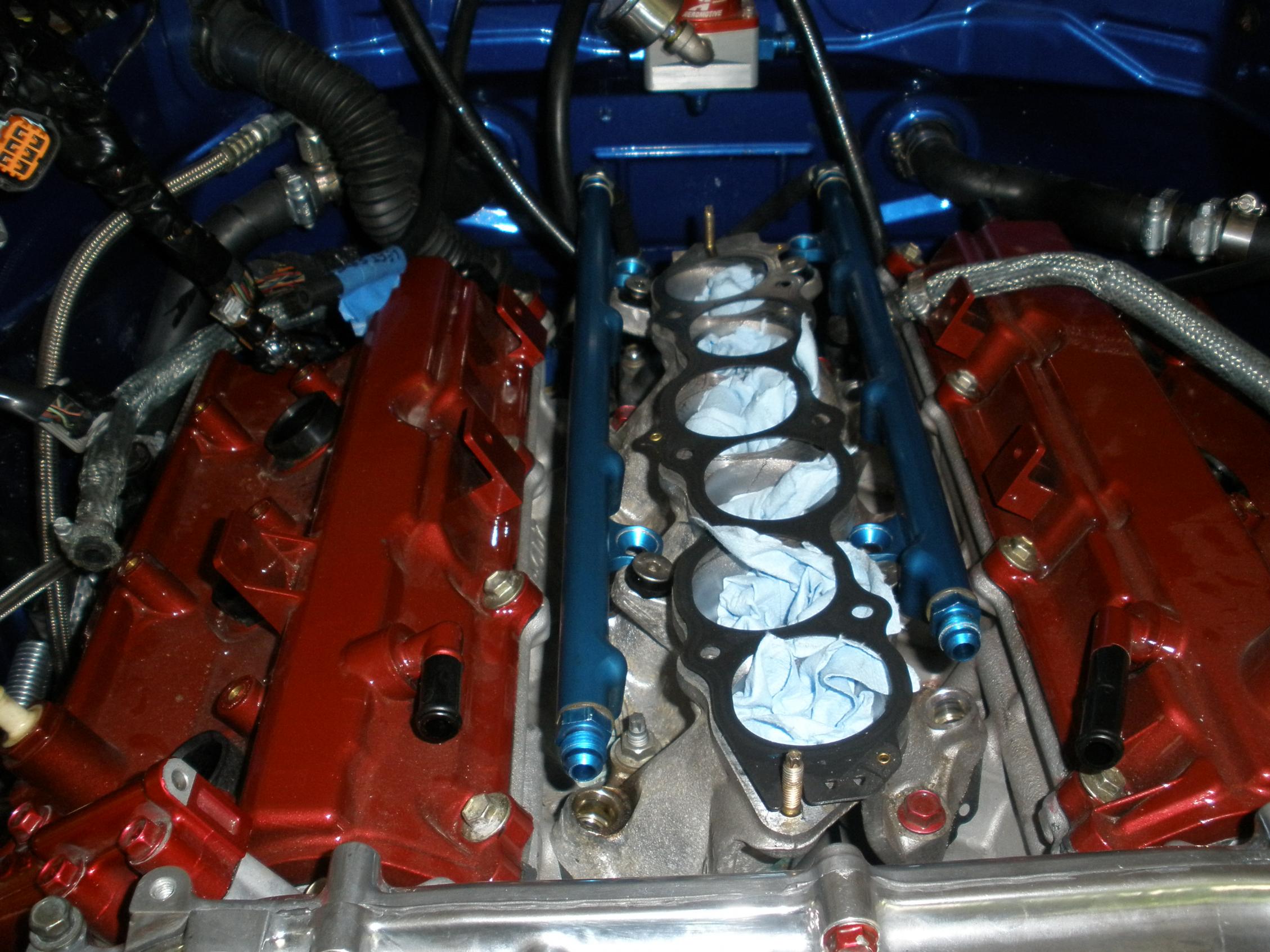

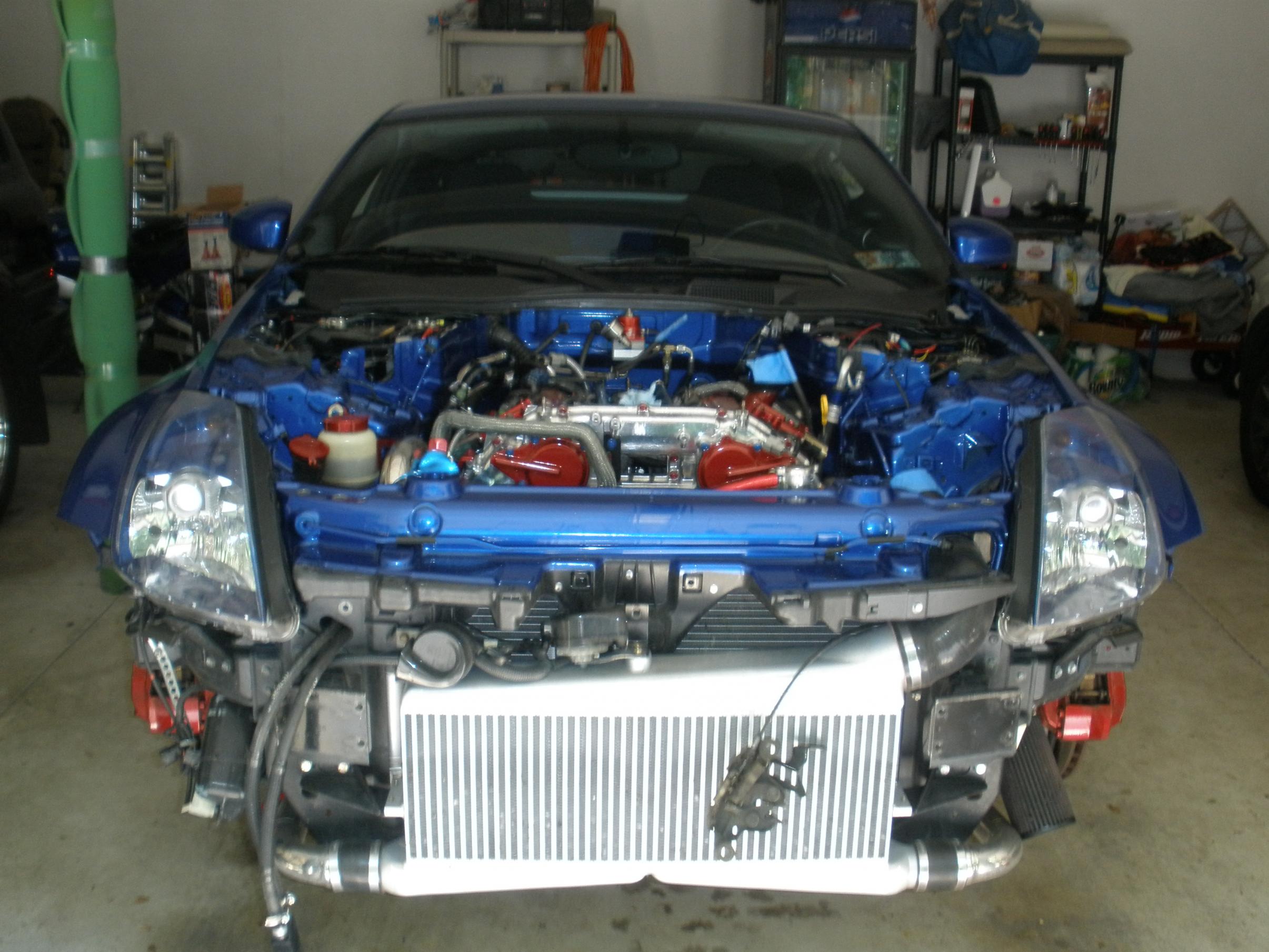

It Begins... this was the easy part.

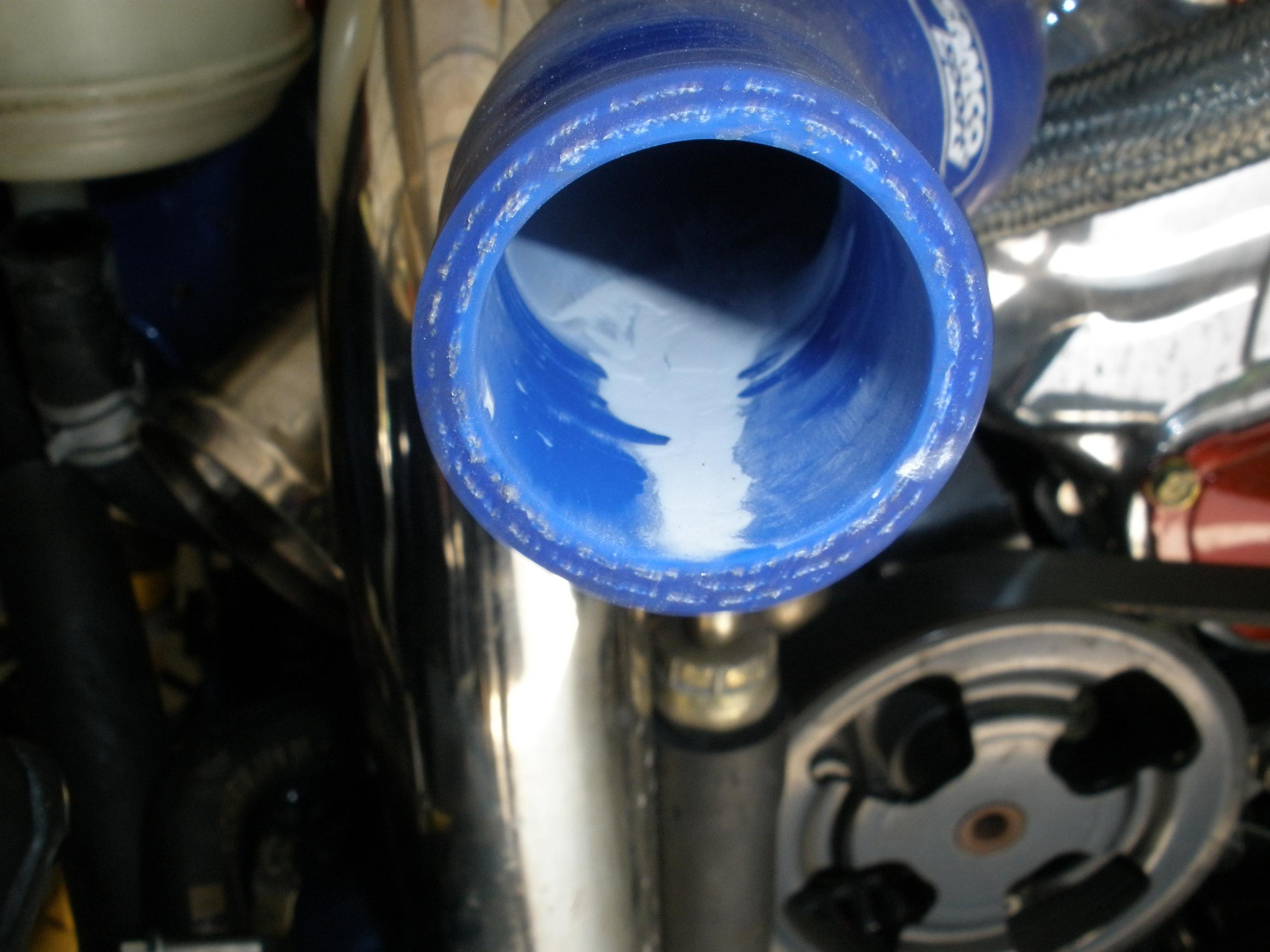

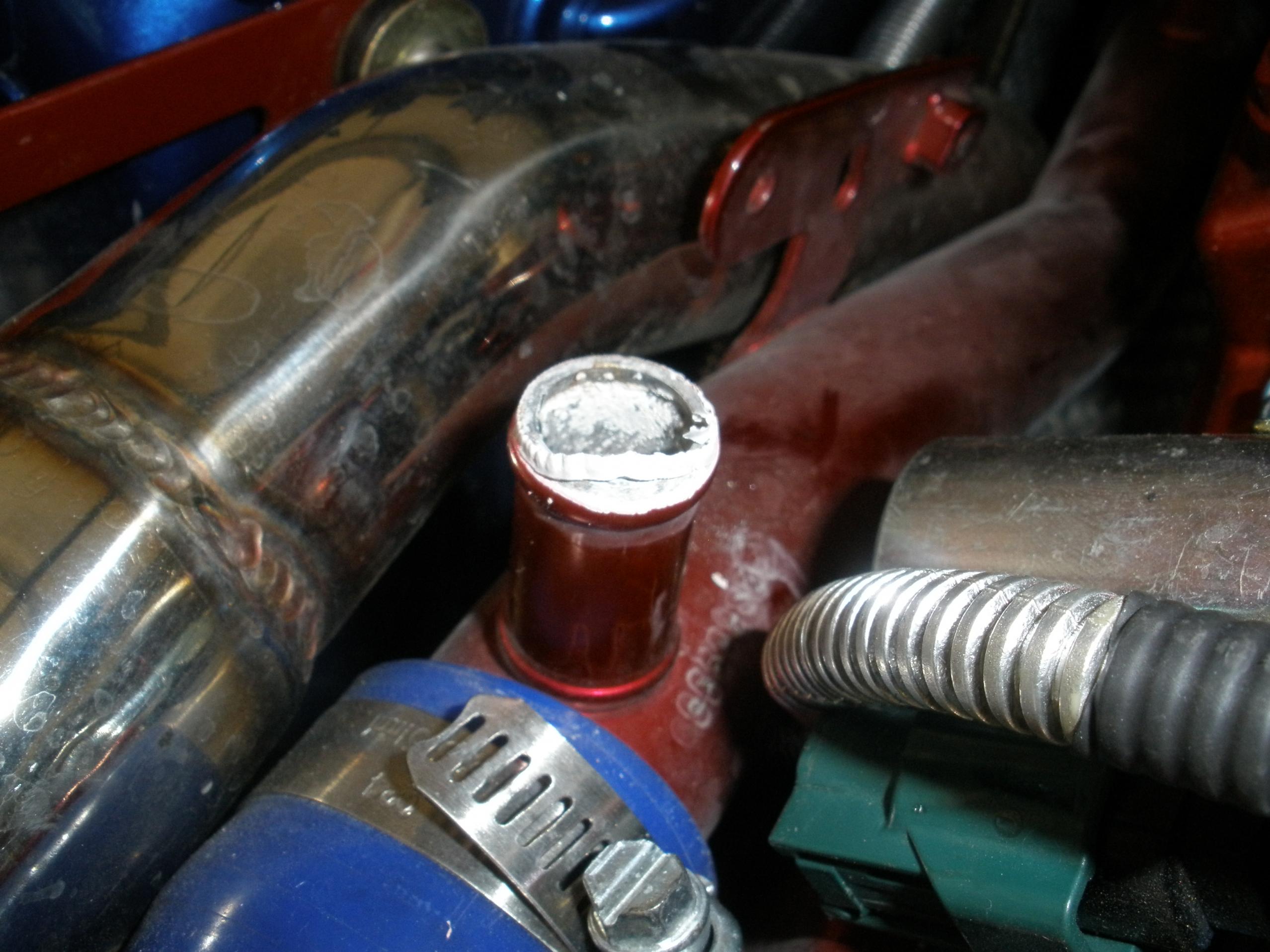

The coolant looked normal when I purged it, but the residue has dried into a chalky substance. Is this normal

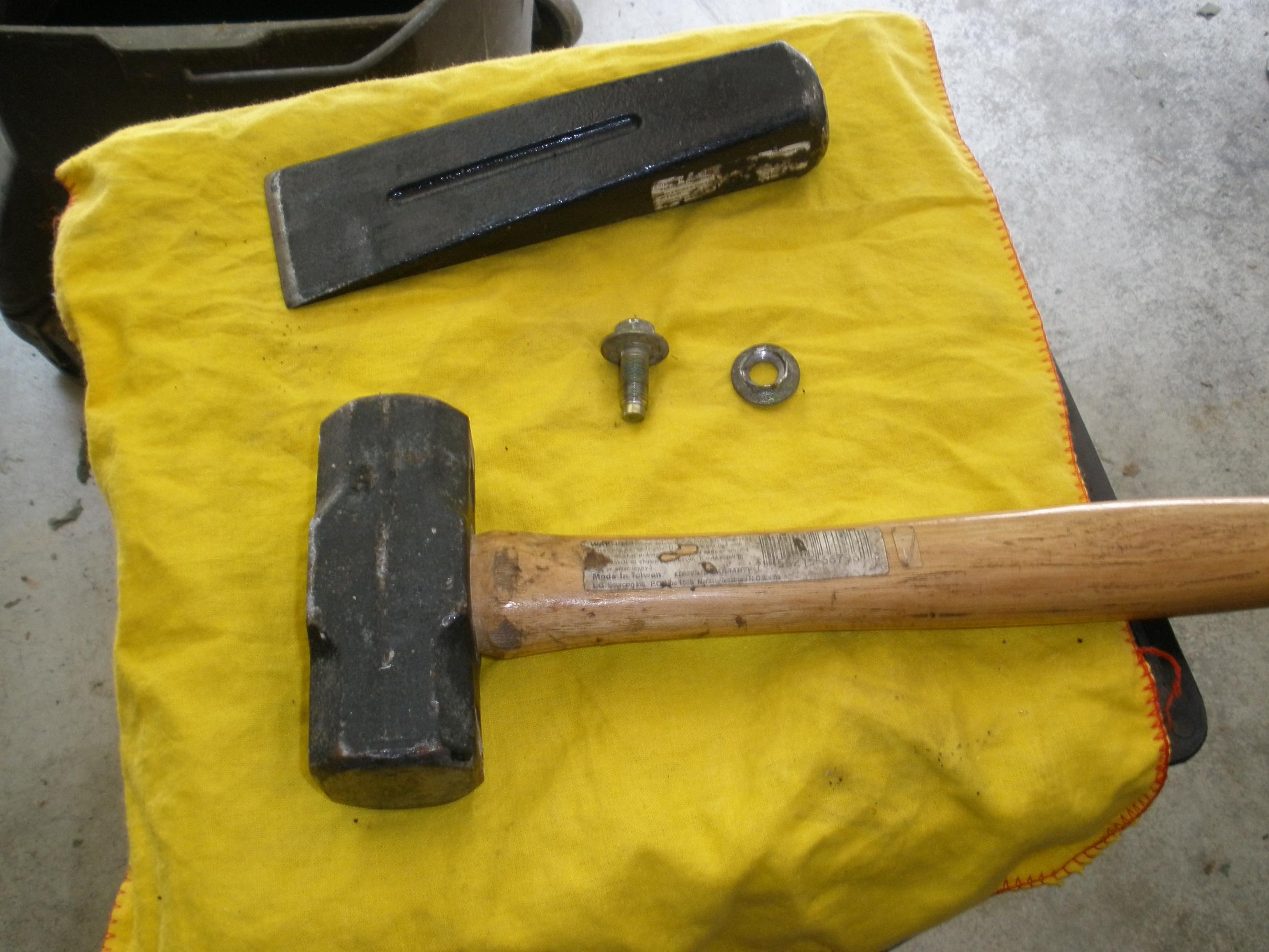

This is the bolt I had to diesel off and the tools it took to make it happen

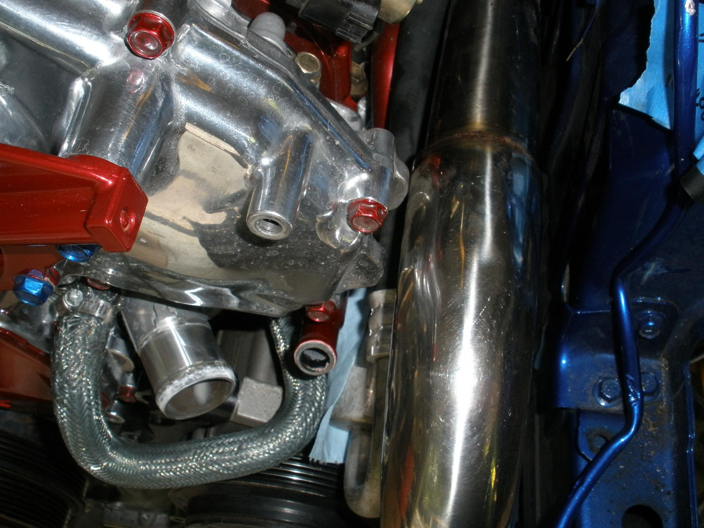

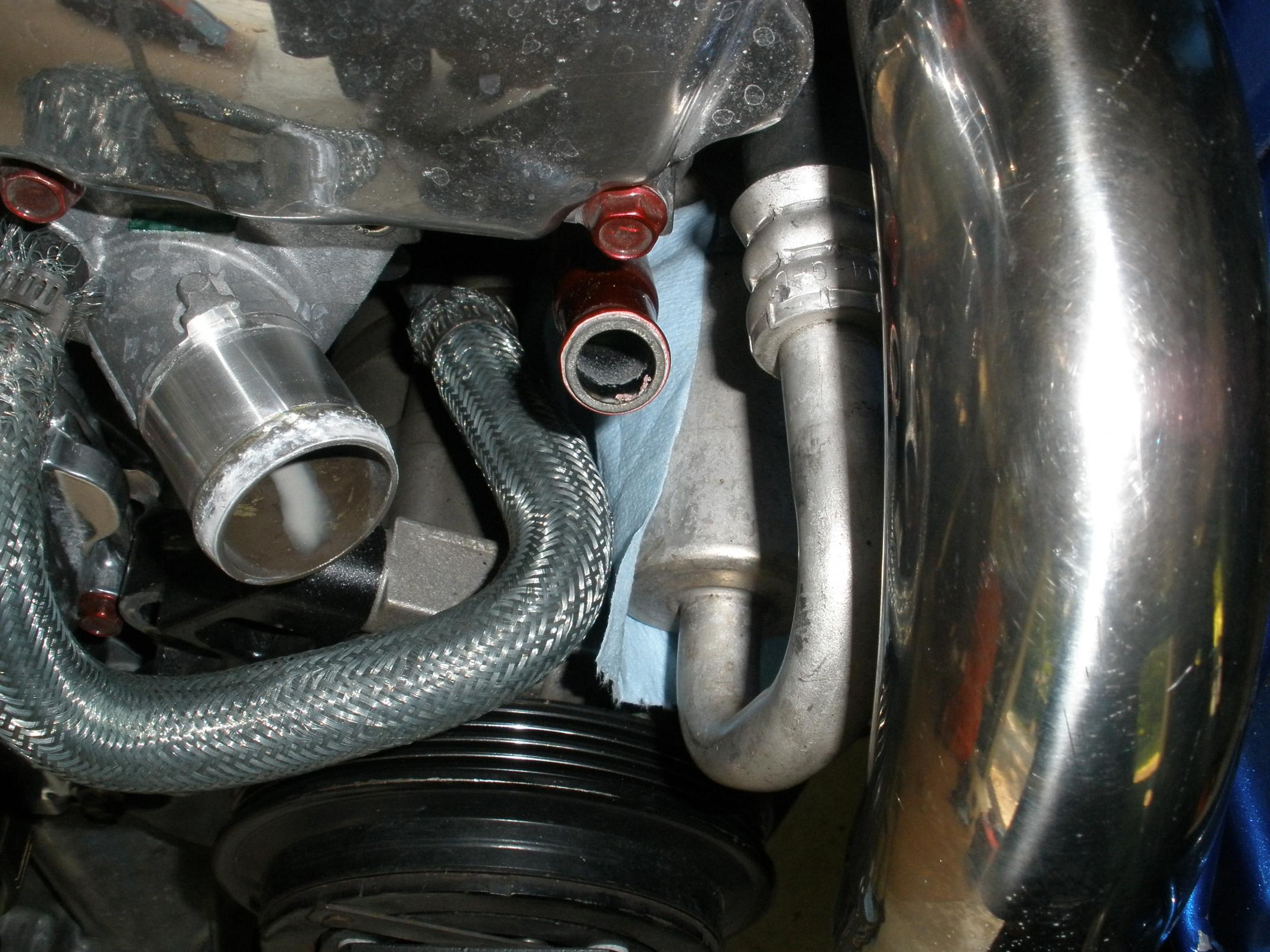

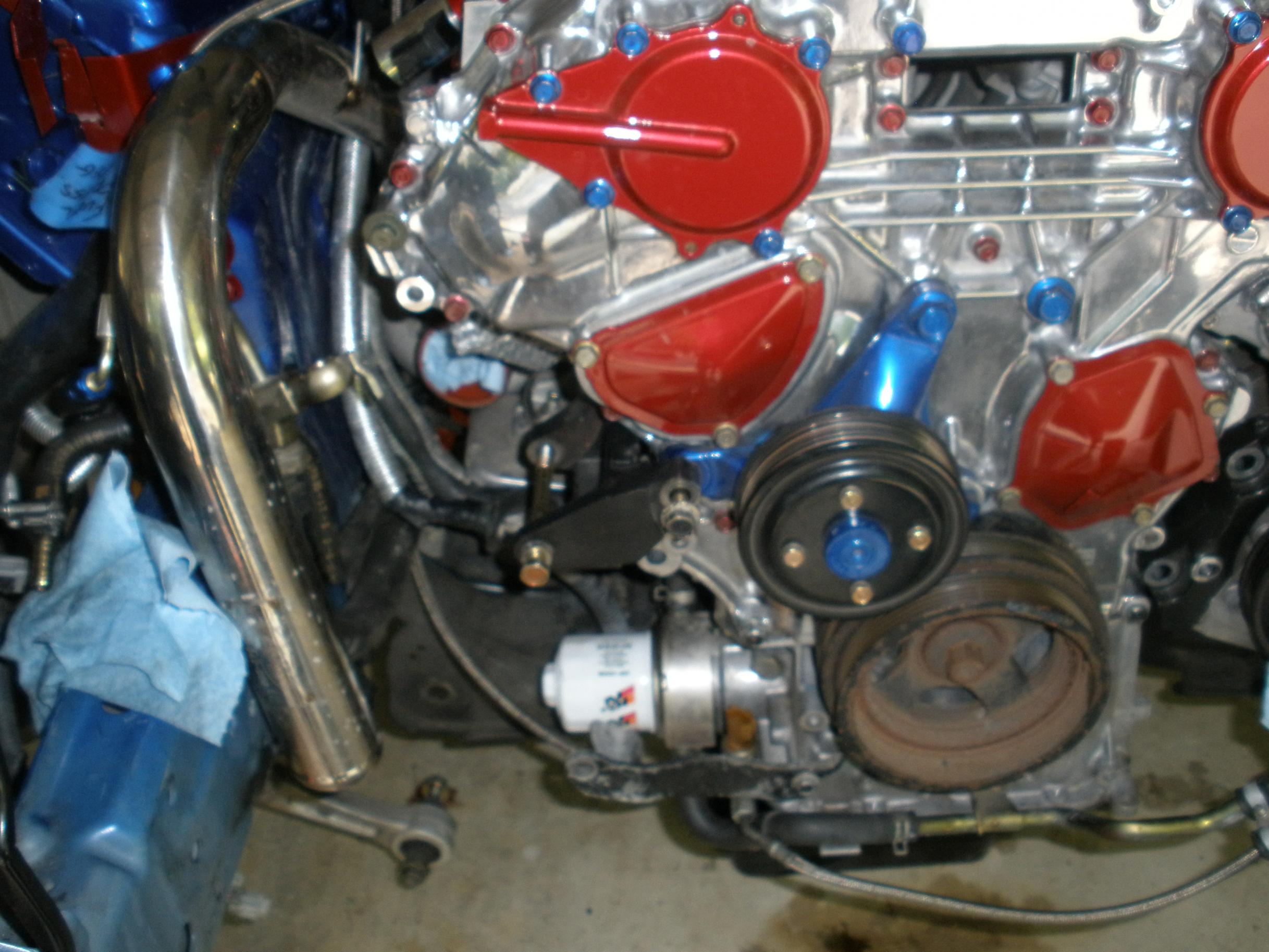

The hose with the cannister attached to it was routed through a coolant hard line and won't let the engine drop and pull out. In the second pic you can see the turbo pipe is so close the the timing covers that it wouldn't squeeze through. Problem was solved by using a tie-down to put pressure on the pipe, applying some lube to the pipe and covers and pulling the hose out and up through. DIY WIN

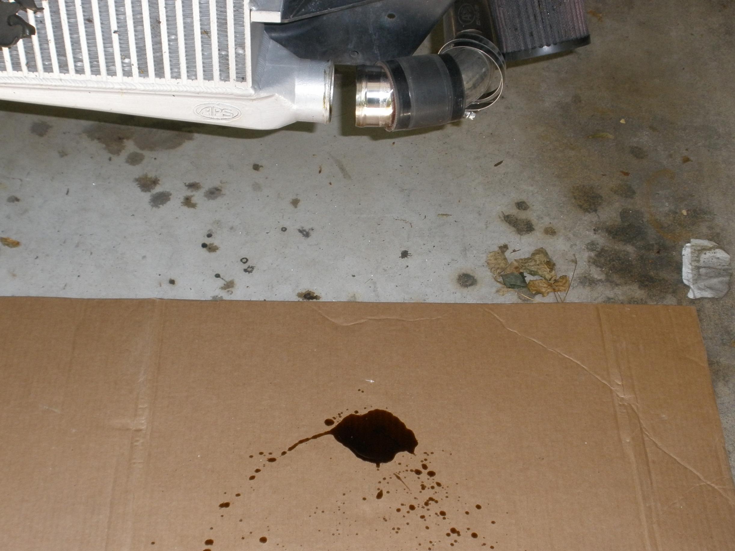

This is the oil that came out of the drivers side IC pipe connection. I was suprised by it, so I didn't have anything in place to catch it.

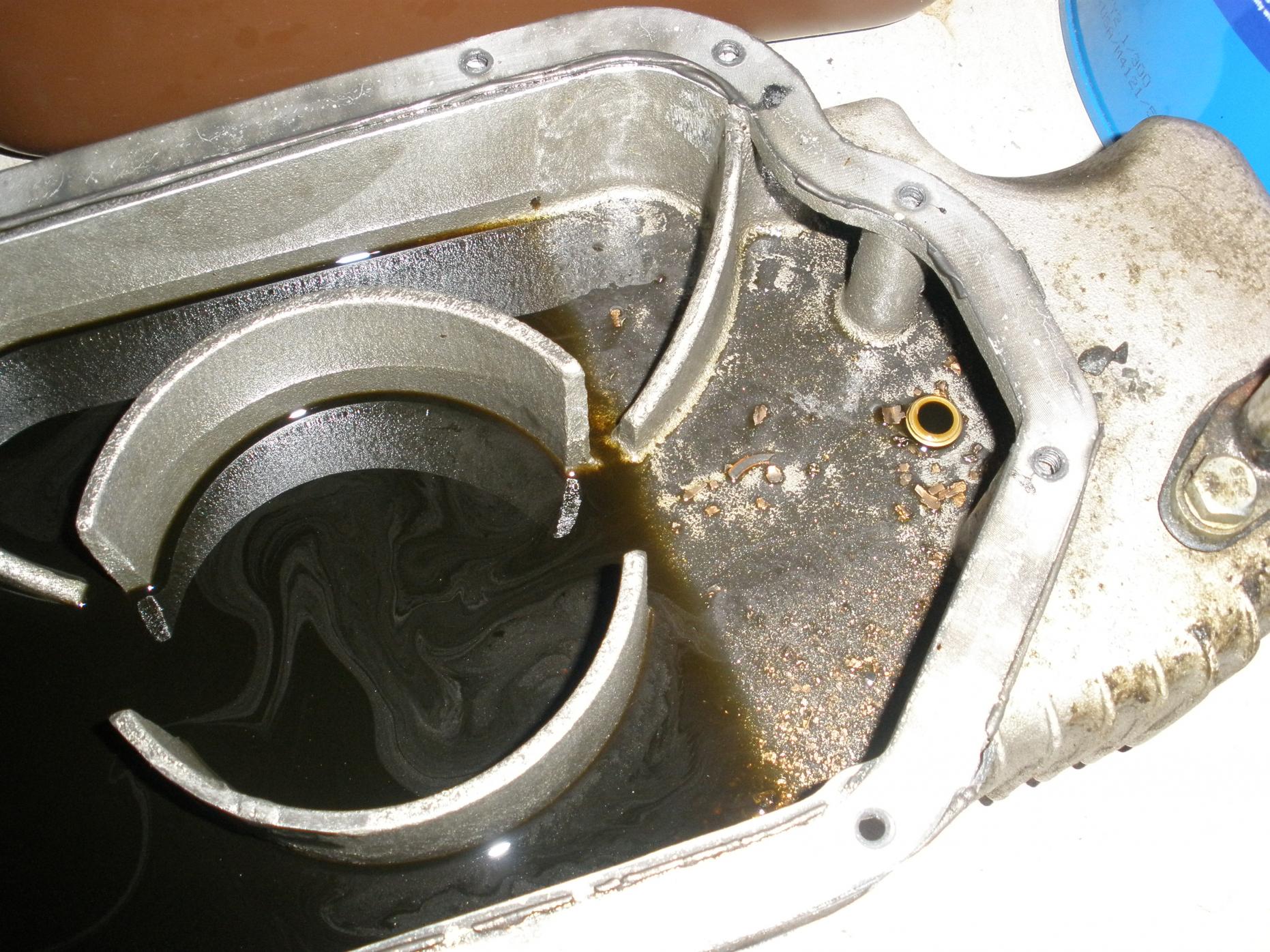

The money shot.... engine is F***ed for certain
Attachment 290938
Blame the machine shop for choosing the wrong size bearings. Either main crank bearings or connecting rod bearings.
Or
Blame who ever put the rotating assembly together for improper torque specs/sequence.
Or
Lack of a billet main girdle.
Really sorry to see that. I would be pissed. I would probably cry too.
