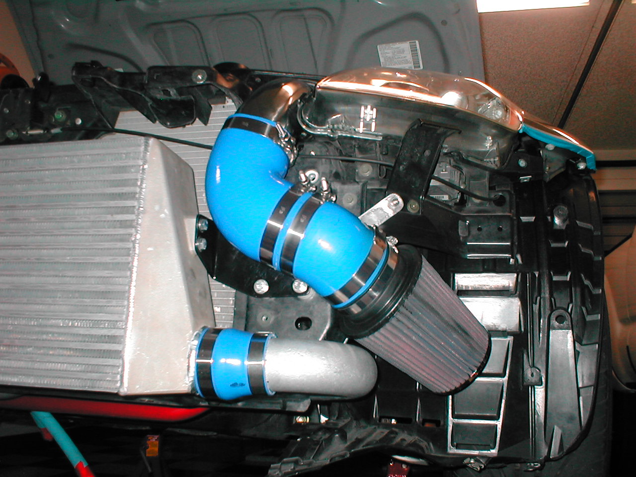

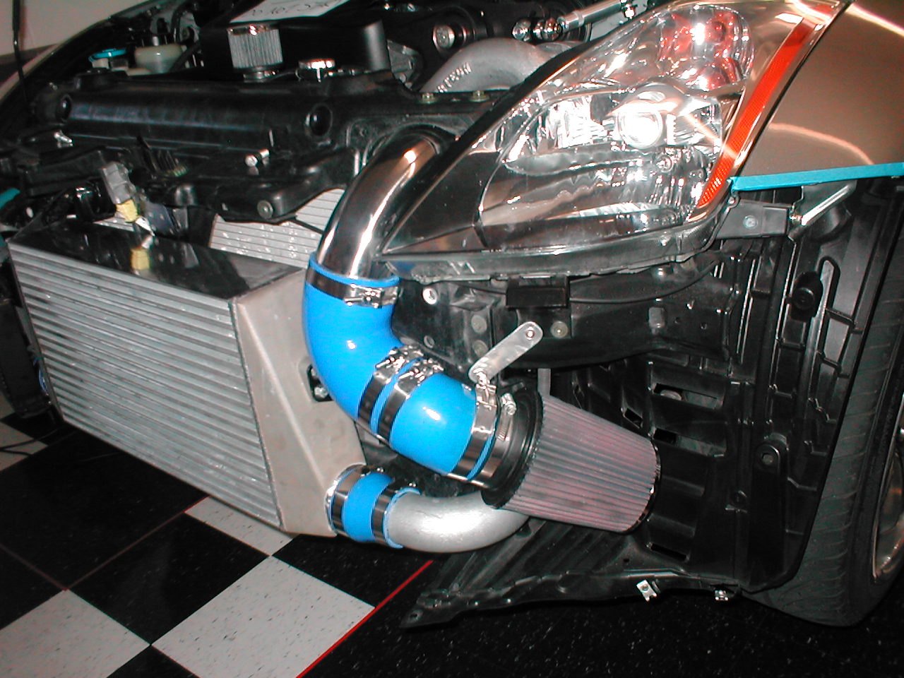

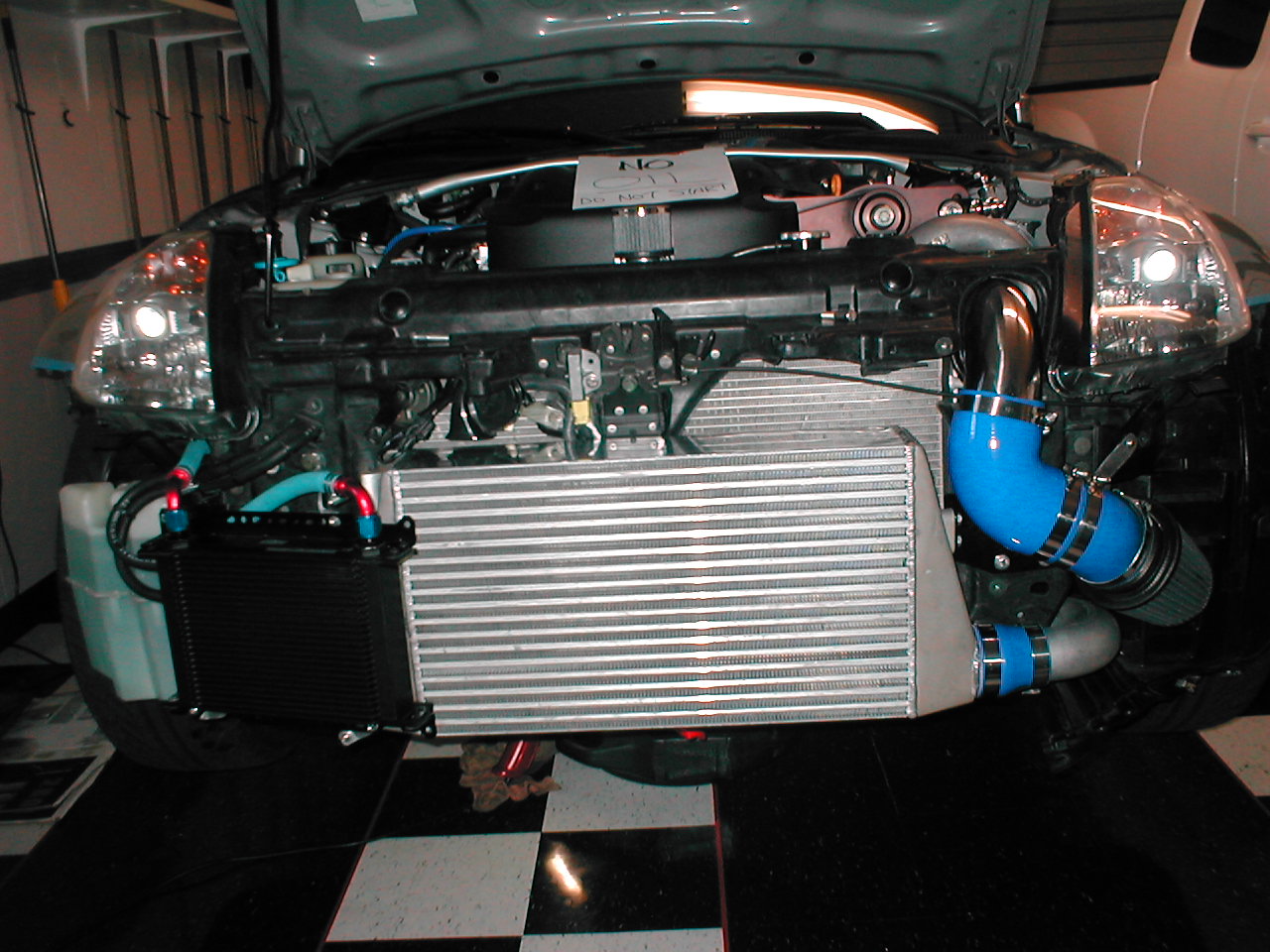

My street Intake with the Tr1245
Originally Posted by Colombo
I love my tr1245. But it's deff huge! No room for your blower intake if you run this intercooler. But aits looked great during tuning and jon did 20-30 pulls with no breaks. When I'm at the track even on 90+ degree days the intercooler when I get into the pits feels ice ice cold. It's pretty sweet. And the intercooler is also fairly priced
Attached Thumbnails Another built motor Vortech dreamer thread.-p1010002.jpg   Another built motor Vortech dreamer thread.-p1010004.jpg   Another built motor Vortech dreamer thread.-p1010015.jpg
