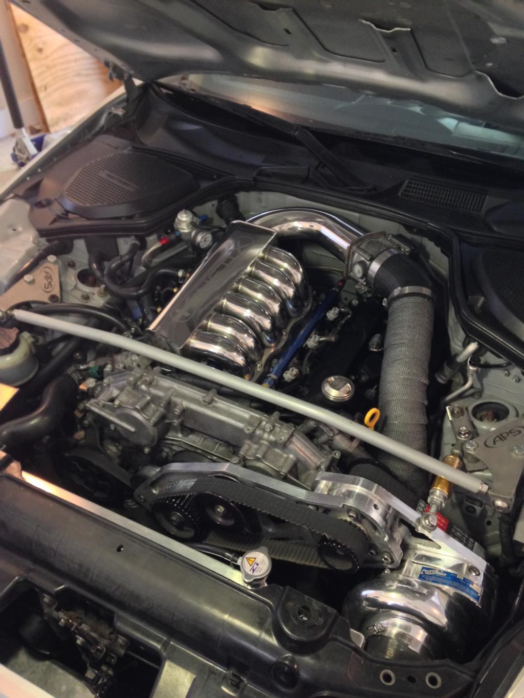

Stock pulleys on the accessories, z1 crank pulley. The cogs are just on the supercharger side of things.
Hey can you PM me where you got the material for your raidus rod?

Likes: 230
Conway you don't want that. it likes a shock. The Radius Rod needs to be a fixed length. Otherwise the bracket will Flex.
I tried it out, I can't even push it will all my strength enough to move it, I was moving the whole car. So I think it's solid enough to hold the bracket from flexing
Its a radius rod I allready checked it out to make sure.

You truely think your 1 man power is any comparison to 500HP? the motor Will make it move....
I done explaining this stuff to you guy for a while.
I have solid engine mounts the engine isn't moving. I'm saying without the brace you can grab the bracket and move it a 1/2" easily. With it on there I can shake and move the whole car just by the blower and the damper and bracket didn't move. We could argue what you think all day but in the end I have it on my car and this is first hand experience and you don't have it so that pretty much settles it. Thanks though

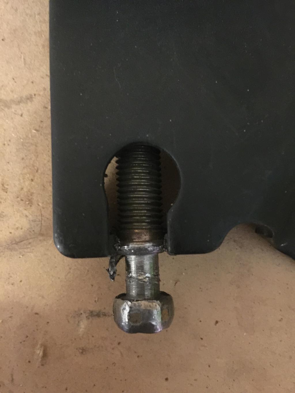

Maxed out my tensioner trying to go tighter... Good things hoard parts cause i had a spare..
I've had a similar issue.

Time for a smaller belt?
