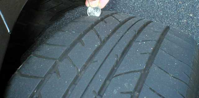

Attached Thumbnails Tire FEATHERING: FYI-postswapwear.jpg
