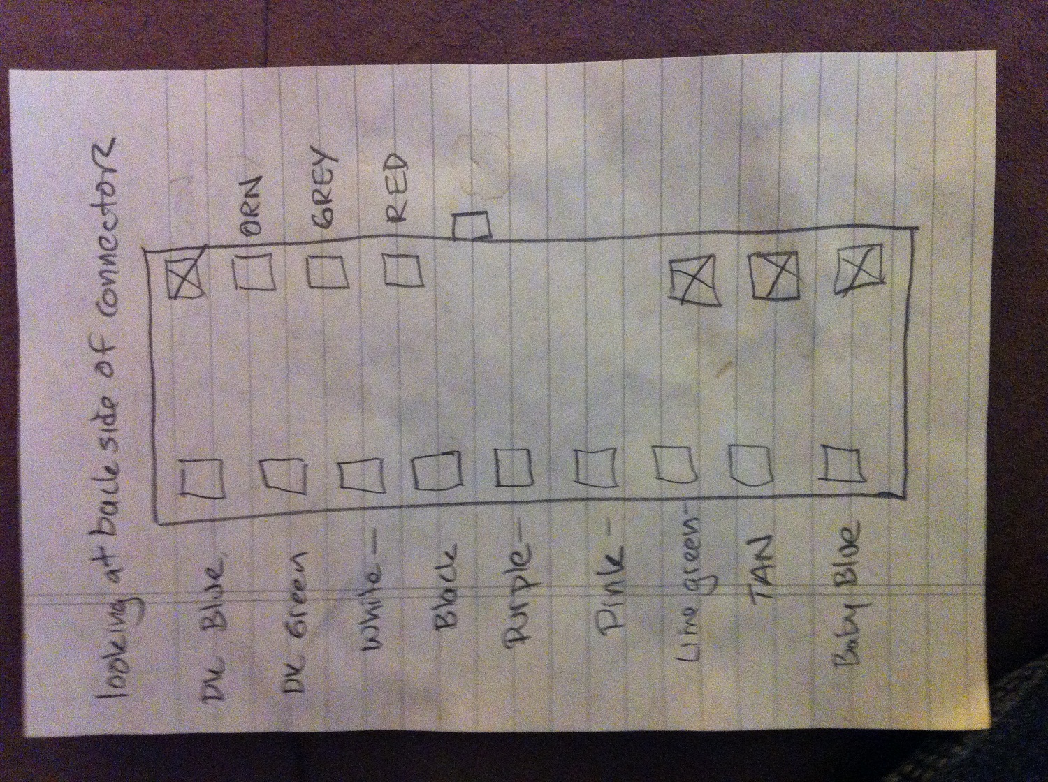

The car is an 03 Z & the passenger side window is inop. The window is sitting about 1/2-3/4 inch down & doesn't respond to hitting the door. Now, I've gotten a factory schematic & ck'd all the inputs & outputs, grounds, etc to the passenger side switch. The only thing I haven't look at is the digital signal (power window serial link) from the body control module to the passenger side window switch. I've swapped out the switch w/a good used one & same with the motor, still no operation. Can a grounded serial data link cause the window to not operate? I haven't whipped out my lab scope yet to ck to see if there is digital talk on the line, but I'm starting to think this might be an issue seeing how in the factory schematic shows a digital line out on pin 16 to the switch, then from the switch out on pin 12 to the "encoder" on the motor . I don't have a Consult, otherwise I would have scanned the body control module by now. Any insight into how the system works would be greatly appreciated. Thanks in advance.

When replacing my motor I pulled all of the wires out of that white sub switch on the passenger side. My question is, while someone is replacing the motor do you think you could write me up a dummy schematic and tell me what colors go into what recepticle/hole? Ex/ starting from top left hole one receives white, and hole two recieves brown etc.. I would much appreciate it.

Here's a schematic I drew. Just waiting for the pics to upload from my iphone of what it looks like all wired in. The little square at the top of the connector is the locking tab & its a view from the backside of the connector. Good luck.
