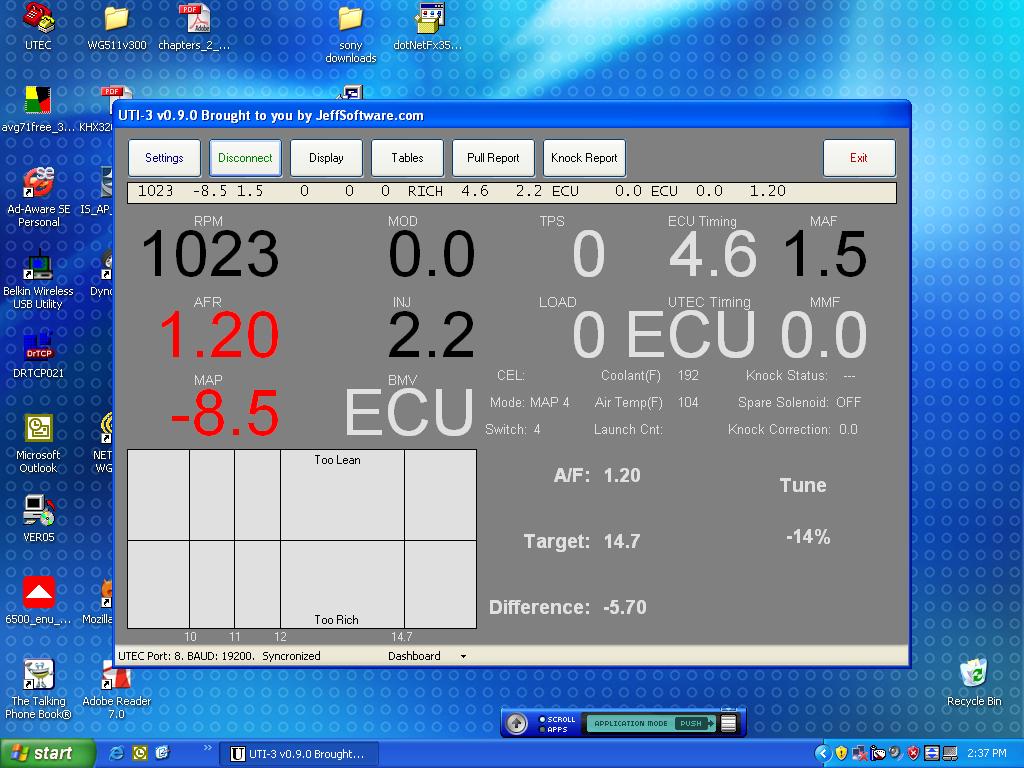

Jeff (the UTI developer) is going to be working with me to get the RPM issue with UTI3 resolved. I need to send him some logs and screenshots, and he'll work his magic!

I just sent pics and logs to Jeff to get the bugs norked out of the new UTI3 software. An interesting thing though, I was using my older XP laptop today on my car and noticed that my RPMs reported just perfectly in "dashboard" mode. My AFR, on the other hand, was all f'ed up! it was reporting values of 1.xx-5.xx. it said my AFR at idle was 1.20. when I switched it back into "logger 1" mode, my AFRs went back to normal. Nothing was wrong with my car.......the values were just getting reported wrong to the UTI3.
Attached Thumbnails UTEC 'Upgrade?'-utiscreenshot.jpg   UTEC 'Upgrade?'-utiscreenshot2.jpg
