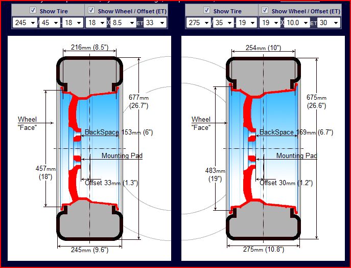

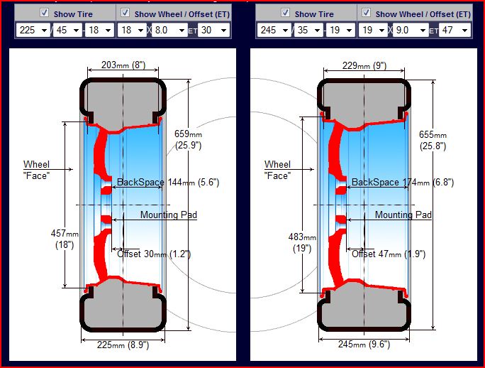

Default 370z rays on a 2007 350z
I bought a set of 19" Rays that came off a 370z and according to the info I got of h__p://wheelsmaster.com; I should be all set with a 20mm spacer in the front(245/35/19) and don't need any in the back (w 275/35/19).
Can anyone confirm this ?
PS: stock suspension with Brembo
