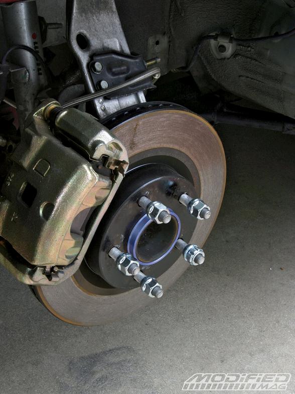

Okay, here is the answer.
10mm "IS" too narrow/thin, its just that the hub of the Z ALREADY has a lip on it. that lip is the 66.1mm that is where you mount the spacer onto the Z hub.
SEE HERE - This is the front hub of a Z, notice the hub ring in purple that is mounted onto the existing Z hub "LIP":
That lip (though i haven't measured it's protrusion) is what keeps a thin 10mm spacer from allowing a "slip on" hub centric ring.
This is the slip on style - obviously wont work!
You need this type (permanent "wheel" centric ring) - in a 10mm thick spacer:
Now, any spacer you find thats meant for the Z will have the 66.1 center hole, SO you just need the permanent "wheel" centric ring to be the 73mm or WHATEVER your wheel bore is?
What is your wheel bore????
To know what ring size you need to mount the wheel to the spacer!
and,
if you find 66.1mm hole/10mm thick spacers with the permanent lip of 73mm, but find that your wheels are 88mm or something else, then you need to get slip on "rings" for your spacer like the purple ring shown on the first pic.
-J

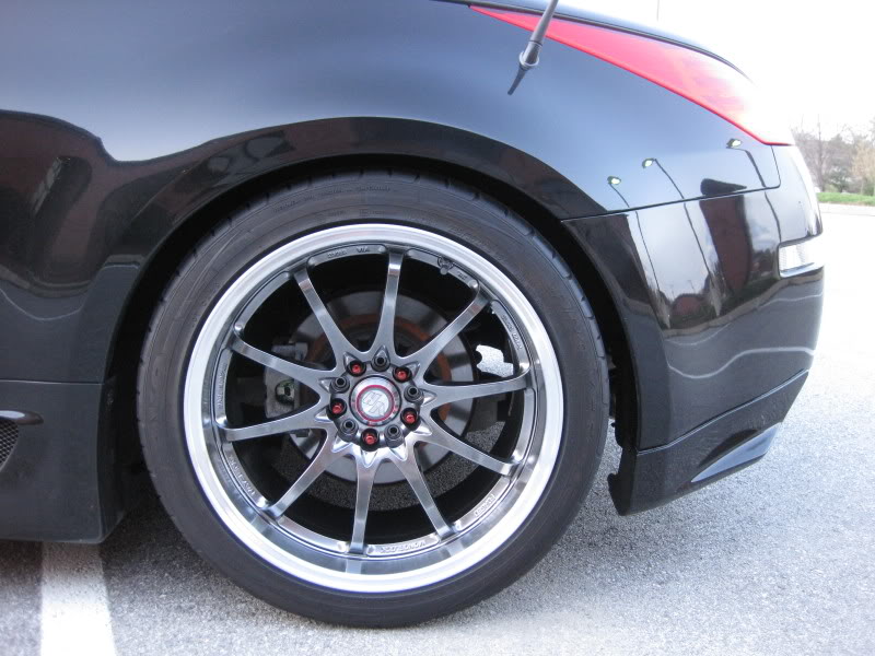

I'll post here before starting a new thread:
I have Volk CE28n wheels with +22 offset all around and I want to add 10mm spacers to achieve +12 offset. I bought a set of KICS Project 10mm spacers w/ built-in studs and tried to install them. The OEM studs protrude through the spacer because it is only 10mm thick. The machined-out "pockets" in the back of the wheel are not deep enough to accommodate the protruding portion of the OEM studs so the wheel bottoms out on the studs.
Also, there is a second set of holes in the CE28n wheel, but the holes are too small in diameter to allow the OEM 12mm bolts to pass through. (See picture below showing the second hole pattern). Going with a 20mm spacer to encompass the OEM studs is not an option because the wheels are already +22 offset with 285/35/19 rubber and in OEM camber limits, so a +2 offset won't work without major modification (nor will it look right on my car in my opinion).
So before I jump to the conclusion that my only option is to replace the OEM studs with longer studs (e.g. Nismo), is there any other work-around for this?
1. Source shorter studs - by how much does it hit???? how much shorter do you need??? - NAPA does have some. best to first have them pull up an oem replacement, which it itself is shorter by a few millimeters, and then have them look in back for an even shorter one.
look at how many threads stick out past the lug nut holding the spacer onto the z hub............you don't need all those threads past the nut to have the torque based net affected area.
* keep at least 1.5 thread protrusion from the mounting lug nut! as in the lug nut that mounts the spacer to the Z hub.
((* source - multiple Aersopace design manuals on bolt thread engagement.)) 12mmx1.25 stud, thus results in 1.5 threads = 15% net of the diameter since 1.25/12 = 10.4% so 1.5 =~ 15 percent.
all aerospace fasteners - lengths are called out!
2. Cut the oem studs down shorter - see my POST #9 and scroll down to 10 which shows how to replace them, if you decide to replace studs.
OR you can cut spares you bought at napa, with a spare lug nut ensure you did a clean job on the threads then go install them KNOWING they are good...
3. Machine (machine shop or drill at a low speed) the spare holes in the volks bigger? by how much is needed? a few millimeters bigger hole??? the oem studs should be centered on those spare holes........so if you measured the holes compare to 12mmm as the oem stud is an M12x1.25
* Infinity to a hole is 3D (3 times its diameter) so measure and decide if making the holes bigger is an option for you.
I doubt you will, as options 1 and 2 are better...
&&& note: this is based off a machined wheel, not a cast wheel, i cant tell from the pic, but it looks to be a machined wheel face at the mount hole location.

Do the same thing with the wheel.......center it by hand tightening each lug nut on the wheel.........its not hard!
Originally Posted by sry110
The problem is that the portion of the hub center that protrudes through the spacer is not long enough to reach into the hub ring in the wheel to center it. (The back side of the hub ring has a chamfer cut into it which reduces its useful engagement length). So even if I could get the wheel to sit flat onto the spacer, I have no way of centering it. Do I just need different hub rings that don't have the chamfer on the back end? Any tips? Thanks...
I am familiar with the chamfer you are talking about on the wheels...
you can always buy hub rings and have a local machine shop turn them down on a lathe to fit your needs.
I have actually done this once!! then again, i have had access to aerospace machine shops.......
-J

Thank you for your thorough reply. I took some pictures of the spacer mounted to the hub but they are on the camera at home - will post ASAP.
Out of the options you mentioned I think replacing the studs with longer ones is the best option, then going with non-studded spacers. I like this option because a) I would rather replace the OEM studs instead of cutting them, and b) it only requires one bolted connection to be torqued properly, as opposed to the studded spacer which requires the spacer nuts to be torqued, and then the wheel lug nuts also to be torqued. (If the spacer lug nuts work themselves loose, you woudn't know it because they are captured under the wheel!)
I also considered opening up the holes in the wheel but then I thought "hmmmm, risk ruining a perfectly nice set of $3000 wheels so I can push them out 10mm and look "cooler"? Don't think so!"
Another advantage of just installing longer studs and using studless spacers is that there will be only 5 studs to deal with, whereas protruding a second set of bare studs through the wheel wouldn't look as clean.
Regarding the wheel centering issue, I've always been on the fence about whether it is acceptable to center the wheel using the lug nuts. I understand the theory behind it, but having the added security of centering it on the hub makes me feel warm and fuzzy. Although I guess if I center using the lug nuts and I get no appreciable vibration, I should be in good shape! It's not like my hub rings, which are plastic, are bearing any of the load anyway.
